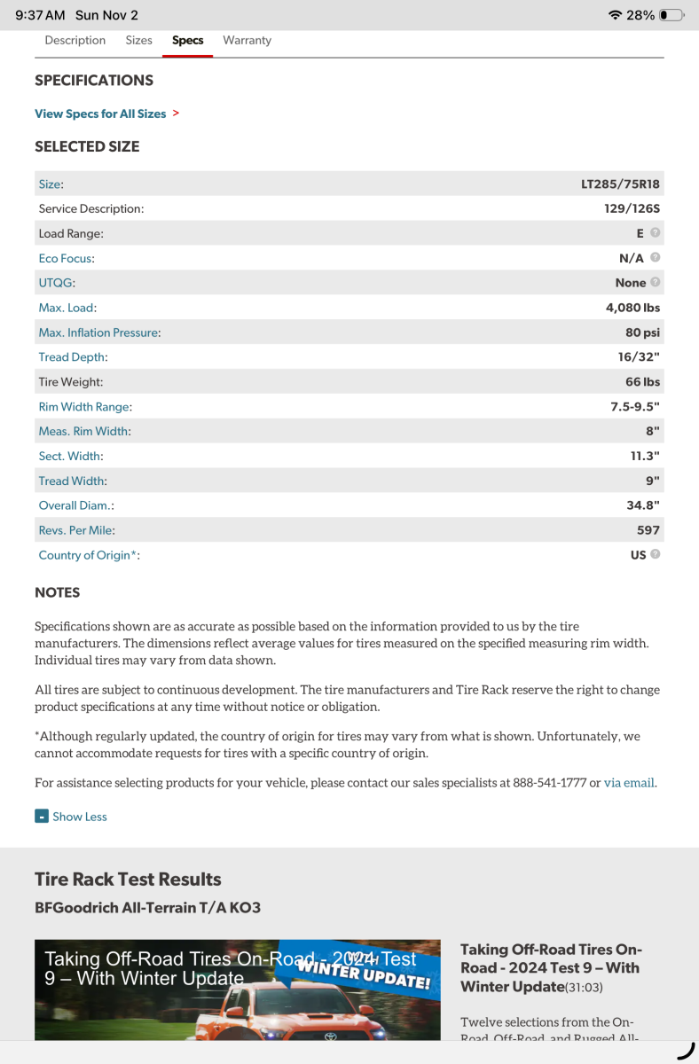

Can I use 285/75/18 KO3’s without modifying? What about the spare? Thank you

So, maybe.. you can squeeze your 285/75/18 of choice up there uninflated, without any real issue re-inflating by yourself if ever required. I think someone else on this forum has stated that. The KO3 you mention is stated as a 34.8” diameter.
