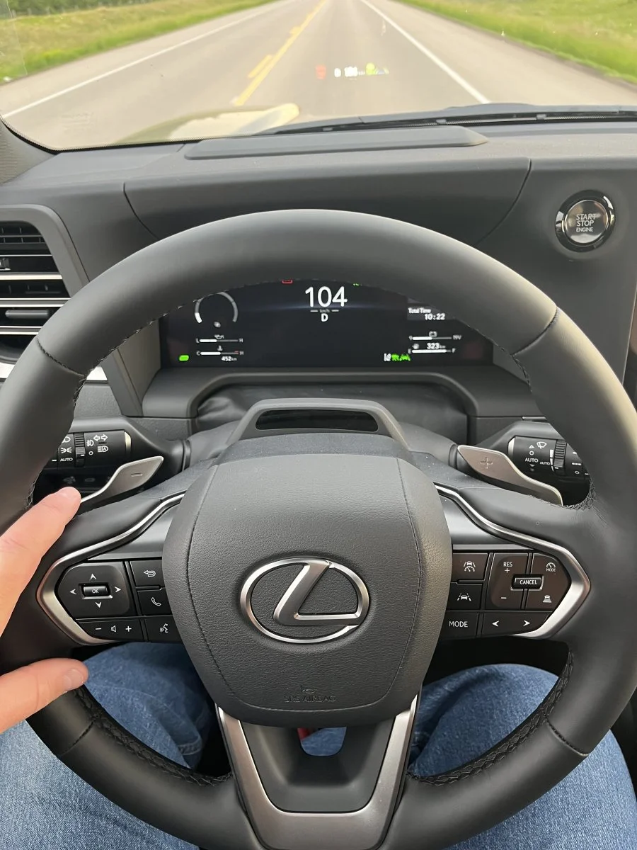

I have a stock 2025 OT+ with about 2000km and from new when on the highway in the right lane I need to hold the steering wheel to the left to keep it straight. When in the left lane the wheel is more centered. I have read that this is a function of the suspension which is sensitive to the road crown. I wouldn’t say it pulls to the right, but when the wheel is straight driving highway speed you will be in the ditch within a couple hundred meters. Thoughts?
I had the dealer check the alignment, and they said it was out and adjusted it, but it does not seem to make a difference. It is not out by much but I attached a photo for reference.

I think that all cars have a slight off center wheel... and if it's dead center, it's only a matter of time before it's tweaked and will be off. My OCD has a VERY hard time when I think about it....but the "off" is so very slight.

After 3 attempts the dealer was able to get the alignment about 99% right. It does seem to be more dependent on the road than I am used to. They acknowledged there was a problem and were awesome to deal with. I still struggle with the auto lane correction. Seems to ride the center line more than I like. They did calibrate it again and it improved but is still a bit more aggressive than I like.

I did my second alignment two weeks ago and it’s definitely gotten better for now but my steering wheel is still off center and the dealer told me that’s normal in GXs but I don’t buy it.
