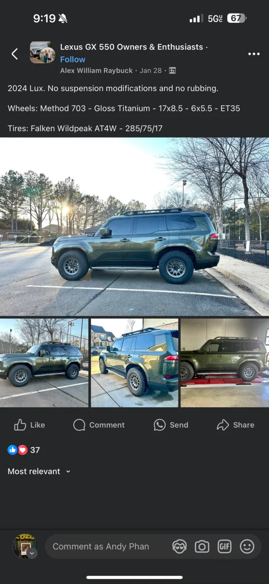

this is not my car but someone has posted on FB forum that they didn’t have any issues with this setup
