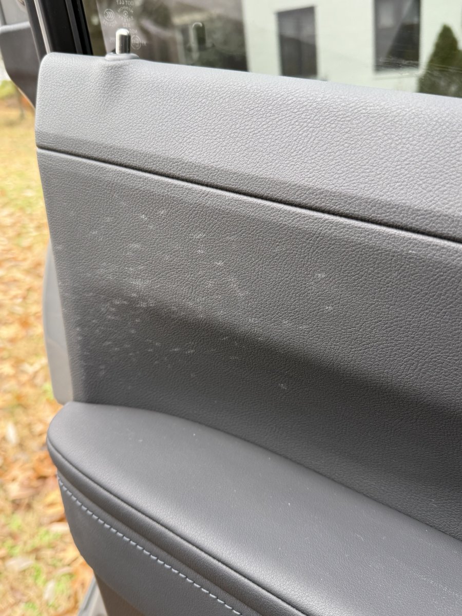

Any idea what could have caused this? Driver’s side door interior

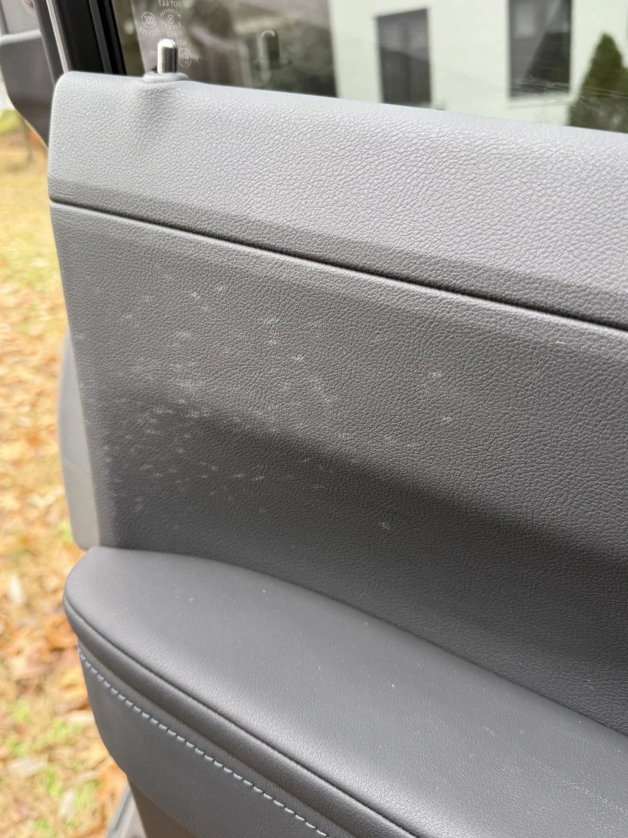

Honestly don’t know exactly when it happened, I’m at 5k miles today. I’ve tried several different cleaning items and the white specs have not come out yet.
I don’t drink anything but water in my car. Car has only been out of my possession twice for ceramic coat and then windows tinting.
Could this be defect and if not what could be the cause?

My theory is it’s the seatbelt metal knocking against the door when the seatbelt is unbuckled and withdraws, lightly scraping it.
I have one spot like that on my drivers side door. Was there when I took delivery.
Oh wow. I hadn't thought of that but you may be on to something. I will test. Wild that it would damage so easily from seat belt if true.

I have this exact same issue. The dealer is replacing the panel under warranty. I will take a picture of mine if that is helpful. They balked at first and said it was the seat belt hitting it, but the manager agreed it wasn’t
Good to know. If it isn't the seat belt what is it?

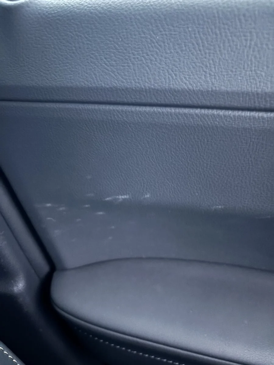

100% it is the seatbelts. I noticed this first week i owned it, when i would unbuckle and let go of it, it would go flying back at the door, hit it, and leave those marks. How they didn’t note that in testing phase is crazy
If you unbuckle and guide buckle back to door so it doesn’t bang on door, no more marks. Its an unconscious movement now to do that to save the door panel, but bs that i have to do it period

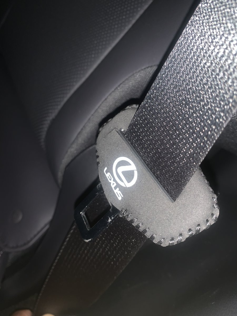

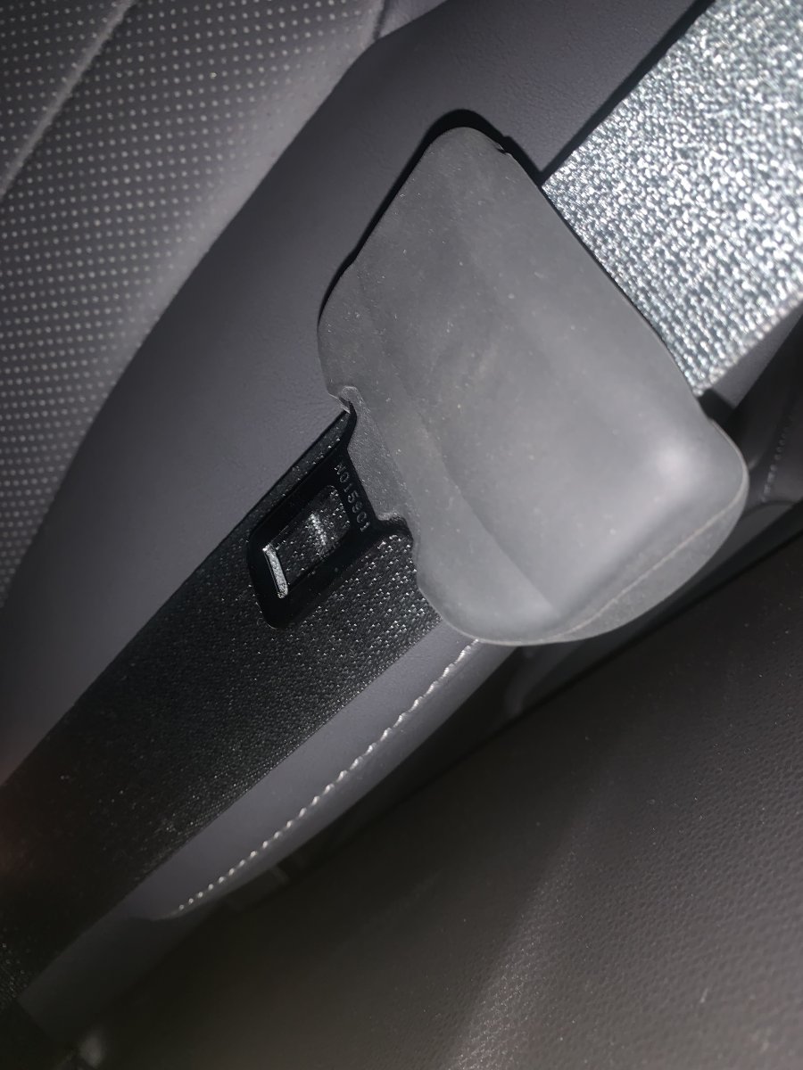

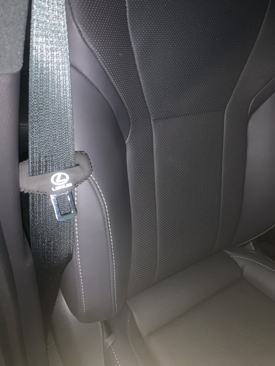

Here is a much better solution. No need for the panel protectors. I bought these buckle covers online, no more scuffs!
1st picture: The drivers buckle is oversized so the cover was spec’d for a Tesla. It’s a rubberized coating.
The 3 others are soft felt velvet texture over the smaller buckle. I used to cringe every time my wife would let the seatbelt buckle slam into the door. Glad I found these…
