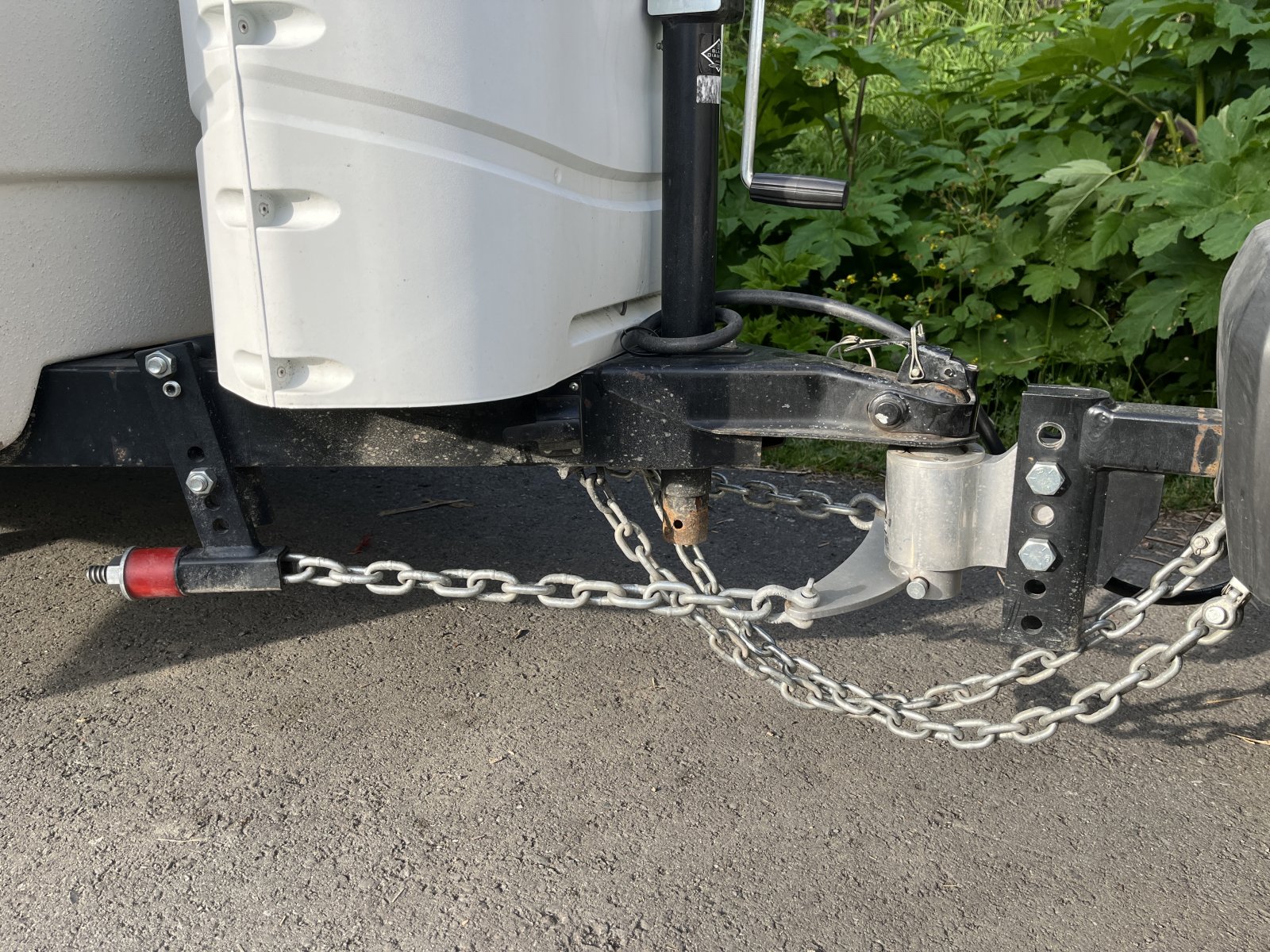

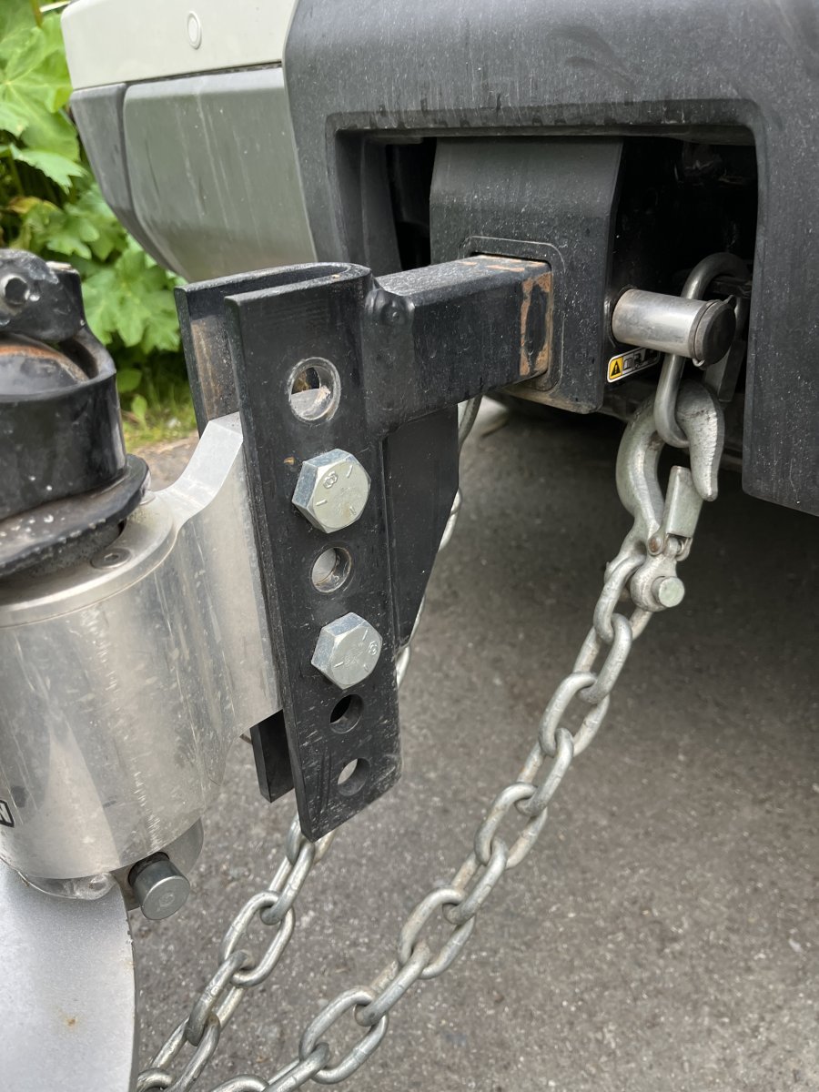

My Anderson hitch is working really well in the Lexus receiver and not needing any anti-rattle. Towed my Escape 19 from Vancouver and spending tomorrow night in Skagway Alaska.
How is towing the Escape? How is gas mileage and range? I just got a 2025 Overtrail and am picking up a new to me 2020 21C in Washington State. Will be camping for 3 weeks bringing it home to Colorado. Any advice on hitches, etc. is MOST appreciated.
The GX is pretty solid and no issues in regard to towing, effortless. I have added some mirror extensions and some safety chain hook carabiner clips. Very happy with Anderson WD hitch especially after using the big bar types. Also much quieter Easily fits in front storage box and is secure when unhitched. The position of the GX's 7 pin connector socket is a pain as is the fact it disables all cruse controls. You'll be loving your Escape..
