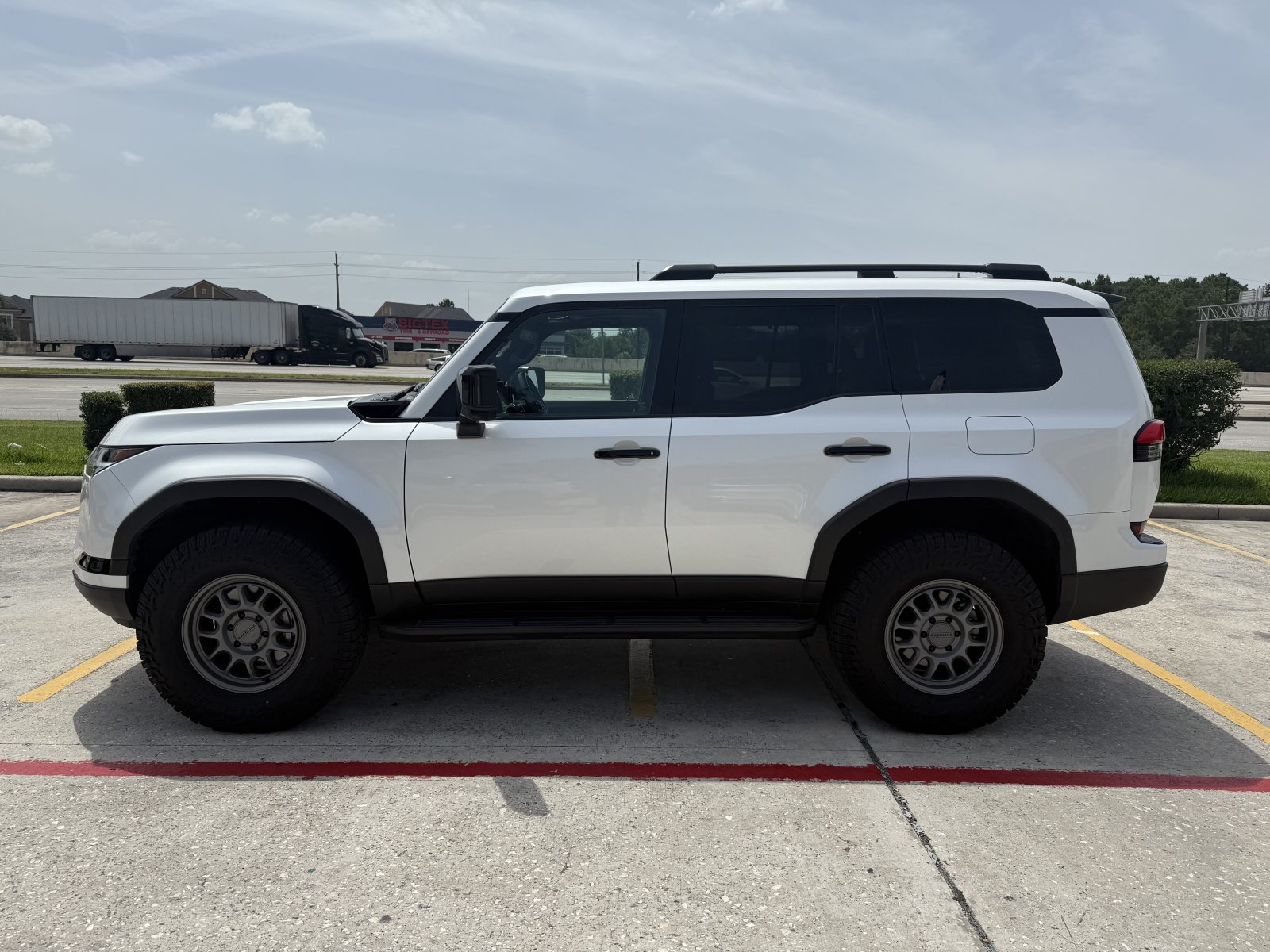

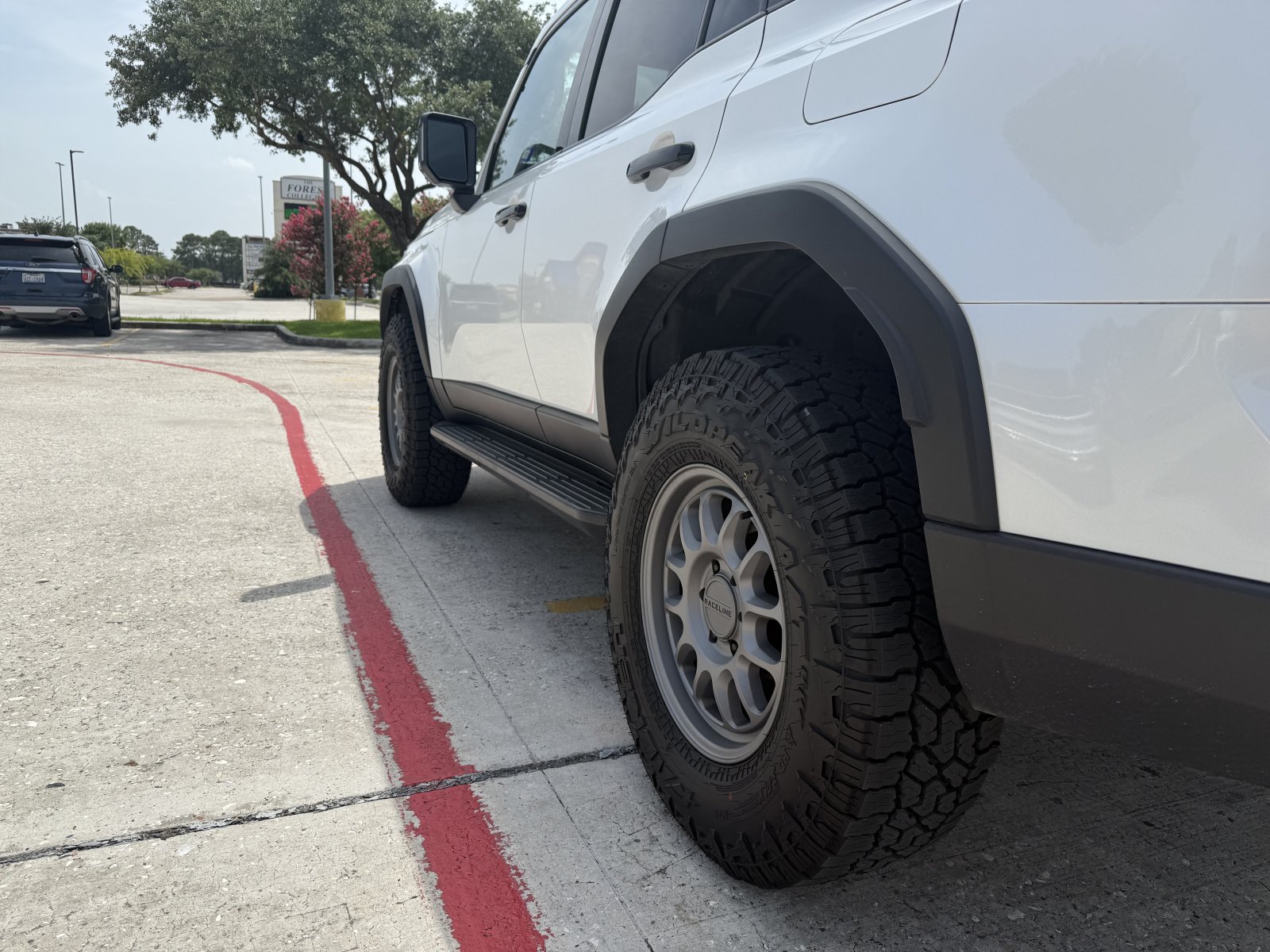

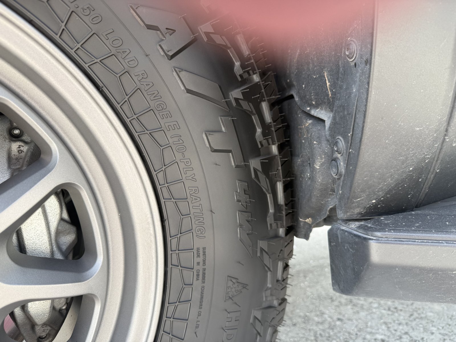

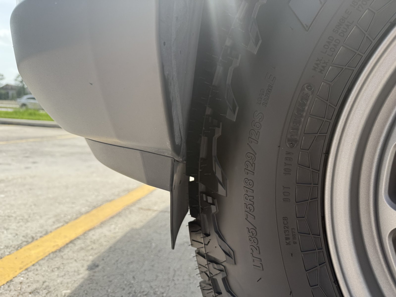

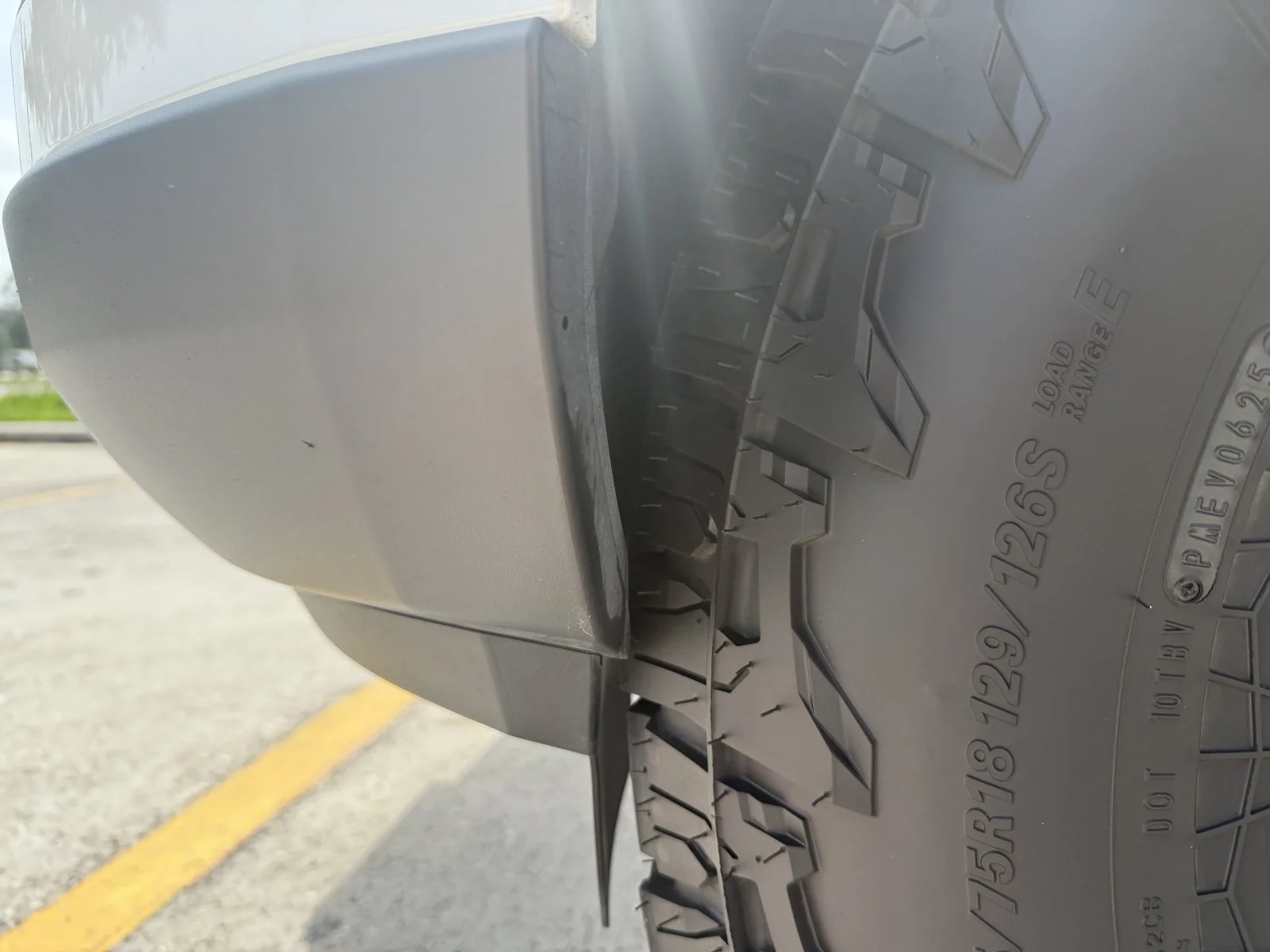

Raceline 958T Rogue 18" wheels (+35mm offset) and Falken WildPeak A/T4W 285/75R18 with Westcott lift kit. There is the slightest bit of rub for front tires against the front of the wheel well (almost touches in the back of front wheel well). I think tire wear would eventually eliminate this rub. I have ordered Dissent Offroad bumper and I assume that will eliminate this. Also, note that spare tire did not fit under vehicle. Have ordered Dissent rear bumper also with spare tire carrier for that.
