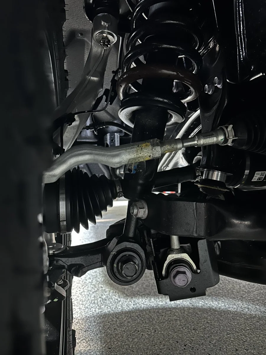

I am planning on properly lifting mine also 2'' max. I currently have a 2.5'' spacer lift. Where my angles are sitting now, I would put on the diff drop.

Great share. Definitely agree with you on a diff drop if those are the angles. Wonder if a 1" front level avoid the headache of the EKDSS as well. Might be the move with this platform.

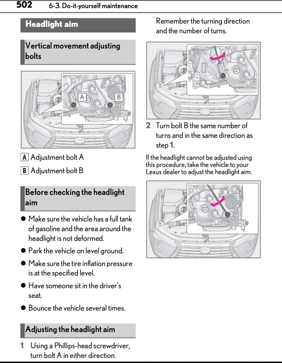

You need a 15” #2 screwdriver to lower the headlights. I found it easier to put 2 dots on the adjuster and housing to count rotations. 44” at 20ft works good without blinding people.
Thanks, I have not yet tried to adjust my headlights but yep gotta do it after pretty much any lift. Did not realize I’d need a screwdriver that long. This is why I love the forums!
Could anyone explain how to lower the headlights on GTX550 when we lift the front???
screwdriver - pop hood, look at headlights
edit: actually it's easier to access the little gray bolt (8mm) behind the headlights in about the middle of the headlights.
It's on page 502 of the manual. there are 2 adjustments for each light. I set mine to 44" at 20 ft.
By the way, Robkelhare, how much turn (rotation) did you do to adjust this height? I am sorry to keep bothering, but when I did it there was not much change I could make by turning a bit.
Sorry!! I did not mean to highjack your thread...!
(I posted the same question in another thread.)
All good!
