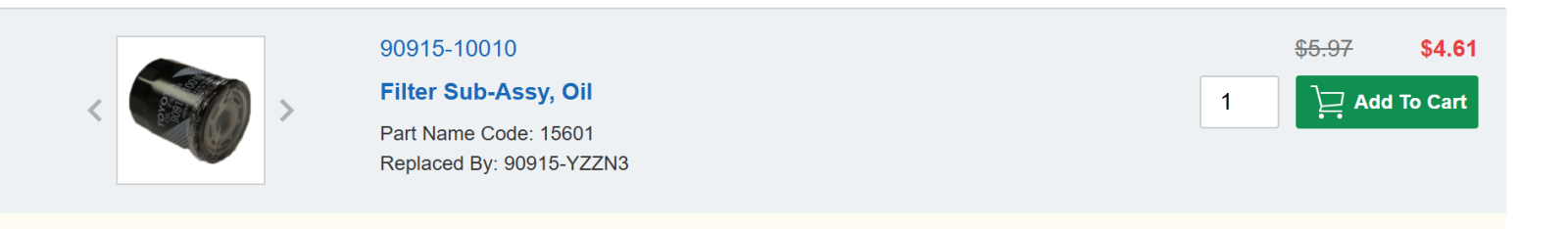

I had previously ordered some of the thailand filters (90915-YZZN3) but went to get the other japan filters (90195-10010) and was told by the toyota dealer parts guy that they are no longer able to order the japan filters ending in 10010 - if they do they receive the YZZN3 filter.
Just wanted to see if other people are being told the same thing, or have ordered the 10010 filter and received the YZZN3 one.
Just a note from my experience at the dealer today.
a couple months ago I ordered several of the #-10010 filters from Lexuspartsnow.com and got them, but last week when I ordered more to stock up their website only has the #-YZZN3 filters as an order option.
I ordered mine thru Landbully.
Yes, Land Bully has the 90195-10010 filter. I bought a bunch as the price was right, but I'd wager there is really no difference between the Thailand and Japan filters. I have both and while I have not cut into them to inspect (I'm not that insane, yet), they appear to be same same.
