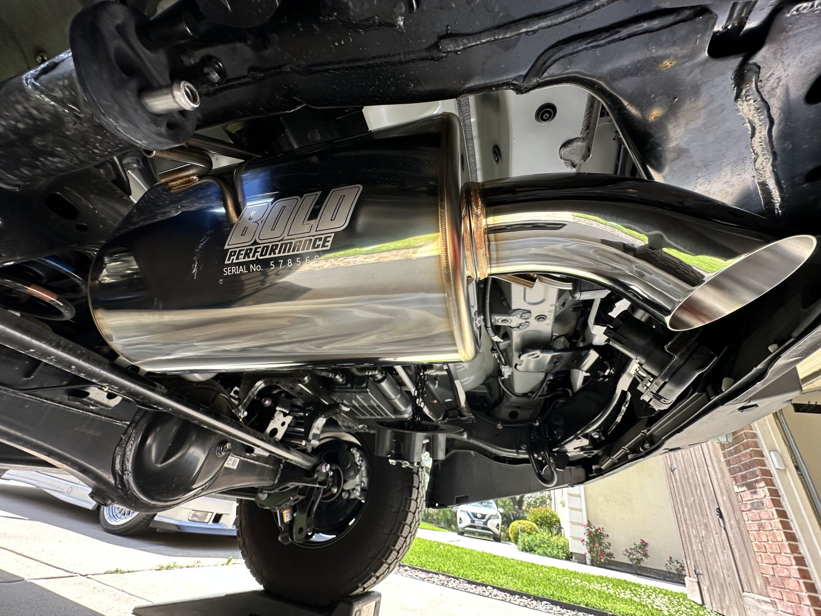

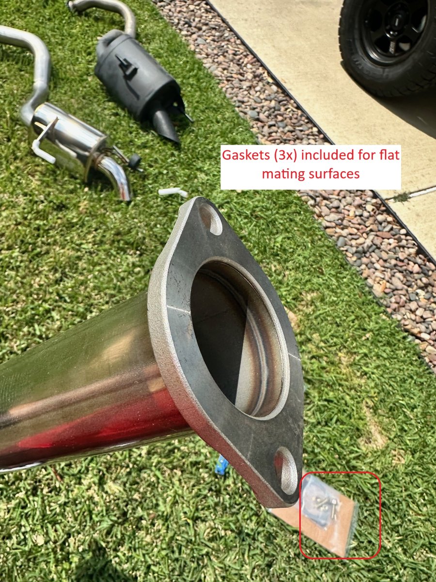

When I noticed Remark made a "Quiet" exhaust, I jumped on it. I reached out to Remark and completed my purchase on a Friday and the Exhaust was delivered on Sunday. To my pleasant surprise, it was free shipping and the exhaust arrived in a nice, sturdy box. Checked out everything and all necessary bolts and gaskets are included (welds look incredible!).
My overall impression is that it's perfect for me. It gives a nice little rumble but it's not loud enough to make it feel like a "non-Lexus". In regards to drone, I tried really hard to hone in on it and there is a little but in reality, with the combination of wind noise, AT tire noise and just ambient noise in general, I barely noticed it nor did it bother me. So far, the only downside for me is that I'll be filling it up more often b/c it's more fun to drive and I see myself driving a little more spiritedly.
Here's my DIY with some pics and videos:
Initial Impressions of the exhaust:

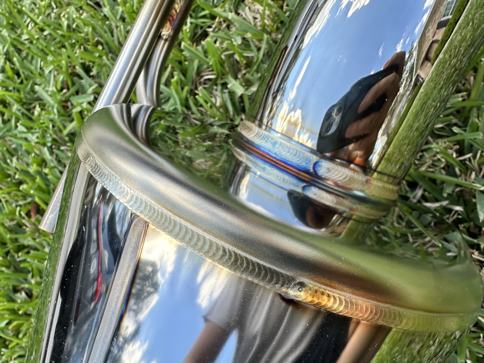

  • Nice and clean welds (way better than my NYTOP lower bumper)
  • Includes all necessary hardware
  • Nice and shiny and looks to be very high quality (has serial numbers etched into muffler)

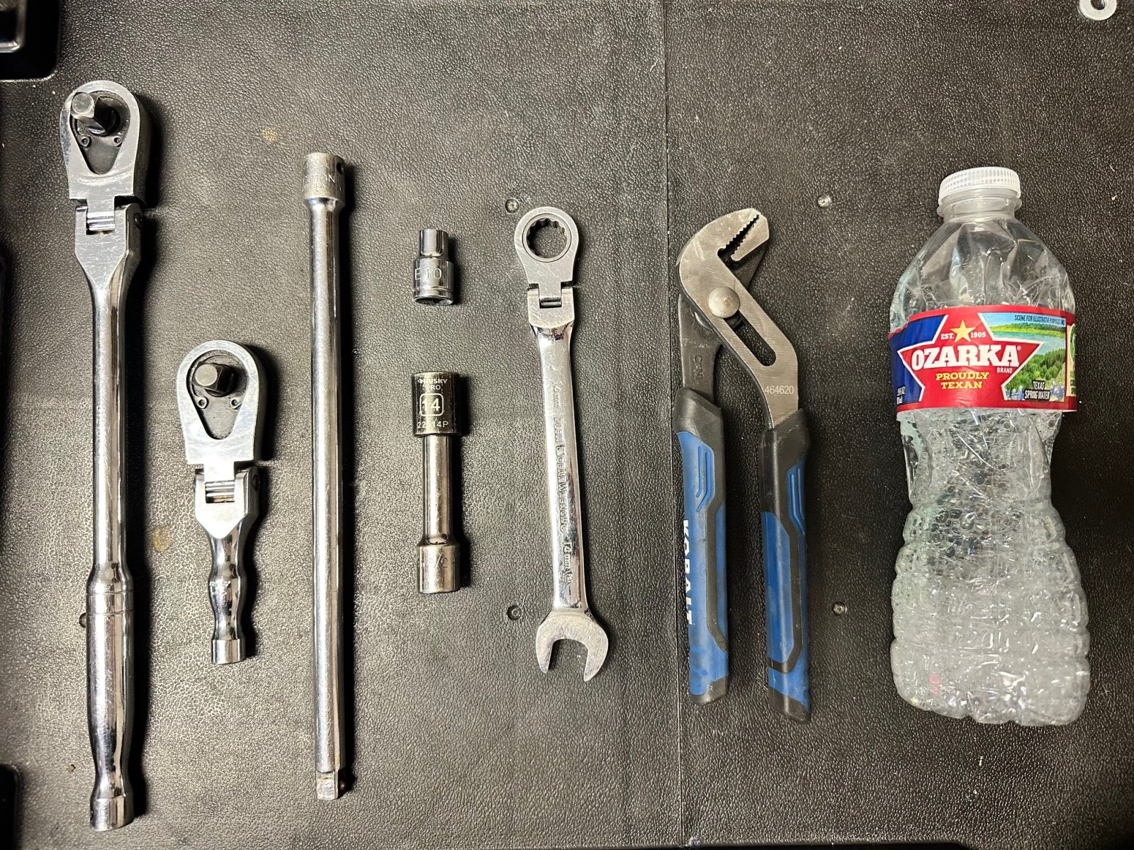

Tools Used:
  • Ramps
  • 3/8” Wrench with various extensions
  • 3/8” Stubby wrench (not required but useful)
  • 14mm Socket
  • E10 Socket
  • Channel Lock Plier
  • Soapy Water to lubricate rubber hangers

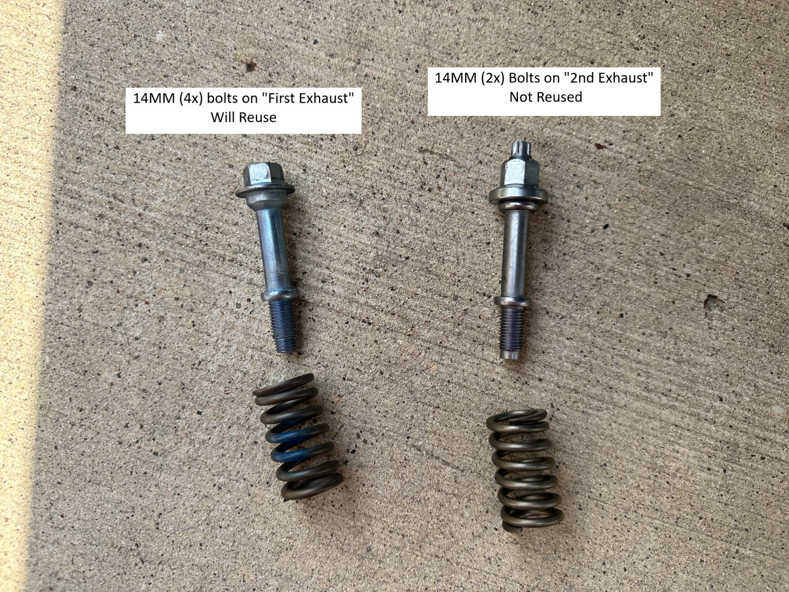

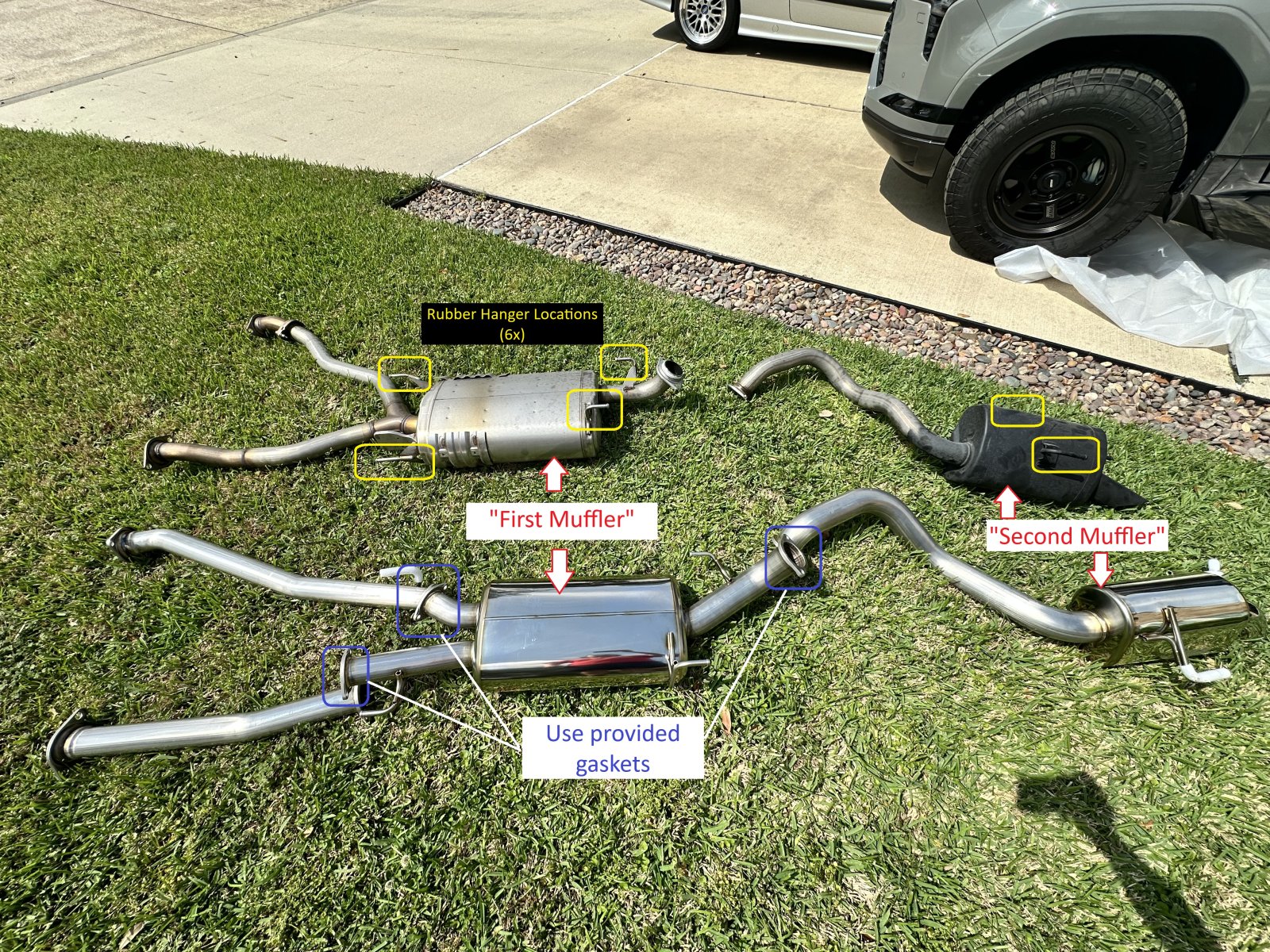

OEM Exhaust Removal
  1. Take off spare tire
  2. Back up onto ramps
  3. Disconnect “Second” muffler first
  4. Remove 14mm bolts (2x). Use E10 socket if needed.
  5. Remove from rubber exhaust hangers (2x) (use soapy water!)
  6. Maneuver/tilt the “Second” muffler out
  7. Disconnect 14mm (4x) nuts between “First” muffler and Cats
  8. Disconnect rear-racing rubber hangers first (2x)
  9. Disconnect front-facing rubber hangers second (2x)
  10. Maneuver/drop the “Second” muffler out

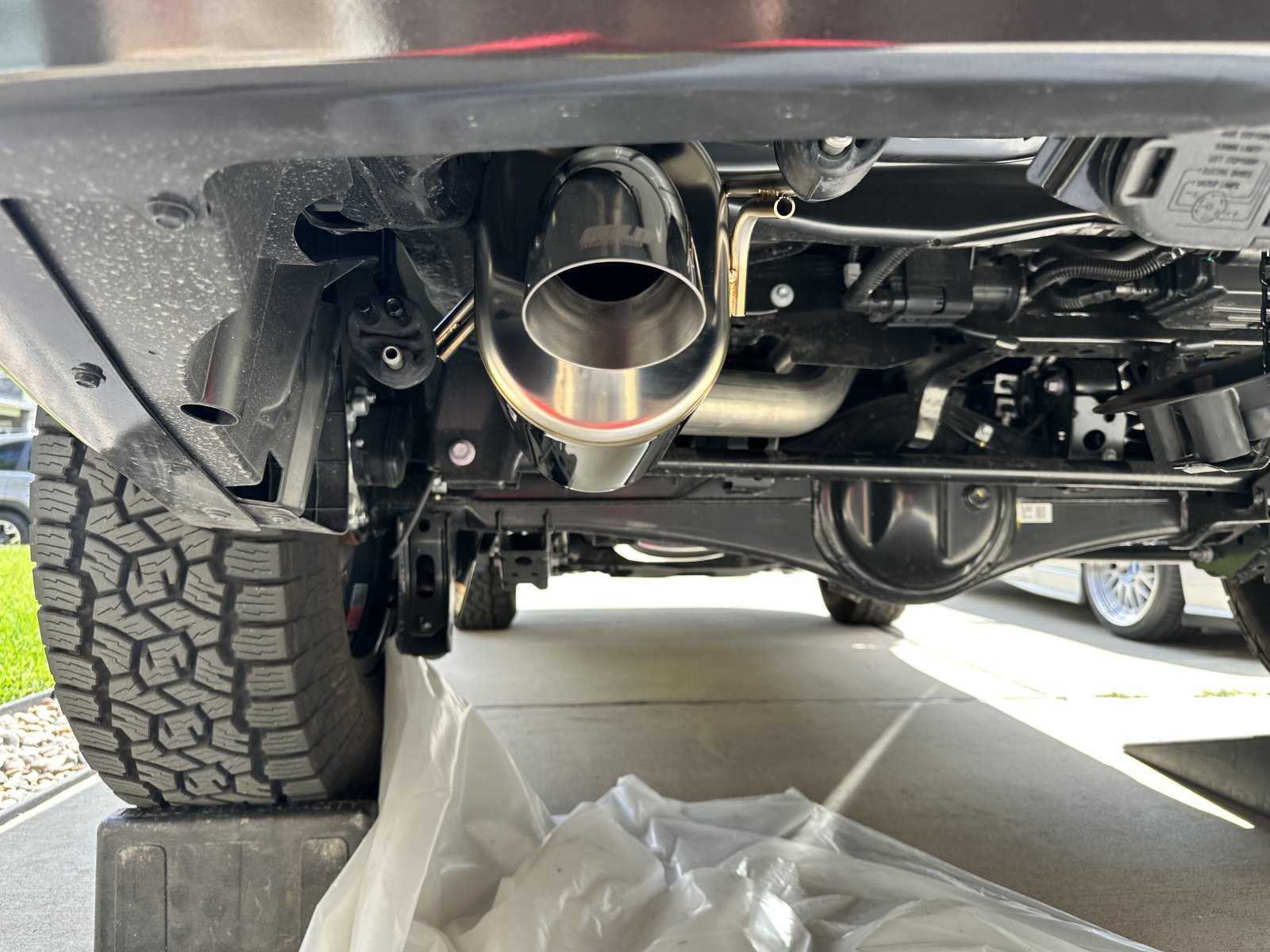

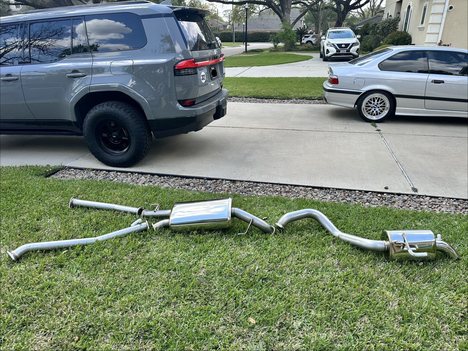

Remark Exhaust Install
  1. Where possible, pre-install rubber hangers onto Remark exhaust
  2. Install “First Muffler” first by connect it’s three rubber hangers onto body of GX
  3. Install the front pipes (2x) to the Cats (re-use OEM bolts) and to “First Muffler” – Use provided gasket (2x total) and bolts (4x total)
  4. Don’t tighten bolts all the way yet
  5. Install “Second Muffler” on rubber hangers (2x) and connect to “First Muffler.” Use provided gasket (1x) and bolts (2x)
  6. Check for alignment and clearance to other underbody parts
  7. Tighten all the bolts
  8. Recheck alignment and clearance
  9. Back GX off ramps
  10. Reinstall Spare Tire
Overall Impressions
  • Doing this by myself, it took me 30 minutes to remove the OEM exhaust and another 45 minutes to put the Remark exhaust on.
  • Perfect fitment and alignment
  • Nice low/light growl (more fun to drive)
  • Very minimal drone (if any) but with wind and road noise and AT tires, it's really hard to notice any drone anyway
  • I'm very happy with it... not too loud but enough to put a life in the exhaust and more fun to drive

I too made the jump and installed the Remark Catback Exhaust. I really like the sound. The sound of the new Exhaust helps drown out the noise of the OEM Roof Rack. I'm happy :)
