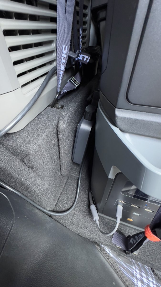

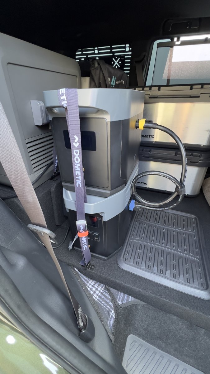

My setup is unique in that rear seats were removed and a platform put in so here’s how it looks.Any pictures of where you mounted the Ecoflow Alternator charger in the GX?
I have a victory shelf in the back with the side panels so it’s on there. I’m getting a goose gear deck plate as well so it might fit under there.Any pictures of where you mounted the Ecoflow Alternator charger in the GX?
