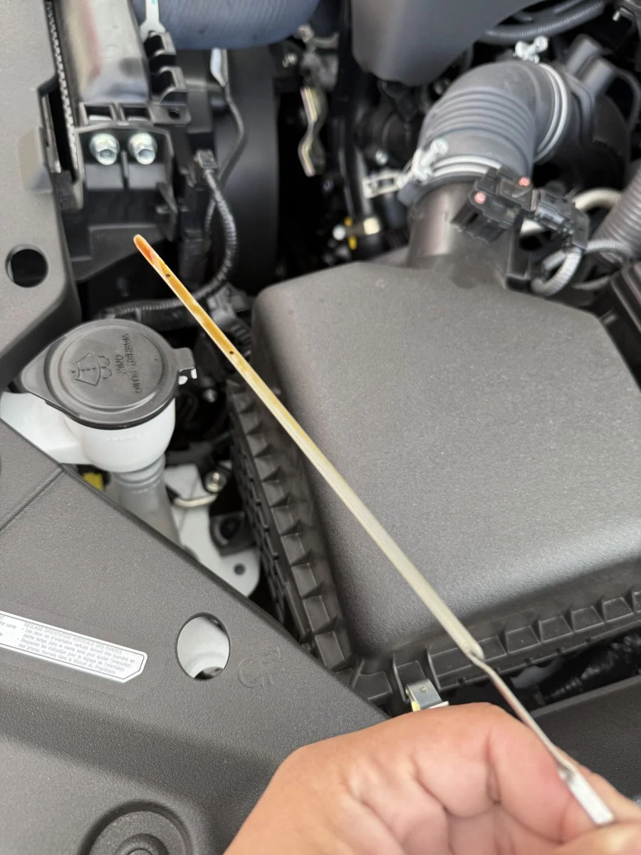

My next scheduled maintenance is only 03/25 according to the sticker. My current mileage is more or less 11k. I just checked the oil and it seems OK maybe a little low. I never know how to tell if it's really low by looking at the indicator. I think I'll buy some oil and fill in a bit
You’re most likely ok. Just confirm. I think the previous post from bluegill makes sense
Did you wipe the dipstick and reinsert it and then read it? because that's how you tell if its low or not. and you do it with the engine off. If you add oil when you're already full, you can create more issues. When in doubt, have it checked out, please.

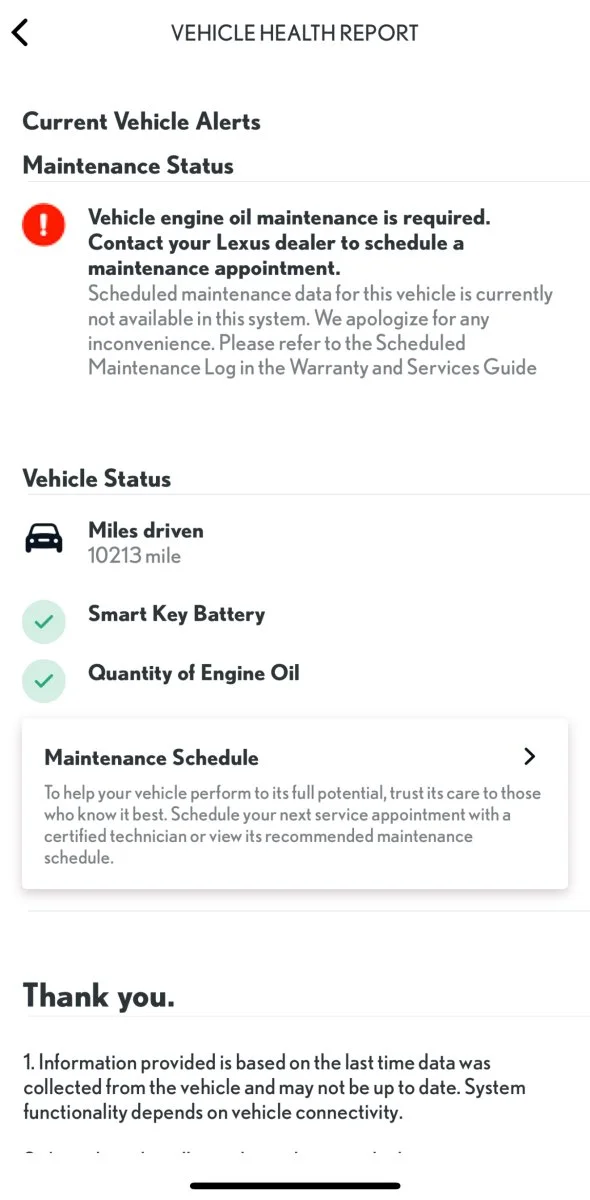

Just to let you know, there's actually a "quantity of oil" information in the Lexus app under health report, it shows as fine. So yeah, it's just a change of oil due to the mileage. I think in the last service it hadn't reached the mileage for changing yet. Jusr think the alert should properly inform it. Getting an alert message in the panel about the engine oil without more details kinda freaked me out since I'm literally going in to a desert area.
Looking at your above post I see you have 10213 miles on your vehicle. Lexus scheduled maintenance indicates oil and filter change every 10000 miles or 12 months whatever comes first. They may have forgotten to reset your oil maintenance reminder.

The oil level is supposed to be between the two holes, don't add oil and overfill it.
Remove the dipstick, wipe the dipstick clean, wait a couple minutes so that the oil that you pulled up the sides of the dipstick tube when you pulled out the dipstick has some time to drain back down. Then reinsert the dipstick, make sure it's seated, and remove it to read it.
