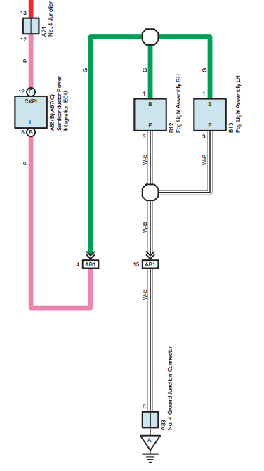

I did see some used OEM assemblies on EBay - $220 per side. Here's the wiring schematic for the fog lights:

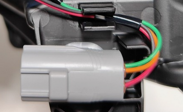

I pull the mud guards but did not see any
Next step is the pull the bumper off
Hopefully they are zip tied some where
