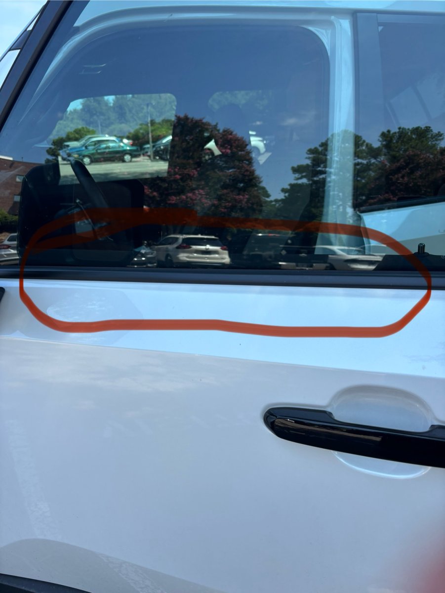

Not sure if this will fix this issue or not, but the lexus tech seemed pretty confident he located the smell and it was same spot on other 550’s he’s already replaced. Maybe smell this part of your door after your next rain or wash, after it has sat wet for 12 hours. Photo of moulding part dealer replaced is below.

Thanks for the info. I haven't noticed this on my Luxury since I got it last October and I live in the Pacific Northwest. I go to the carwash in average once a month. I have a garage though, so I don't if this makes a difference for the drying process, etc.

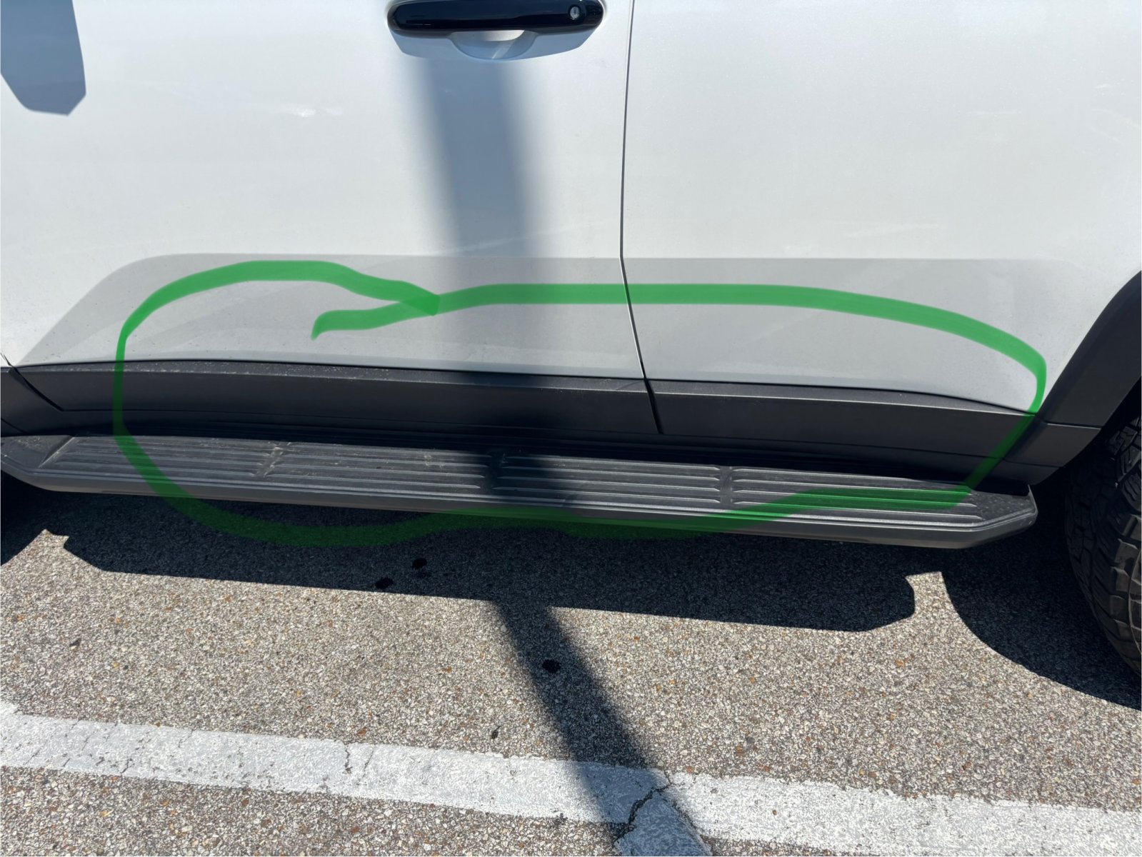

I did NOT pull plastic off the car. I noticed at noon one day that water was dripping from the bottom of the driver door when i opened it. It had rained the day prior, so thought it was weird that my car was baking in the sun and I had driven to work and somehow water was still dripping from my car from prior day. I tugged on black plastic and water poured out.
When tech was walking me through moulding replacement at window seam, he also pulled back plastic in photo below and showed me that is where the drain lines empty. He said my drain lines weren’t clogged, so not sure why water was holding for so long after a rain. Hope this helps.
