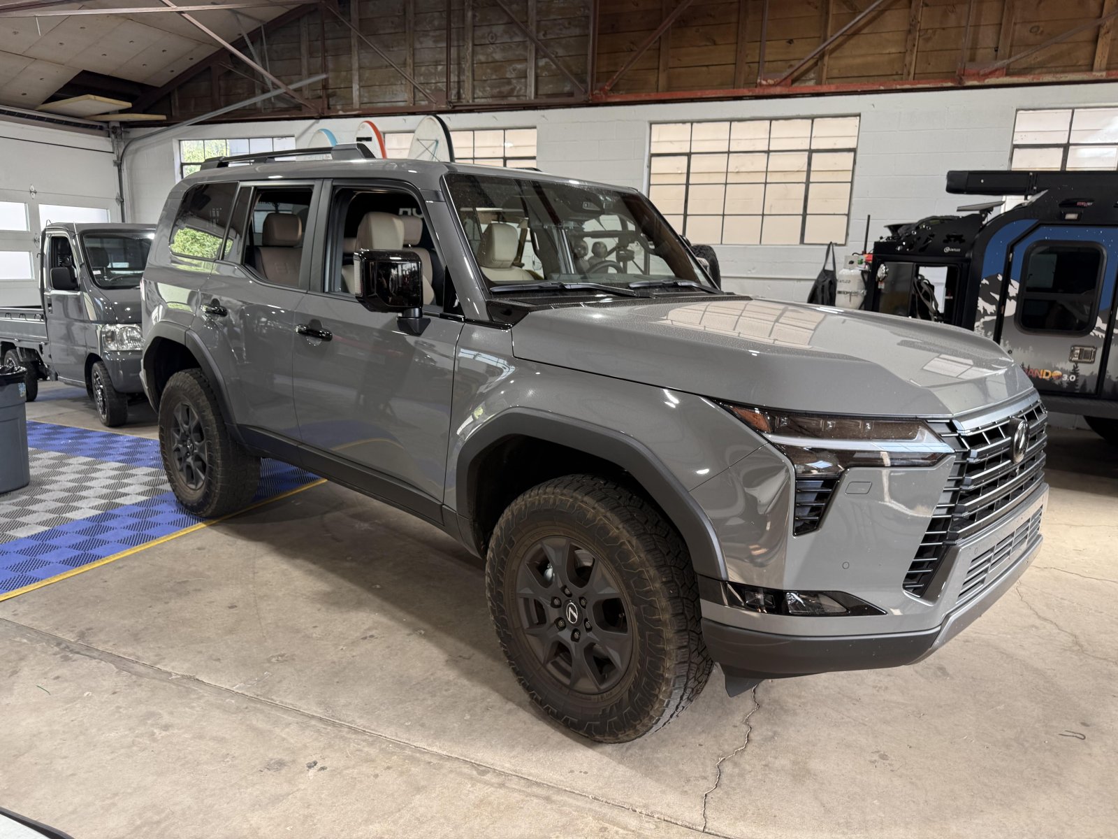

Picked him up at Lexus Of ABQ yesterday. Drove back to Durango right after...
Firsty mod. Look it up.

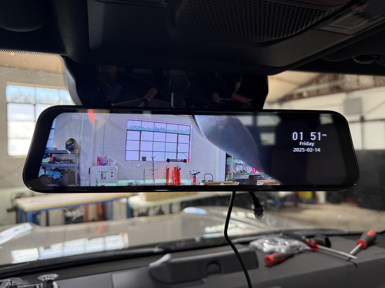

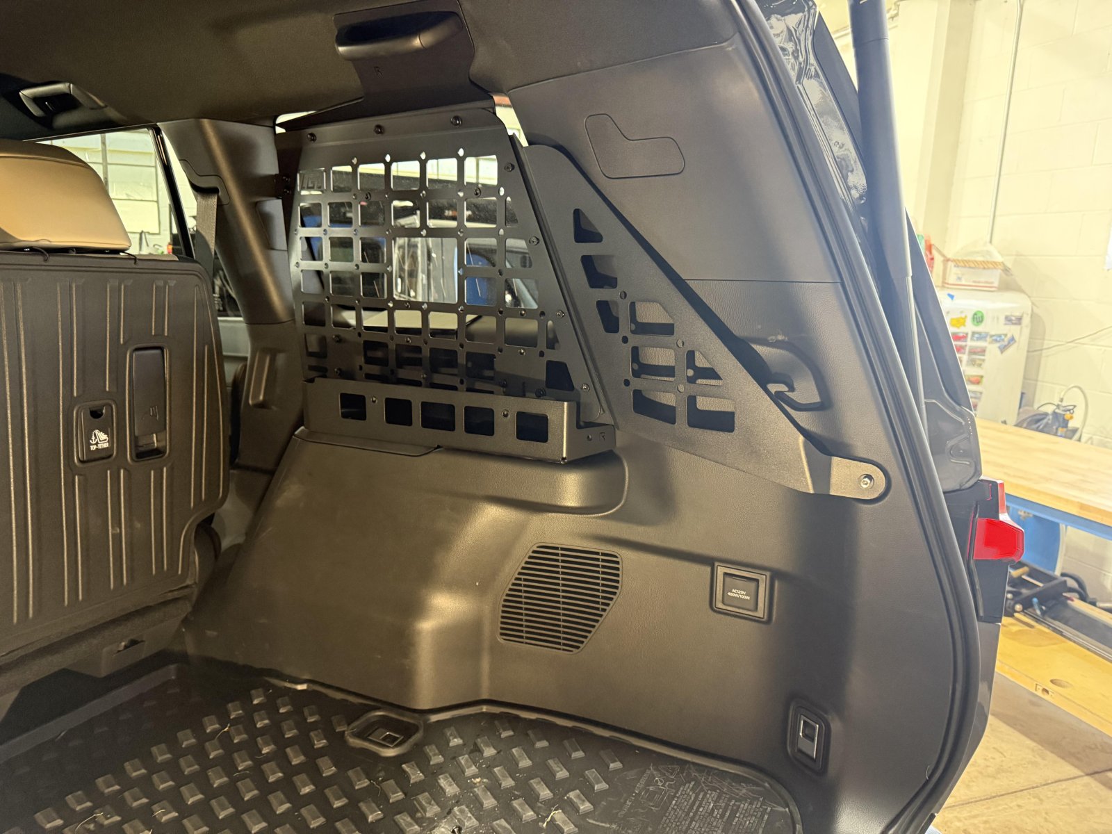

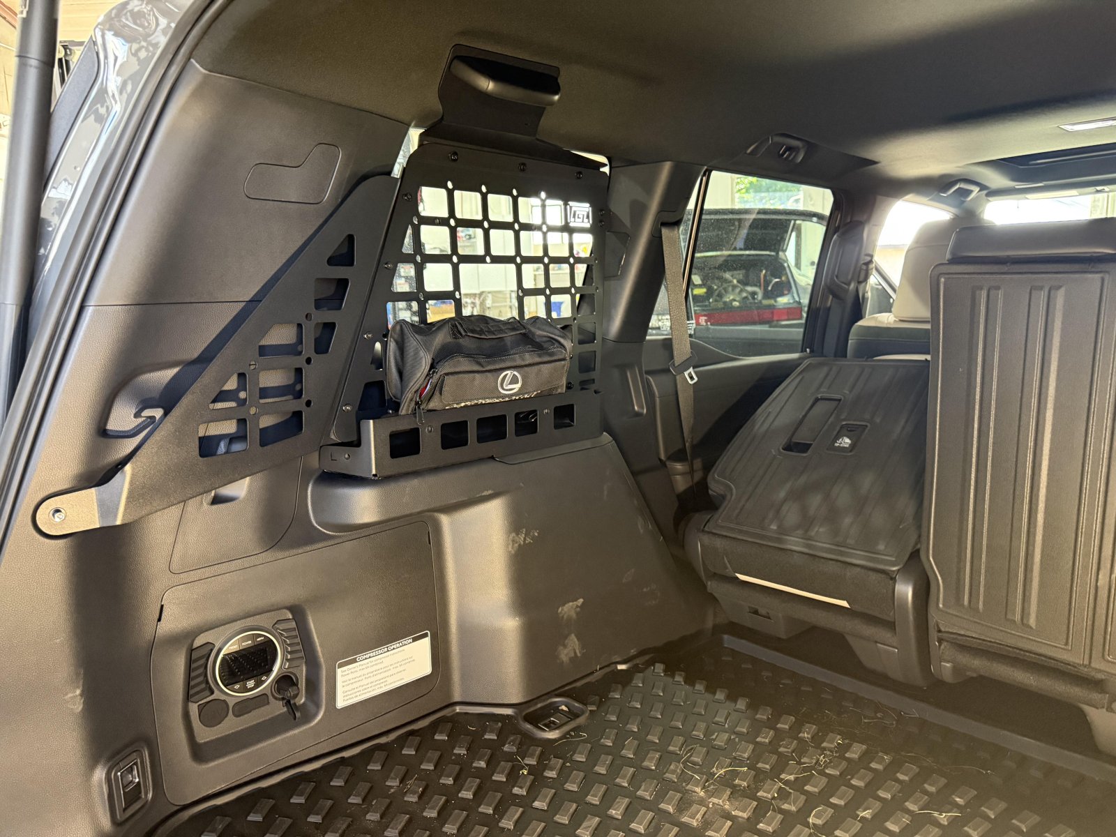

Installed the CarTrimHome molle kit (Toyota LC250 Rear MOLLE Panel Organizer | 2024+ Cargo Gear). I had ordered the Victory4x4 version, but I liked the design of this one and it was less expensive, so I returned the Victory ones. Went in easy and does exactly what I wanted.
The Wolfbox 900 diashcam mirror is partially installed. The mirror adapter kit does fit but is slightly too high causing the front camera view to be occulded by the front sensor surround, and the top surrond panel won't go in. I found this adapter, from Bob's Mirrors which may do the trick; ordered:
While there, I also ordered: Dongar PRO Parking Mode Adapter
Which should make installing power for the camera super easy.
I'll pull the rear camera wiring asap, and figure out how to ensure I can also get the signal from the trailer camera as I did in the Tacoma.

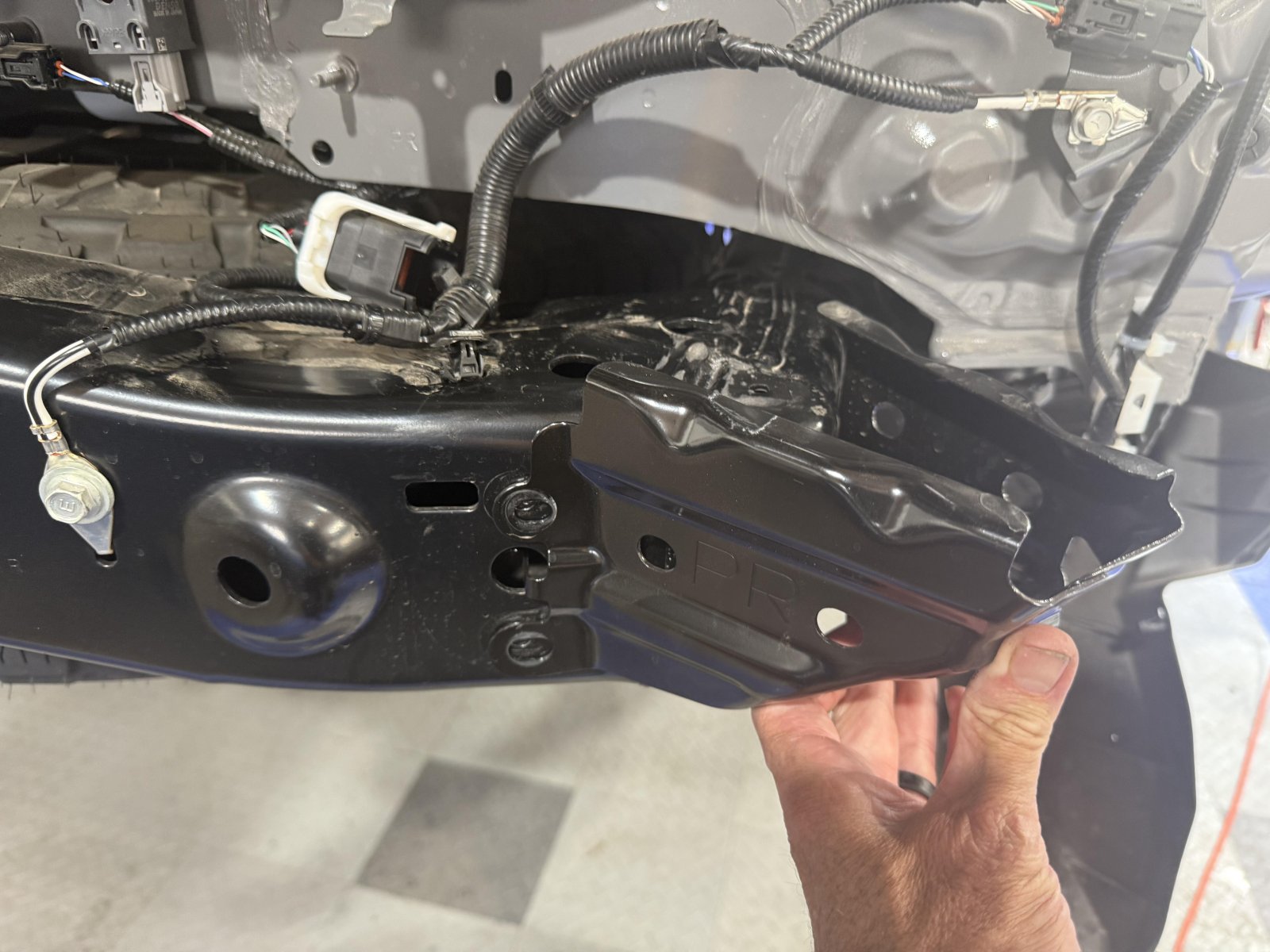

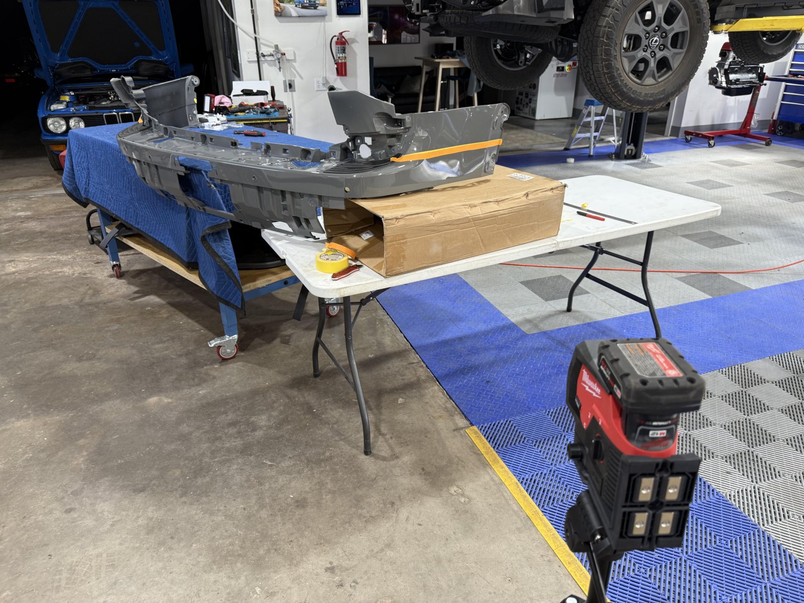

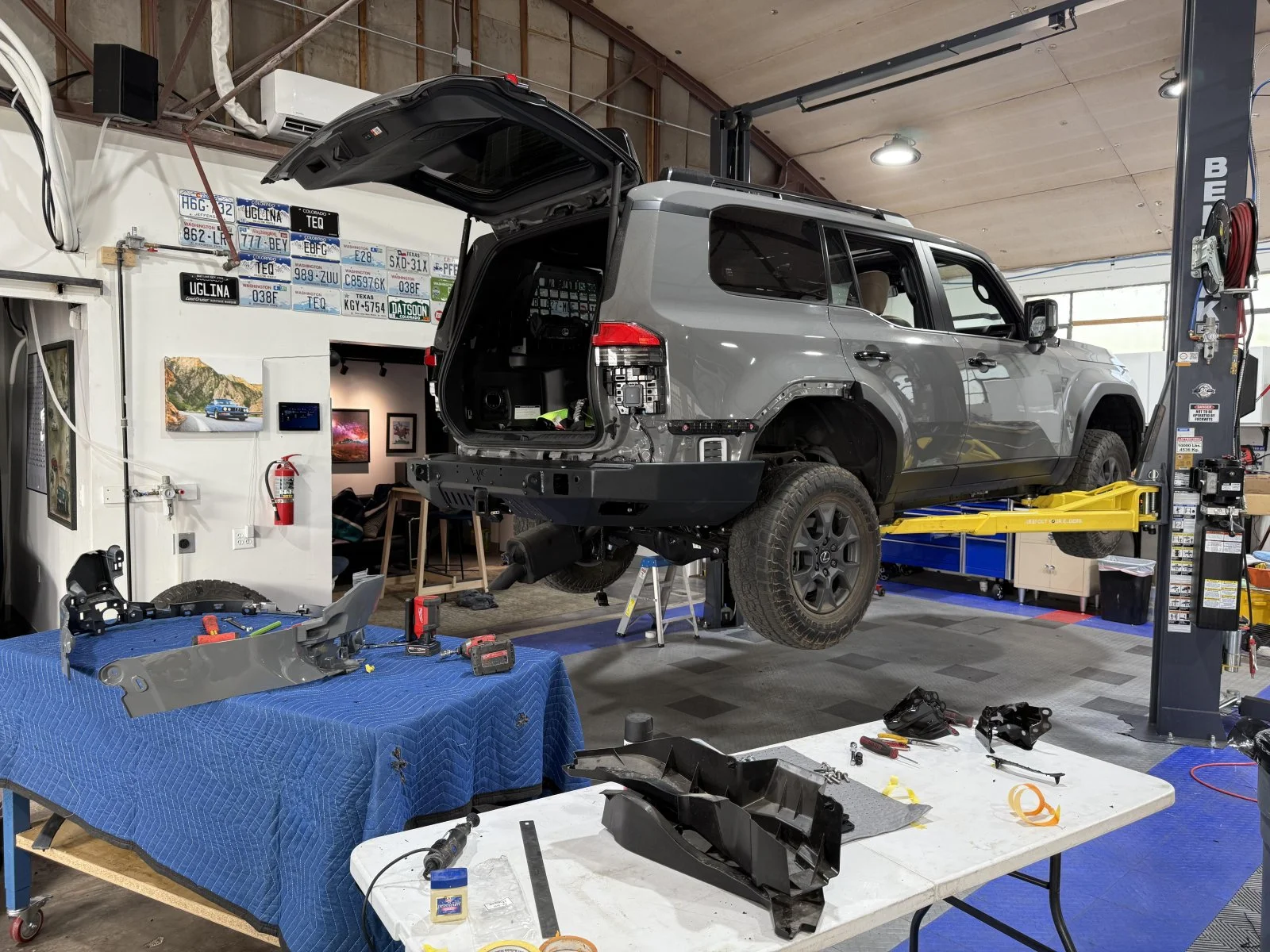

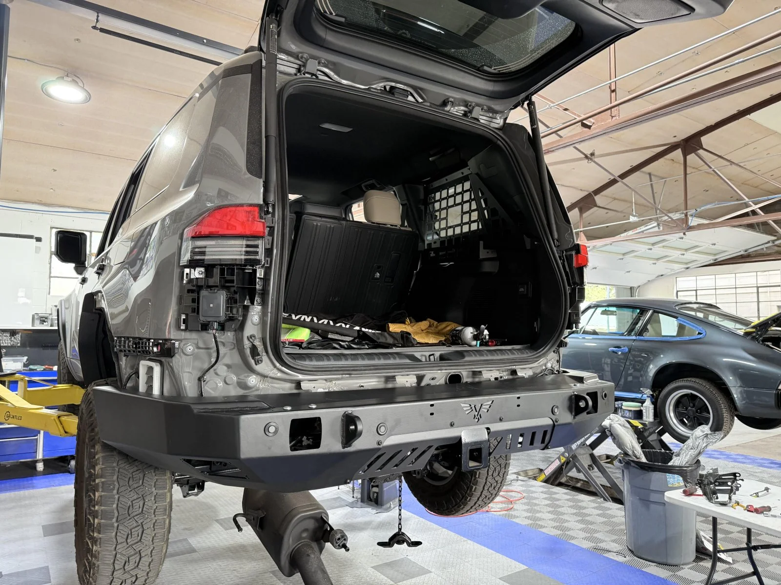

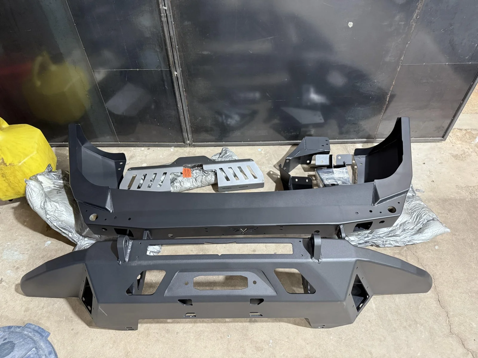

Have the rear Victory4x4 Strike bumper mostly installed.
Victory's build quality seems great. However, I've found their installation instructions to be lacking. There's really only a single youtube video and it's missing some details. Thankfully getting through on the phone was fruitful and helpful.
They really need a document that identifies where each fastener goes. For example there are four 19mm nylon-nuts and it wasn't clear how they were used until I was almost done. In another case, there's a need to tap a bolt to the frame that's not covered in the video (and is very hard to reach).

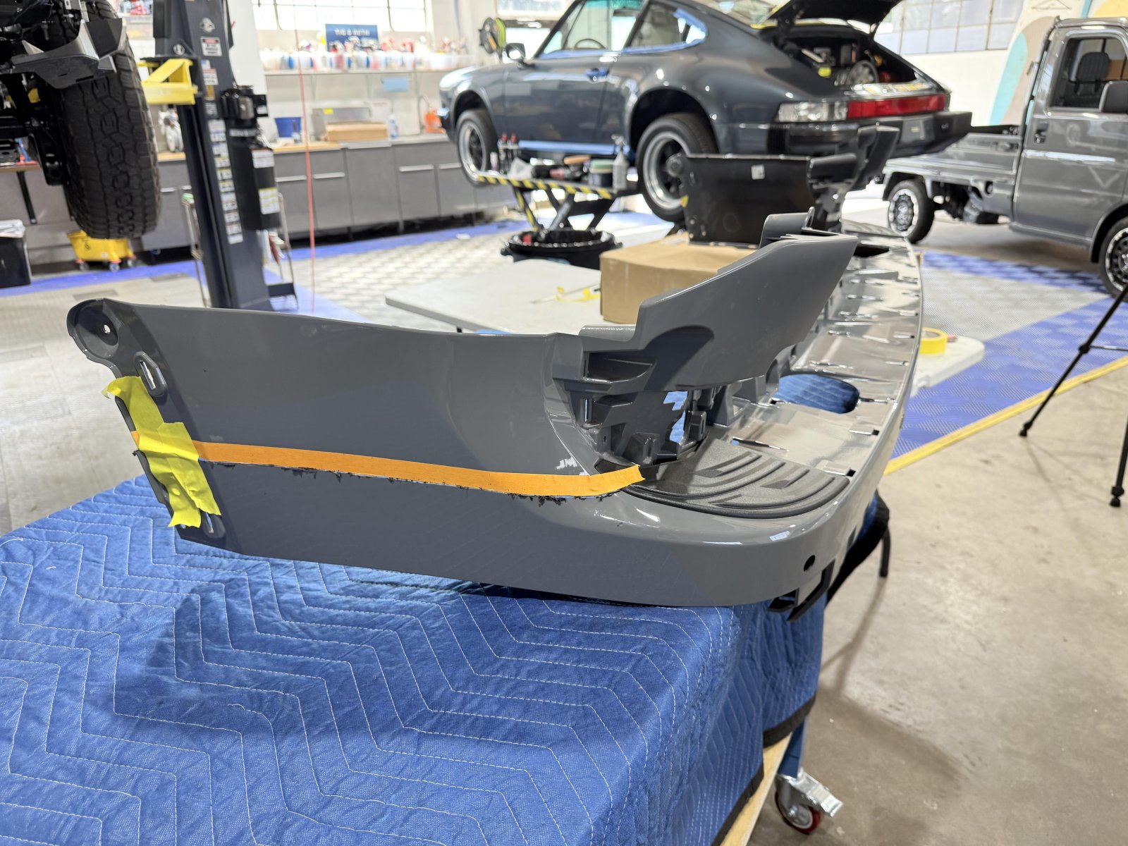

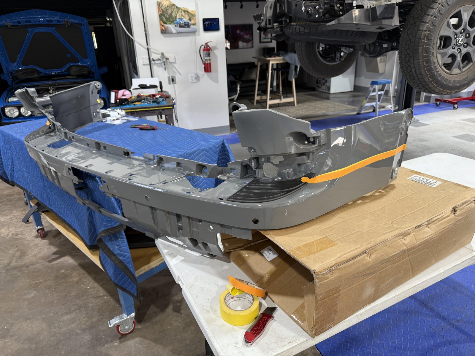

Cutting the plastic was scary. I'm a bit nervous about the gqp the recommended cut line will leave. We'll see.

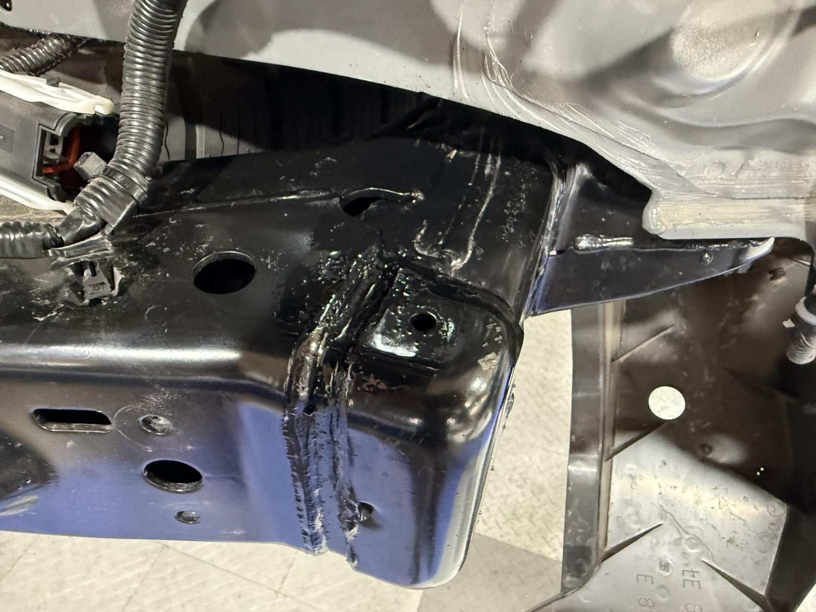

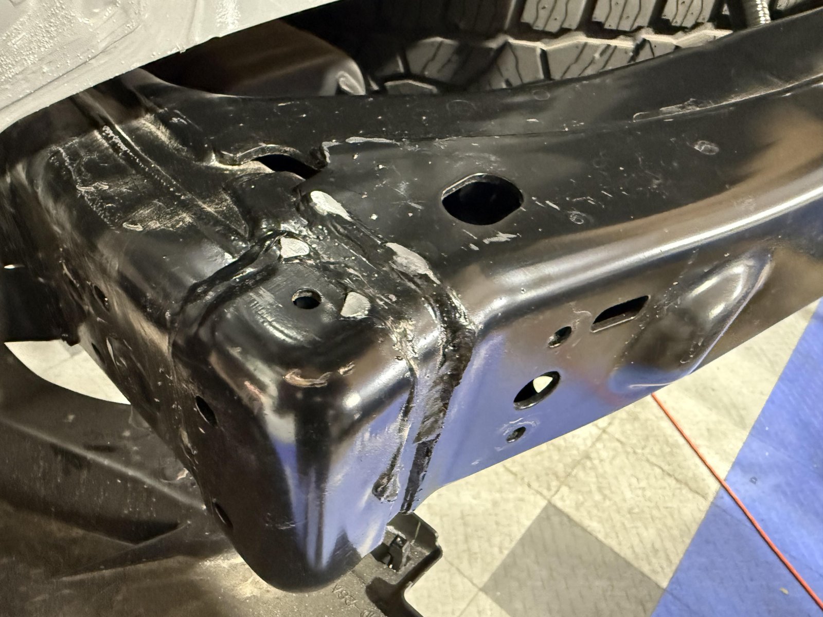

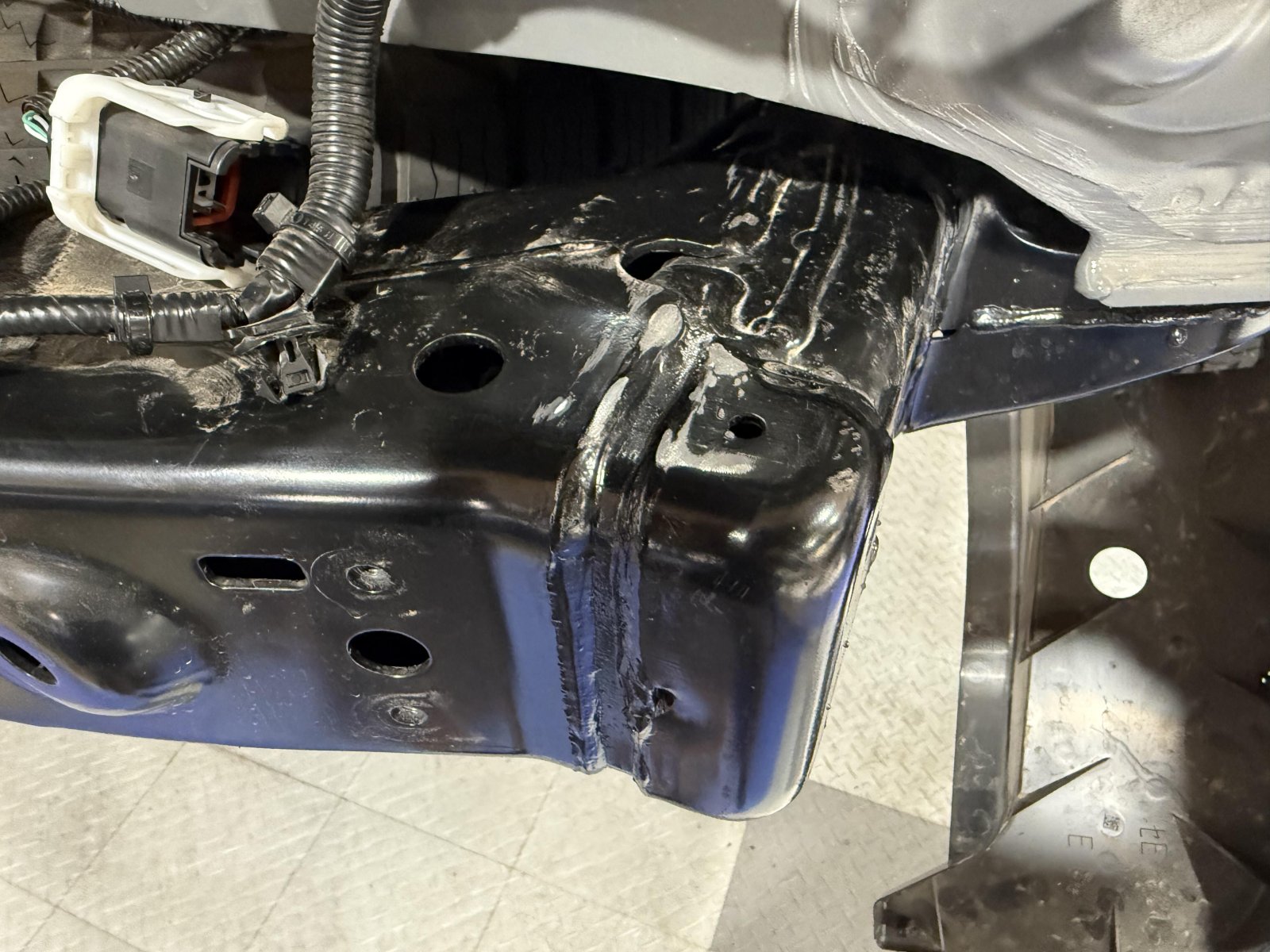

The only fitment problem so far is the welds on the top of my rear frame are apparently thicker than Toyota used to make and the rear brackets wouldn't fit. I had to file down the weld boogers a bit and then put some coverup paint on.
Oh, and it's effing annoying that some of the fasteners Victory4x4 provides are SAE. WTF?
Do you have any more info on that (what looks like a) compressor in your trunk? Is this a stock part from Lexus or was this an aftermarket item? Apologies if it was mentioned earlier in your thread and I missed it.
It's the stock factory copressor that comes on 2025 OT and OT+ models.

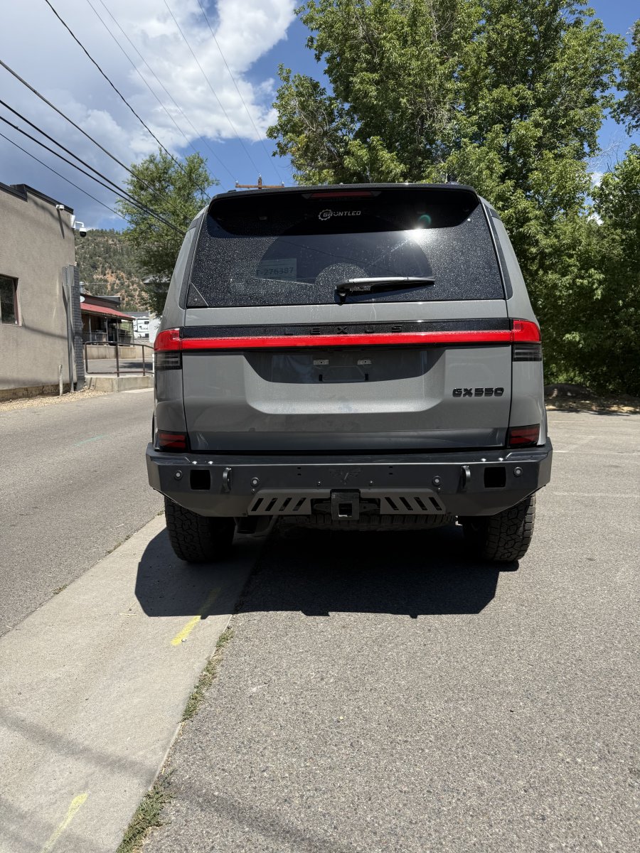

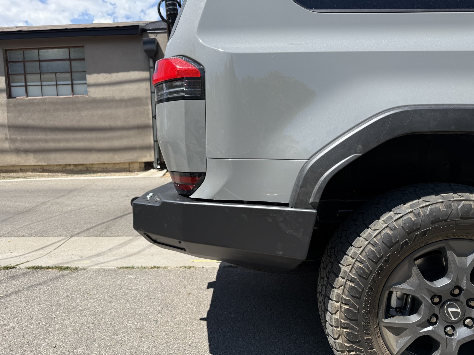

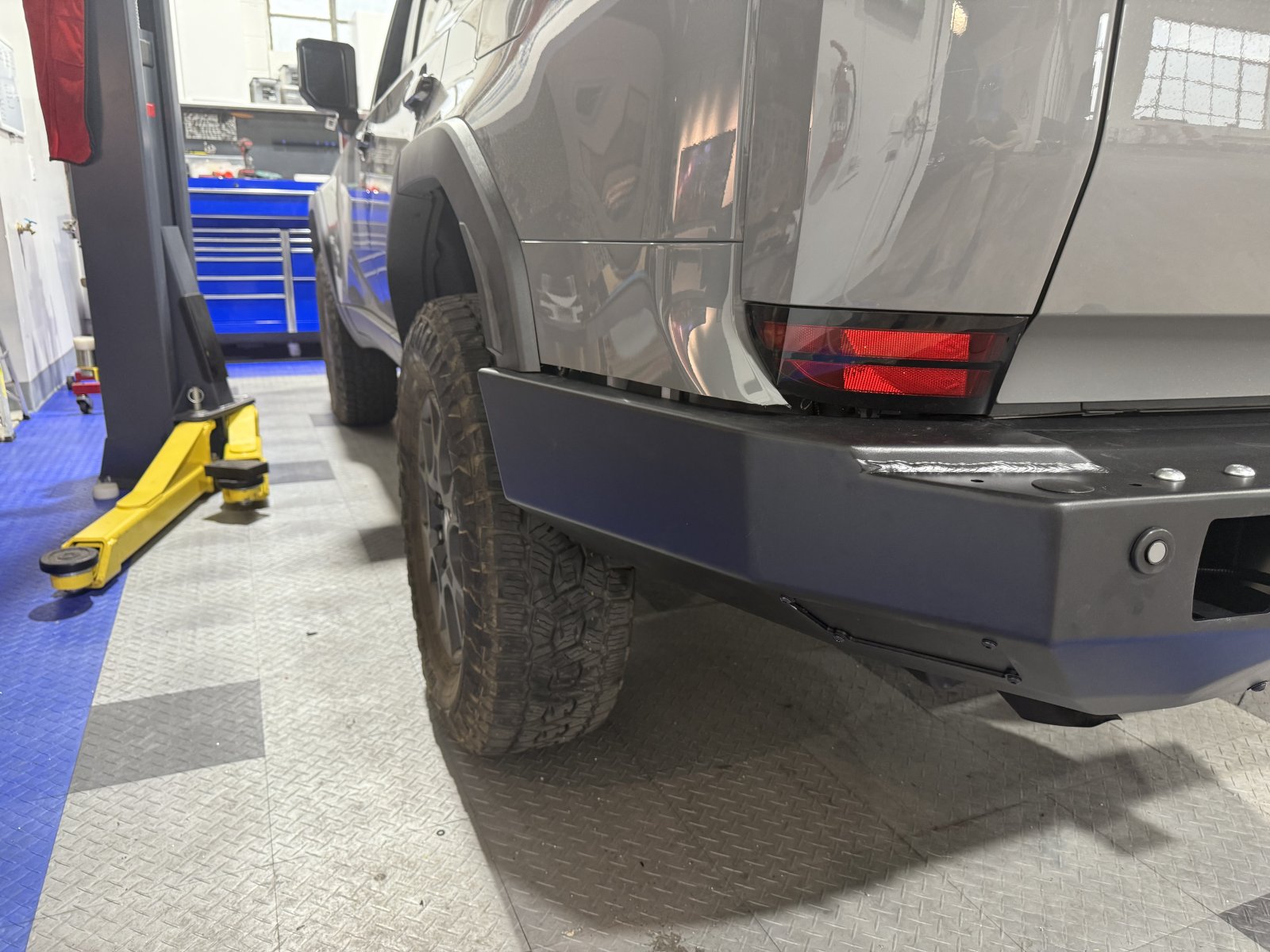

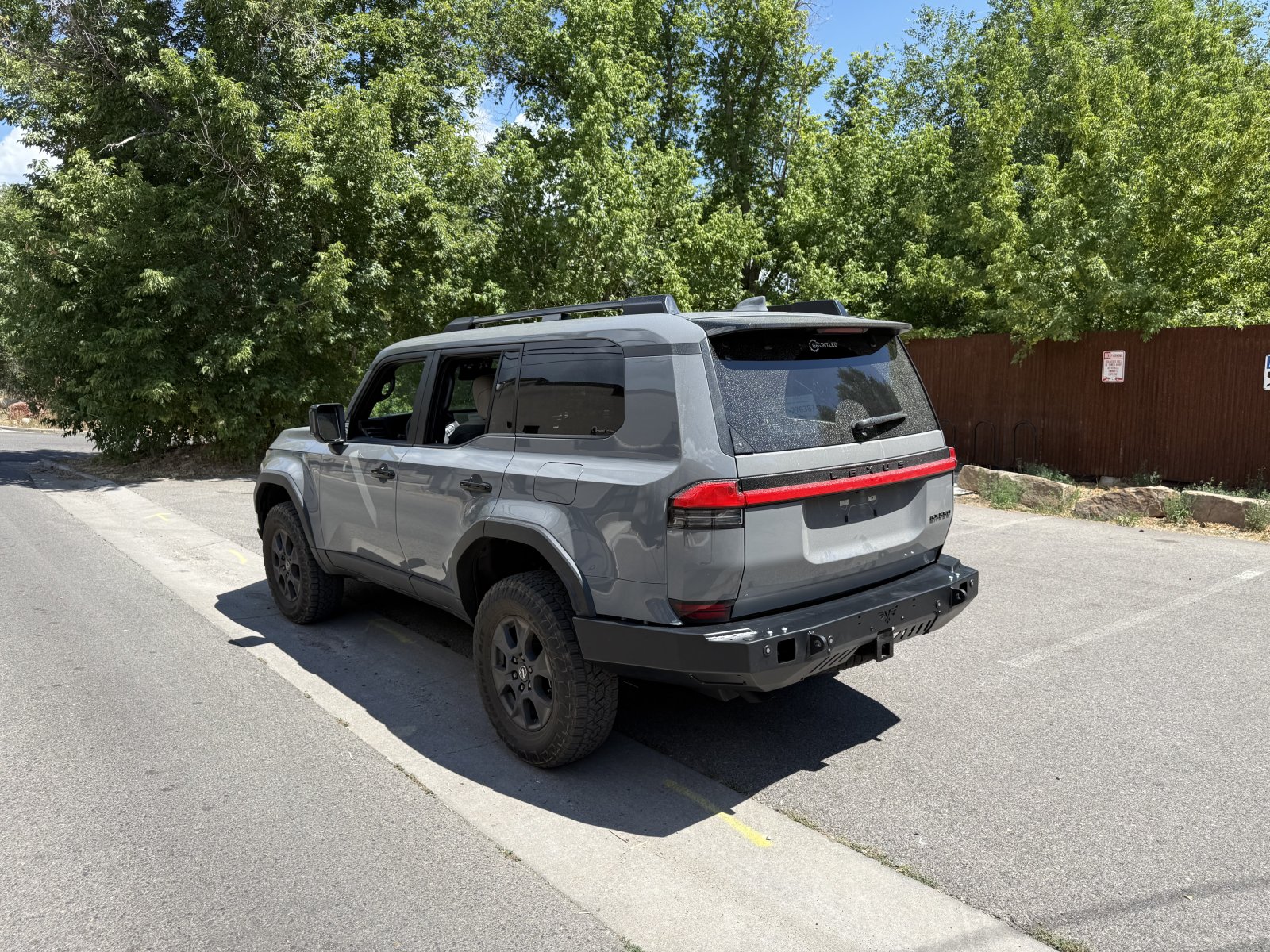

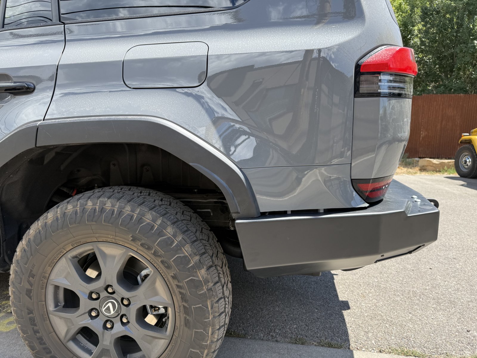

Rear bumper install complete. Looks great.
The gap between the trim that I had to trim and the bumper is too big. Pisses me off that victory4x4 specifies a 5 1/2 inch cut when it really should be closer to 5 3/4.
I’ve ordered some edge trim of various sizes and flavors to see if I can fill that gap cleanly.
I also installed my 1 inch spacers on the rear wheels. I didn’t realize the kit didn’t come with four spacers so I’ve ordered another kit for the front.
I think this is just about the perfect amount of poke.
I will be putting different wheels and tires on at some point, but I decided I’m gonna utilize these tires through the end of the summer in the fall. Might as well get you out of the tires instead of just tossing them or try to sell.
