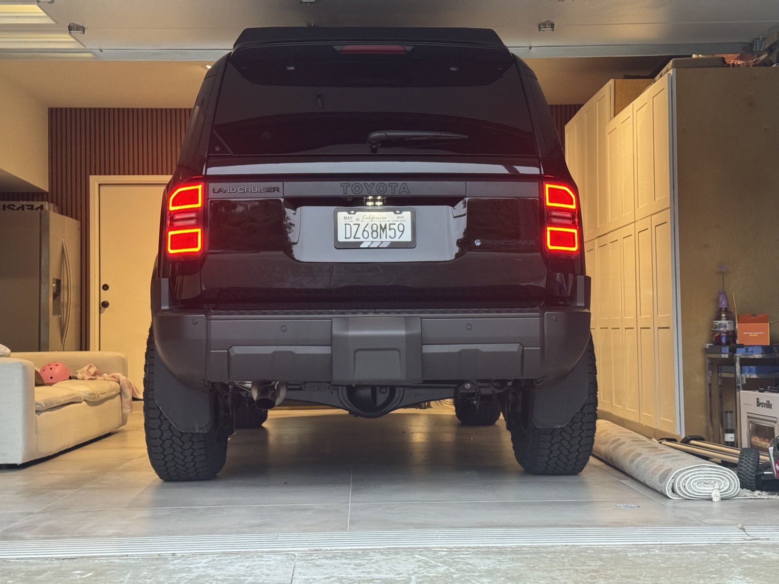

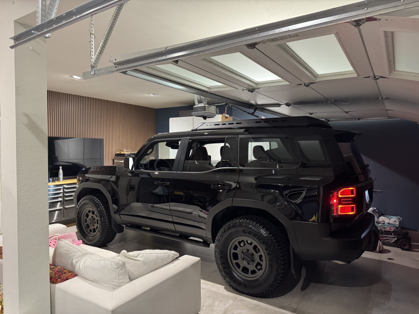

Just went through this entire exercise for my OT. I ended up getting 285/75/r17 tires (17" wheels, +35mm offset) and there is zero rub at all (no after market lift kit). If you keep the stock wheels (18", 50mm offset), 285/70/r18's are .1 inch smaller than mine, so you wouldn't have any rub either. This website was very helpful to see comparisons of two different tires:
Also, this video was great and discusses how wheel offset definitely makes a difference with whether a tire will rub or not. He makes it sound like 285/75/r18s would fit without rub. I had no idea what offset was before diving into all this.
Hope this helps!

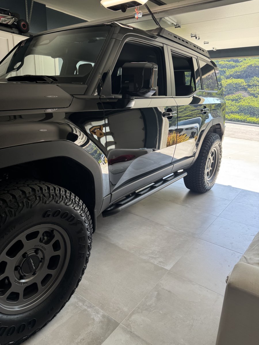

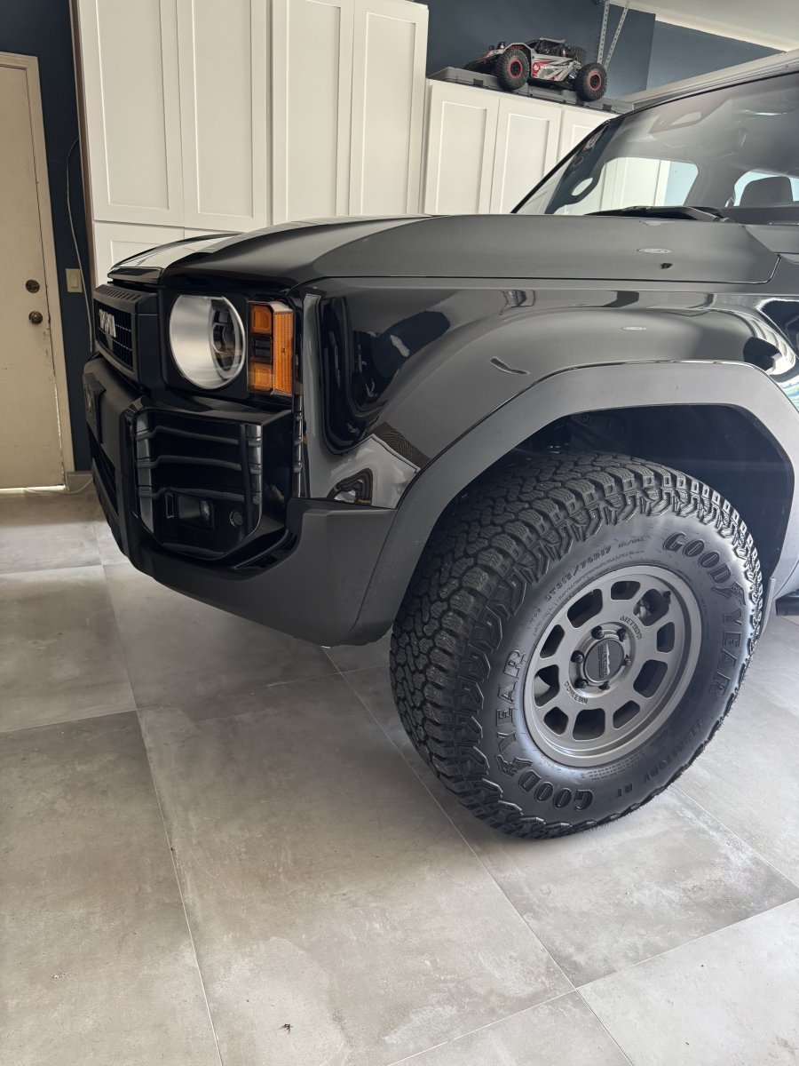

I've got 275/75-17s being installed, which is almost exactly the same size tire as yours. My wheels, however, are +25 offset. So we'll see if that causes any rubbing issues. I'll post pics when I get it back.
You'll be perfectly fine with these tires. Some rubbing may occur with 285/75R17. Anything smaller will not rub.
I didn't like any of the available options.
I'm sure you saw these, but they fit the bill for me perfectly. Not too wide, as tall as will fit with spare, 3 peak snow rating, strong sidewalls and belts, great tread pattern if you use your OT off road. Mickey Thompson 275/70/r18 on stock OT wheels. Pics in link.
Just got a call from the installer saying that they were able to fit 285/75r17s with no rub. Can't wait to pick it up. This is on a 2025 OT+ with just the Peak 1.25in front leveling kit.

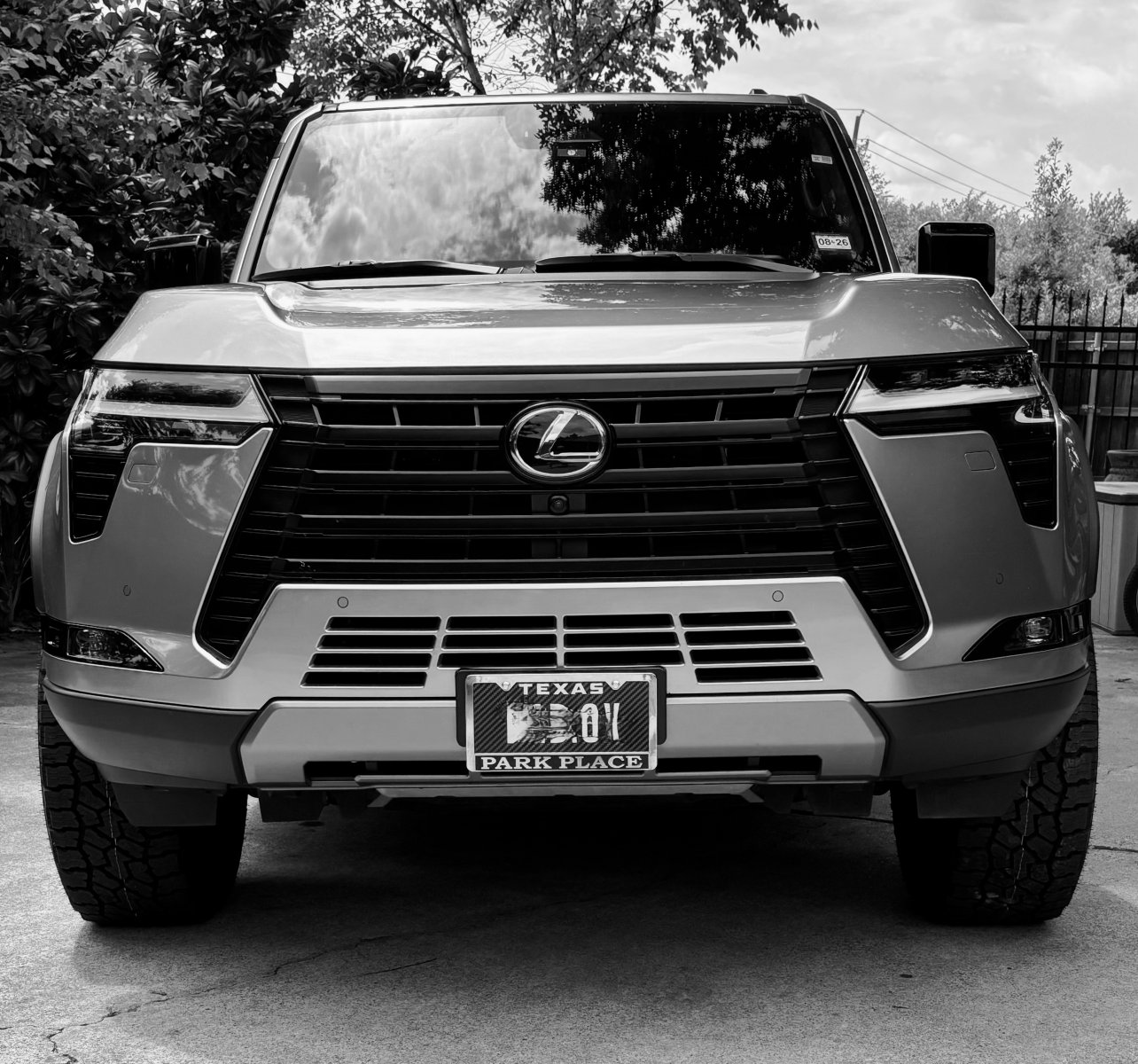

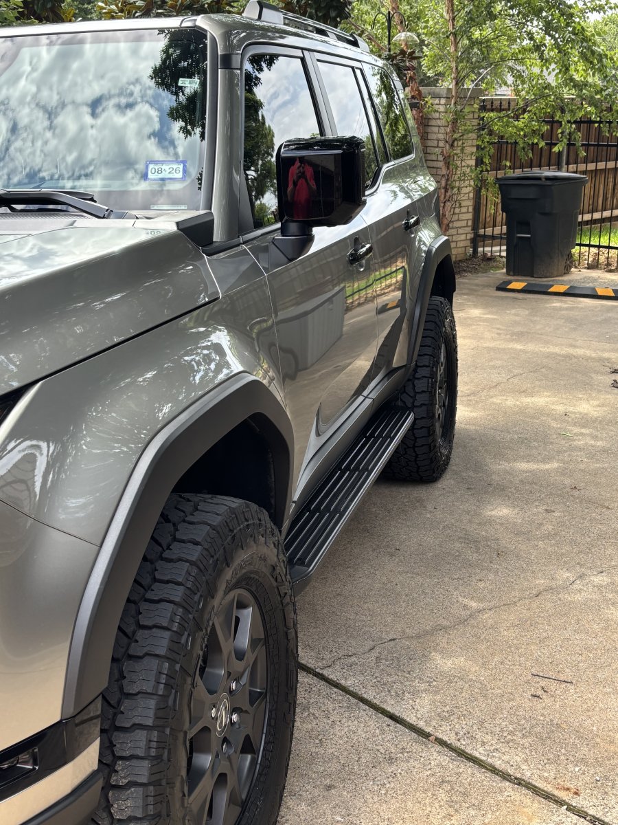

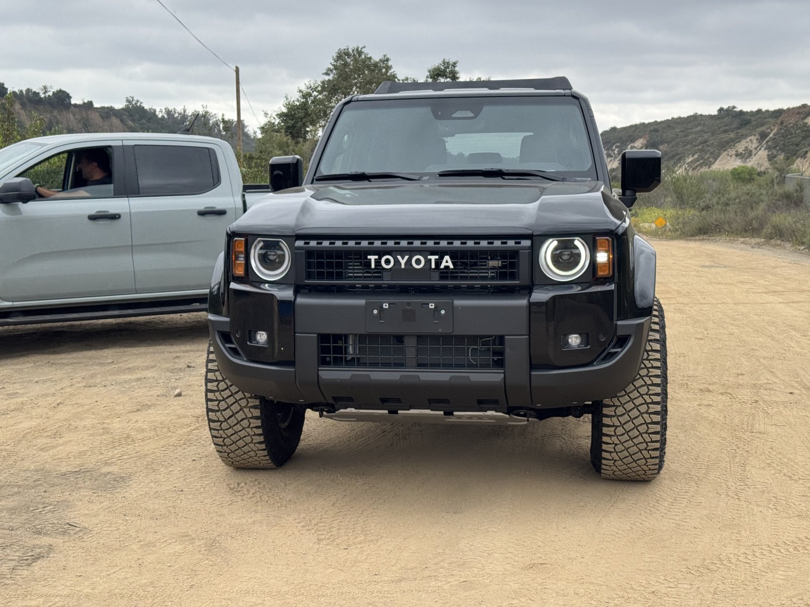

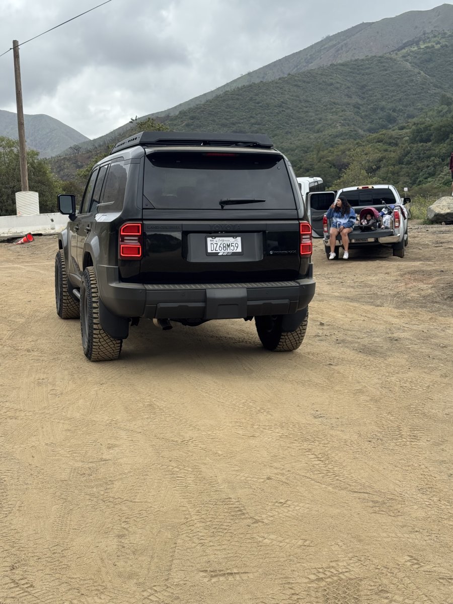

That's the exact tire I have here.
That's looks great 👍
Just to confirm those are the C Load AT4W 285/70-18’s in the pics on stock 2025 OT suspension with no lift or spacers?
How do you find the ride on them compared to stock tires?
I would certainly like to hear how those are working as well @rangertrace.
