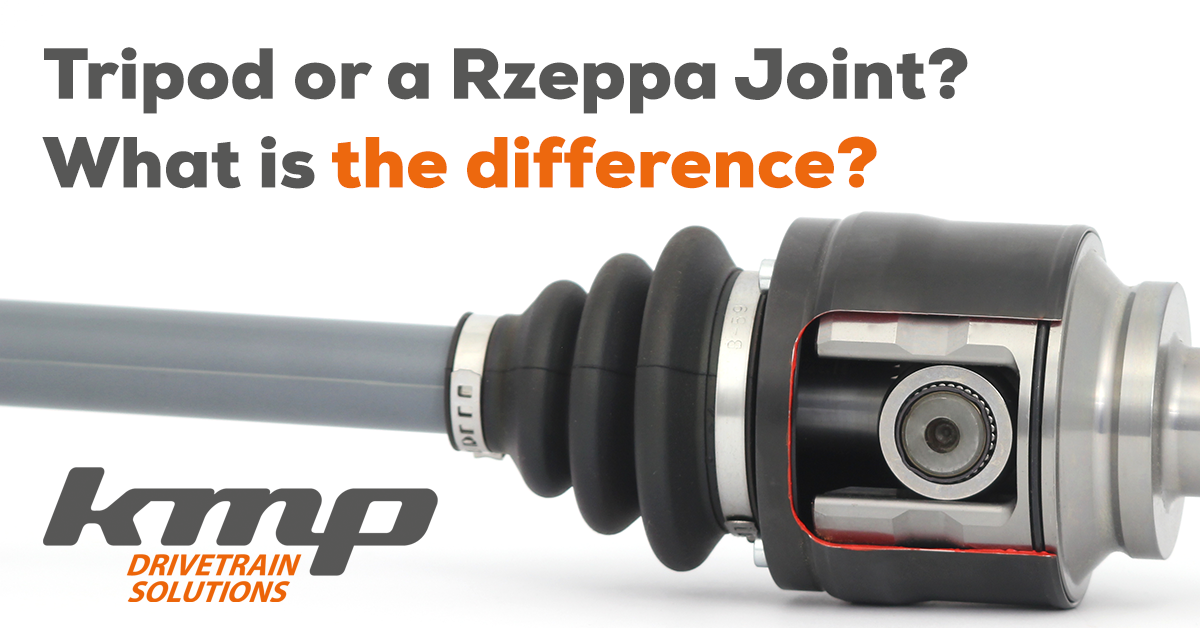

This article provides good information of differences in two designs
Blog tripod vs. Rzeppa joint – KMP Drivetrain Solutions
n this blog, we would like to talk about the difference between the regular, ball-type CV-joints used in most passenger cars and the tripod joints that we use in our driveshafts.
www.kmpdrivetrain.com
