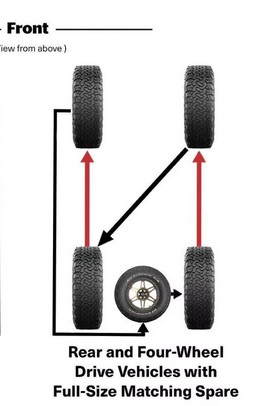

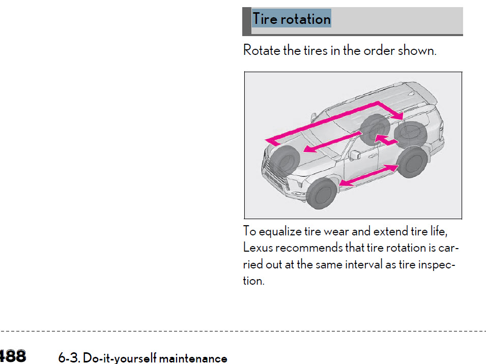

I'm seriously questioning the Owner's Manual instructions for Tire Rotations. Attached is an image copy of the section of the manual for a Lux/Lux+.
The image shows rotating the full size spare tire in a three-way rotation on the passenger side. For the driver side only the two tires are rotated. This picture shows driver side tires never getting rotated to the passenger side, and vise versa. Won't this cause more wear on the driver side tires, by 33%?
This rotation pattern isn't normal IME. This will be my first Lexus, so maybe I'm missing something.

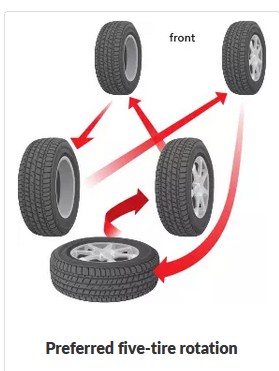

And this is the 5 tire rotation pattern BF Goodrich recommends using. All this makes 3 different recommended rotation patterns! Lexus, Discount Tire, BFG. Maybe at the end of 5 rotations all this patterns achieve a similar result. Didn't play the scenarios out.
The difference in the Goodrich and Discount Tire sequence (vs. Lexus) is all five tires progress through both sides of the vehicle.
Lexus keeps the same two tires on the driver side and the same three on the passenger side ... evidently for the full life of the tires.
Here's my thinking:
Say you drive 100k miles on a set of tires -- not likely I know, but round numbers for this example. After 100k miles the two tires on the driver side both have 100k miles on them. However the three tires being rotated on the passenger side each have 66k miles on them (because they are each being used 2/3 of time over 100k miles). So the driver side tires have 33% more miles than passenger side. Am I missing something?
