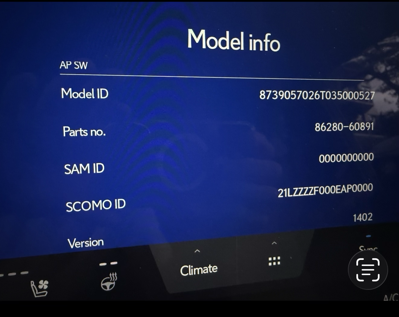

Got my amp replaced yesterday (finally) on my 2024 GX 550 OT+ under warranty. Definitely better (IMO), still a bit lacking, but worth getting it done if you can. The bass held up at 50+ and didn’t cut off to the “tinny” sounds. I’d like to flip out the speakers and, hopefully, get a more “quality” sound, especially in low range. My fourth documented complaint since October 2024. JM Lexus in Margate Florida came through with a three week wait time! Was told on prior occasions by other dealerships, that a fix wasn’t available but the complaints were a “known issue.” It really is an improvement!

So I called my SA and asked and he said it was a “new” amp. Software version 1402. After a week with the new amp/software, it is markedly better IMO. Still has some shortcomings, but much better than it was. I am going to look into a speaker replacement soon. Im still not thrilled with the low range quality.
