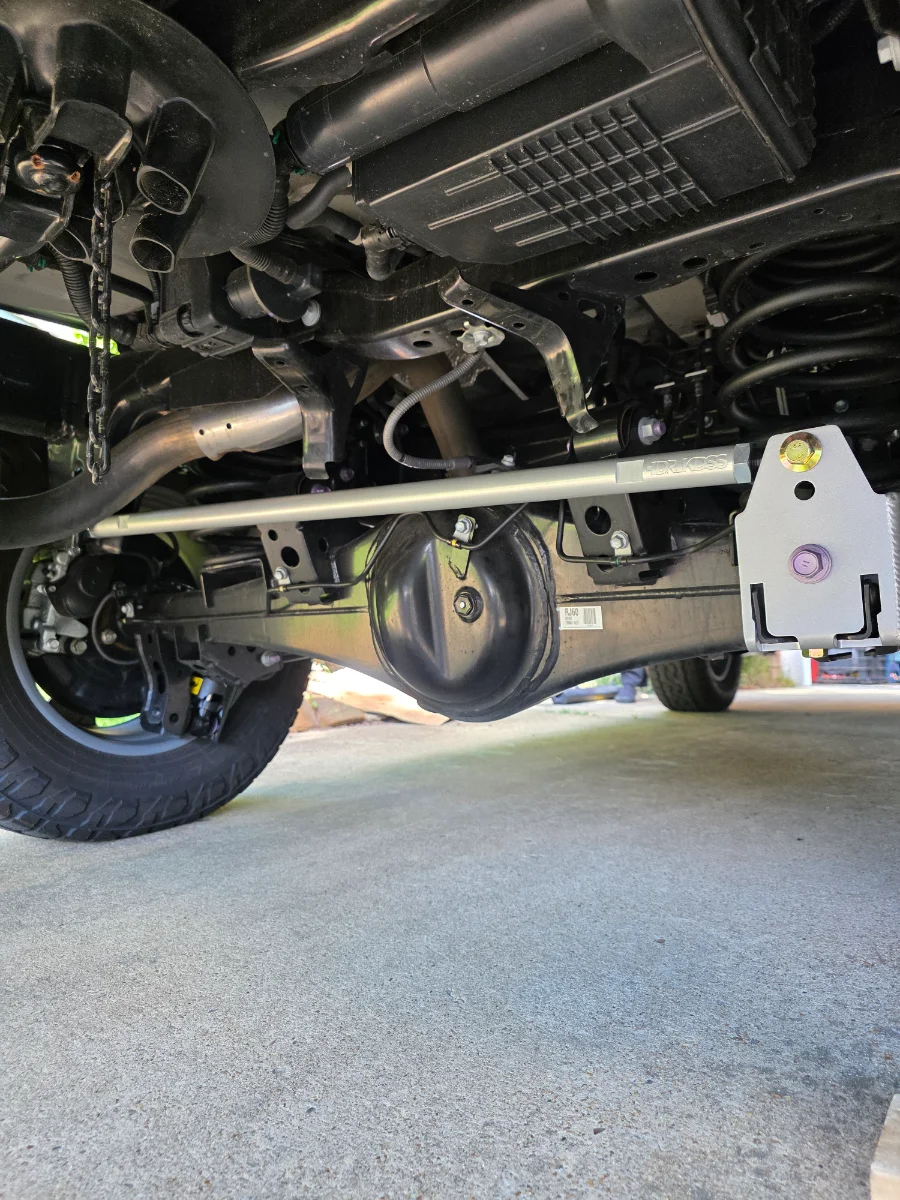

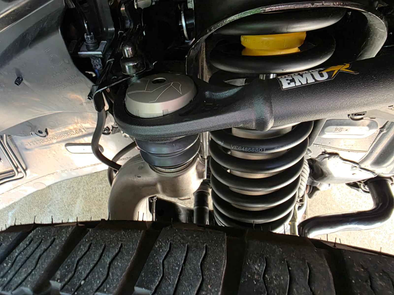

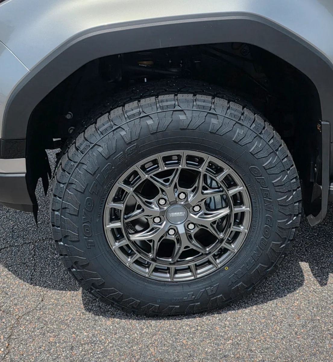

My son and I doing the build together. So far, we started with OME MT-64 3" lift, Apache 1" stack packer in the rear to maintain the rake, Dr KDSS Botch Correction plate and Billet Track Bar, Vossen 18x8.5 +35 wheels & Toyo AT 285/70r18 (34s) tires. The lift was more intricated than prior 4runners/tacomas - with the EKDSS track bars needed to be removed to remove the old shocks. No trimming or cutting necessary for the 34s, and fit the Full size spare underneath, no poke really either just a better stance over OEM. This is the max size to fit underneath, as it took to people to get it in place. Next up are the bumpers. I don't need slides, as my offroading is limited to the beach and light trails. Unfortunely, Load E is really all that is available for 34s with the exception of the Wildpeak, but it would NOT fit in the spare underneath. I'm wishing I had went with the Load C Wildpeaks, and toyo spare, in hindsight.

Looks great, congrats! I found when looking at 285/70R18's that the Wildpeaks were the only load C available but they weigh 10 lbs more per corner than the E load Toyo's or Nitto's. I went with Nitto's due to that.
