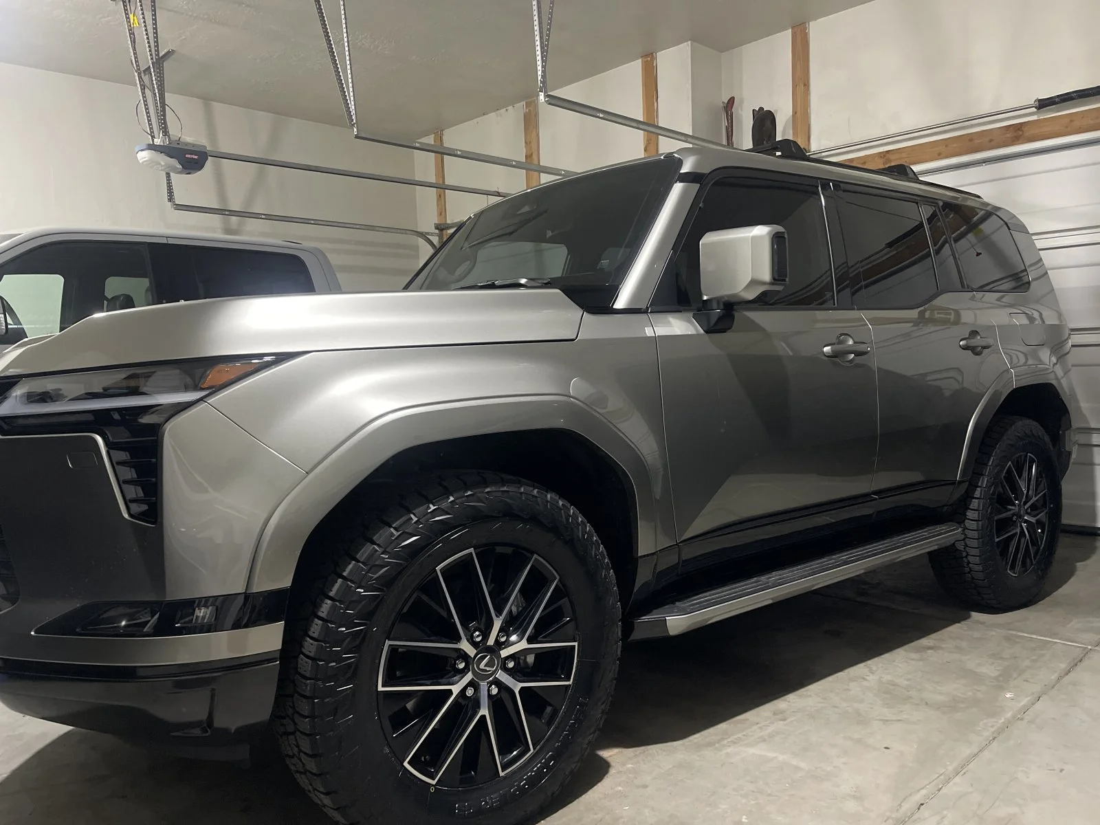

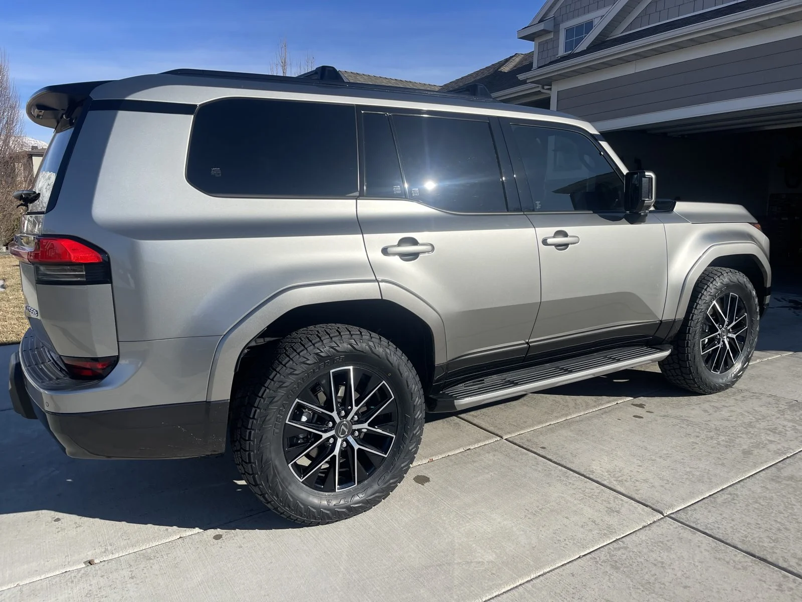

Just put 275/65/20 (34”x11”)Nitto G3 Terra Grappler on OEM 20” Wheels on my 24 GX550 Prem Plus in Atomic Silver. Looks sick, zero rub and rides and drives great. Could not be happier. You can’t go any wider of tire bc the OEM wheel is 7.5”. You need an 8” wide rim to do 285s.

Looks really nice @Brandonaeiou

Nice! I’m trying to decide whether to install 17” wheels and tires or just go with new Toyo AT3s for the OEM 20s. Everyone says 275/60/20 is the max size, but I saw your post where you installed 275/65/20s. Did you do that with stock suspension and no leveling kit?

I was going to do wheels too but decided I didn’t hate the stock wheels. My GX is completely stock suspension. No lift or leveling kit nor are there any mods to make the tires fit. They fit flawlessly w zero rub full turn and backing out of my driveway. Zero rub. I feel like you could do 35x11.50s fine and be completely stock suspension. Also I was gonna go w the Toyo AT3s as u had had them on my last truck and went w the Grappler g3 bc Discount tire said they were super quite and drive awesome. To which they do. Suppy happy w them so far.. had them for abt a month…

What psi are you running?
I put the same Nitto Terra G3 275/65R20 on my prem+ wheels. Discount had them at 40psi. Rough ride. I dropped to 35psi, but still feel like it could be a bit more supple.
And thank you giving me the confidence that they would fit. I know I would have wanted more tire had I used caution and went with 275/60 as that's what most forums/threads say are the max (without noting that the spare is the limiting factor). 34's fill out the wheel wells nicely.

I honestly think it would be close if you went w an offset wheel or spacers. Looks pretty close wheel the wheels are turned. Like less than an inch. It’s like 4” away when the wheels are straight. About an inch on the outside of the tire when they are turned in on either side next to the front bumper.

Yeah I run them a t 35 psi. Drives less choppy. Rides better now than w the stock 255s tho.
The stock 20's are a bit on the narrow side (7.5") so be aware of tire manufacture recommendations for fitment. For example, with Nitto Grapplers, the 275 XLs are approved for a 7.5" wheel, but the LT's are not.

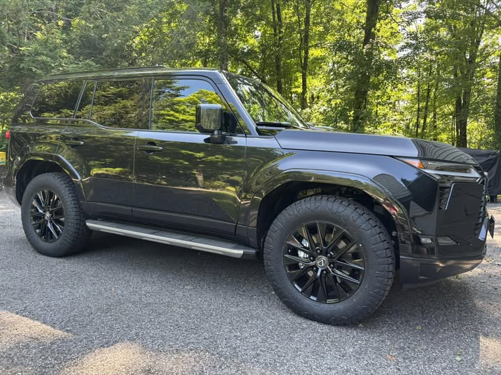

Thanks to a lot of the info from this forum. Powder coated the stock 20" Premium+ rims gloss black and added 275/65/20r SL Nitto Terra Grappler G3s. Gloss Black Silicone lug nut caps from Amazon and will be adding the upturn gloss/matte wheel cap tint to cover the chrome Lexus caps.
Looks really good!!! Love the powder coating blacked out wheels!!
