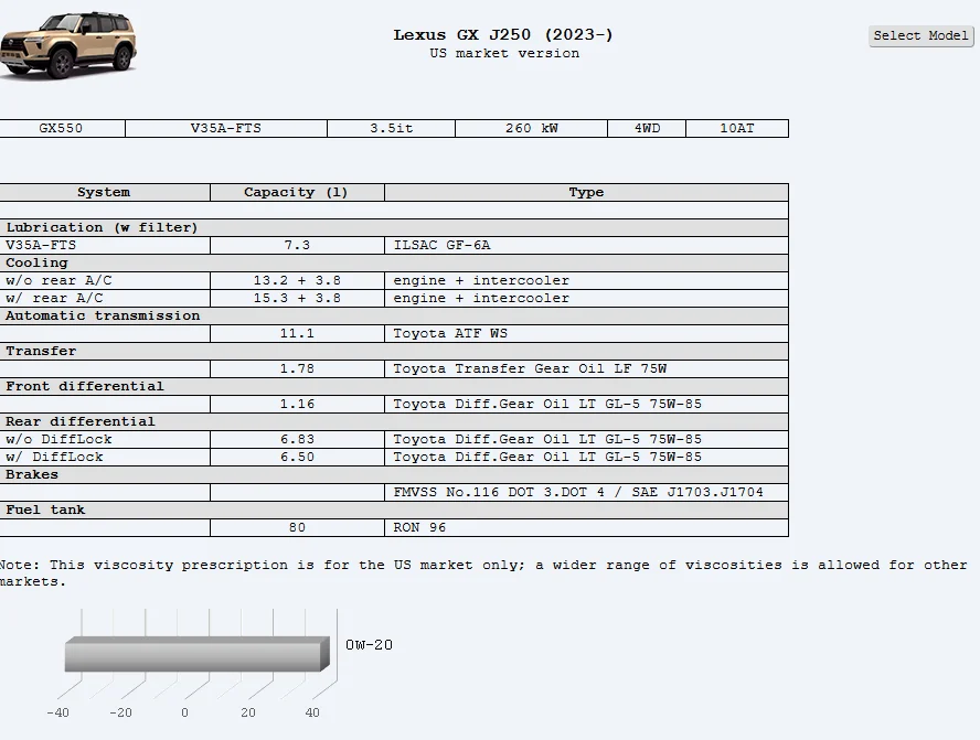

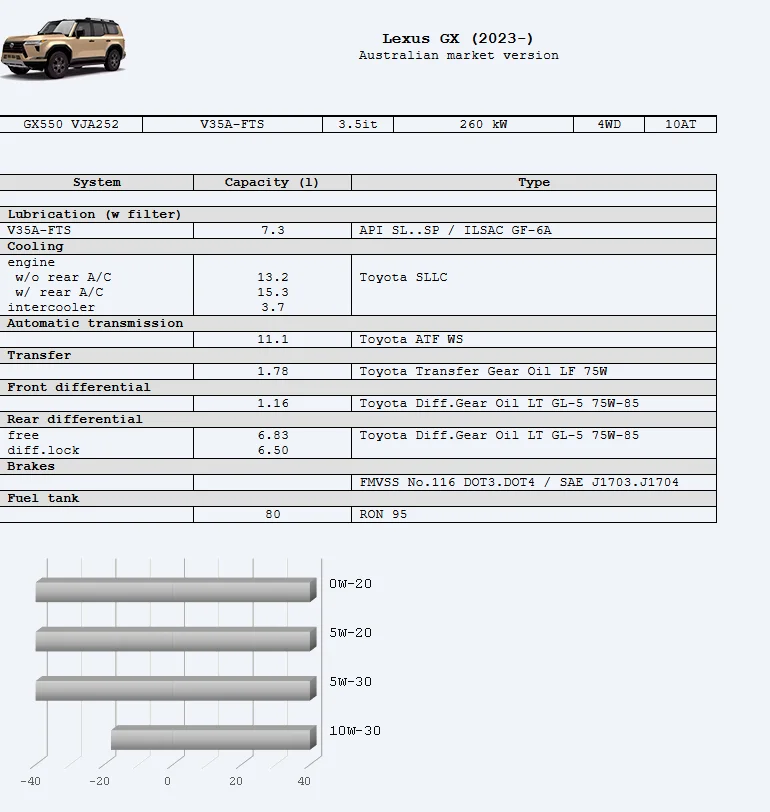

Here is some quick info I found online regarding US vs AU fluids.
US:
AU:

Thanks A10MileHusker. I found the 2025 USA Tundra and 2025 Australia GX owners manuals. These both listed 0W-20 as the recommend oil. The note, "This viscosity prescription is for the USA market only; a wider range of viscosities is allowed for other markets." suggest that 0W-20 is the balance point of fuel efficiency and protection. The AU alternatives are only a 30 weight oil, so the alternative recommendations are not a major swings in viscosity.

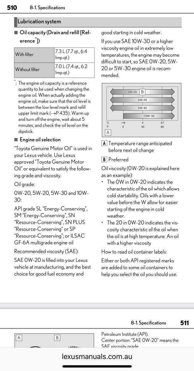

This is a page from the Lexus Australia GX 550 manual. 0w-20 is still the preferred oil but others are listed as optional. Maybe due to operating temps, fuel economy standards or oil availability.

@JoeRob the point of this thread is to know the range of oil specs for the V35A-FTS engine. All manufactures are specifying lighter weight oil in the USA in order to increase MPG ratings, include Toyota/Lexus. Toyota is pretty consistent with its 0W-20 recommendation for this engine, but the oil spec from Australia shows that higher weight oil is also within specs. Under normal operation, 0W-20 is the way to go. If operating with high torque needs, like frequent towing, a 30 weight oil may be a better choice. If operating in high temps, a 5W or 10W may be a better choice than 0W.
I mean you basically nailed it, except the number in front of the W only matters at low temps, not in high temps (inb4 shear stability and base stock arguments).
And I'd bet quite a lot of money there's no internal differences between USA and Australia's engines. The US has quite strict emissions & economy regulations so manufacturers always spec thinner oil in the US than elsewhere.
