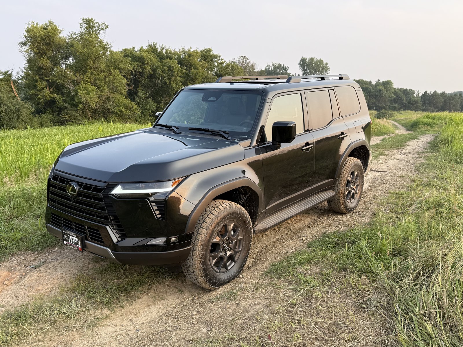

What are the Overtrail folks using for replacement tires? Same as factory or something else?

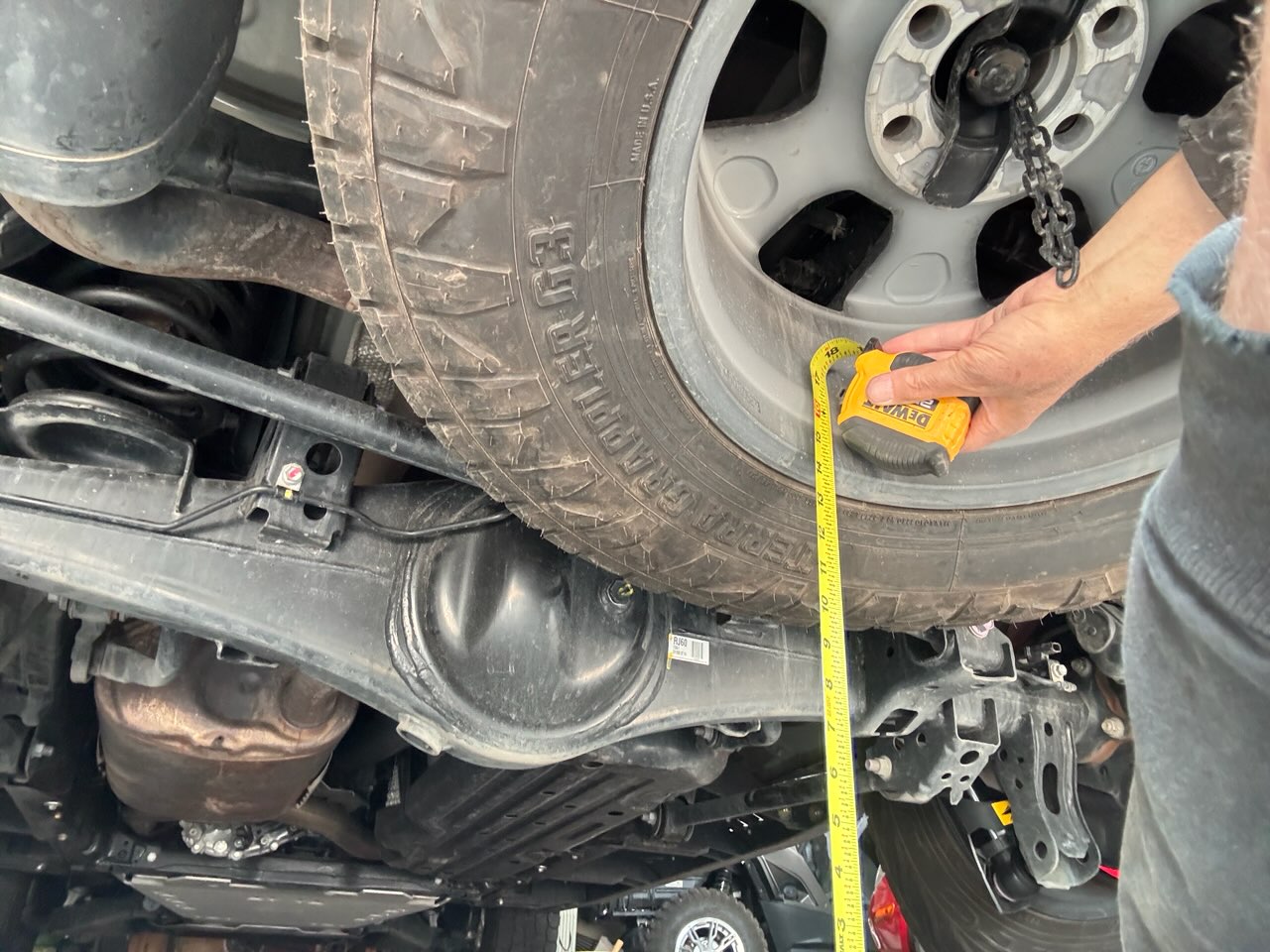

The issue becomes the spare.

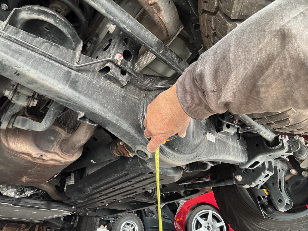

I recently installed the ARB/OME MT64 kit on my ‘24 OT. I’ve gained at least 2.25 or 2.5” clearance depending on where, how you measure (we left a small amount of rake to accommodate loads, towing etc). I don’t want to lose any of that new clearance compared to my current spare, a 275/70-18, 33.2, stated section width 11”.
After measuring before and after the lift, I’ve gained the 2.25 to 2.5” right at the thickest (section width) forward portion of the current spare just behind the diff. Prior to the lift the spare was maybe, barely a half-inch taller than the diff. Now, after good measurements, the current spare is at 12” and the diff sits at 9” to the ground. (On the back side of the spare behind the hitch receiver opening..I now have 17” of clearance, which I’m comfortable with).

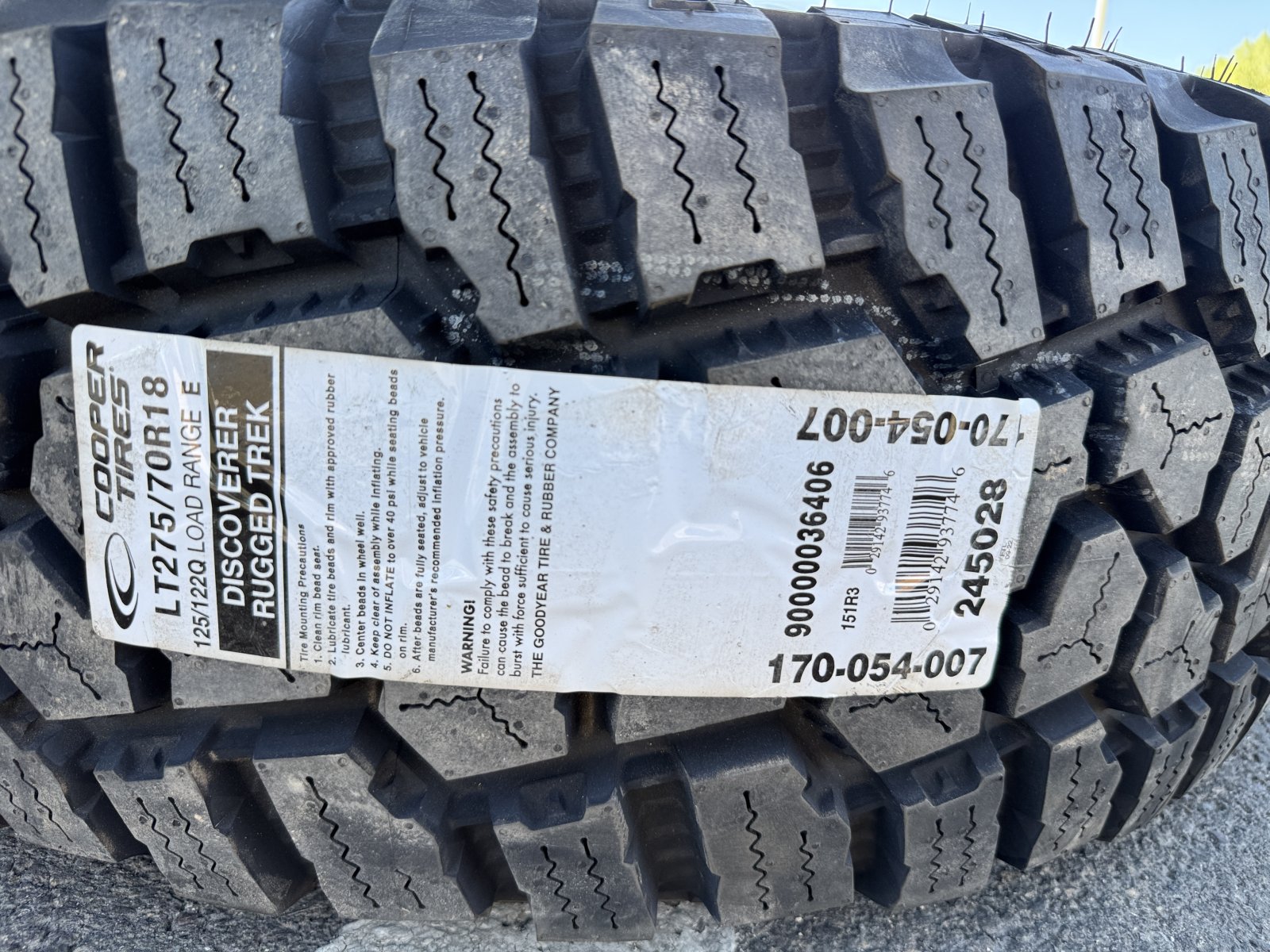

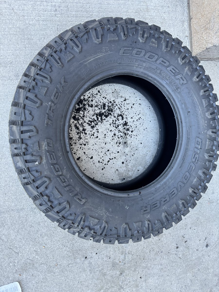

So I looked around for a new ‘tall enough’ 275/70-18, with a similar low section width to my current spare, so I can keep the new clearance.

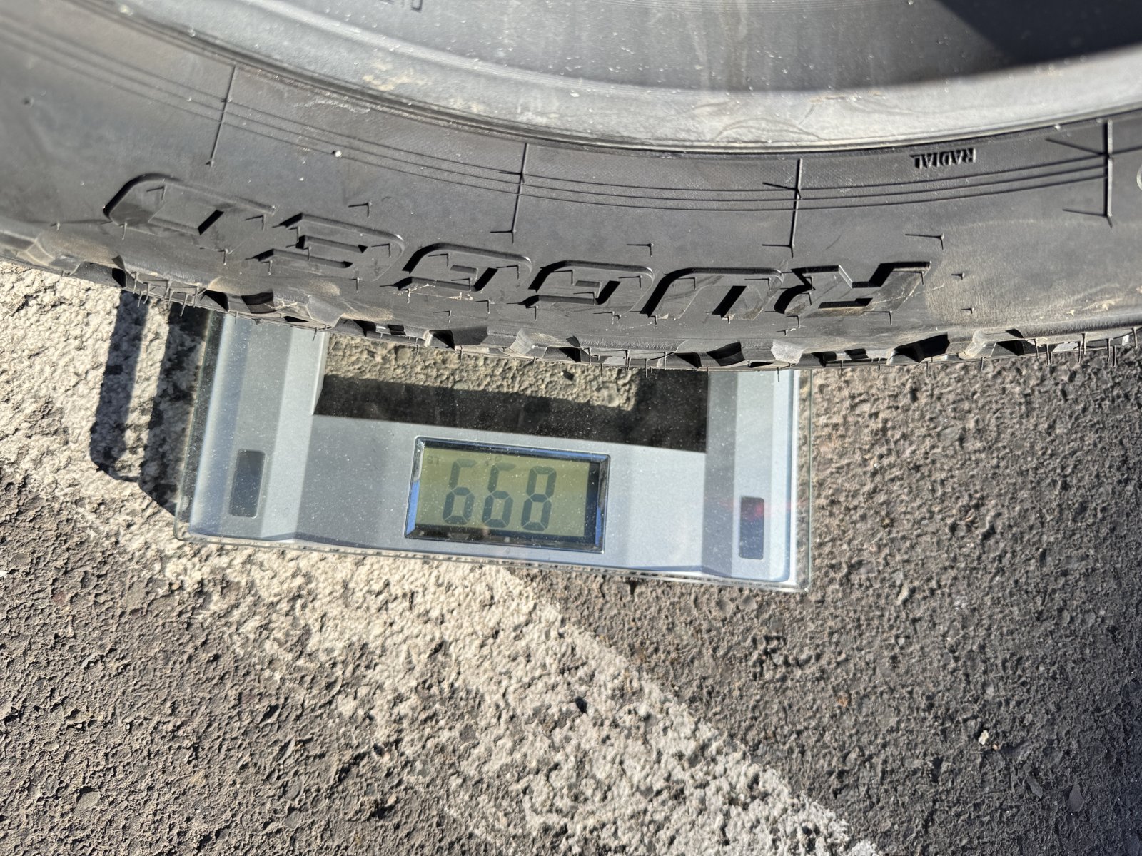

That led me to the Cooper Discovery Rugged Trek 275/70-18, load E, stated 33.7” (both mfr website and Tire Rack), stated section width 11.1”.
I’ve ordered one in, and will be able to try the spare fit very soon. I’ll try and measure it both before and after mounting it onto the OEM OT wheel. If the specs are pretty accurate…then it appears it will fit (after inspecting underneath the spare again..); giving me the 33.7” to match the 4 new Toyos, and a 11.1” section width to basically match my current spare. And hopefully retaining the new clearance.
These post-lift attached pics have really bad camera distortion. The actual numbers are as stated above.

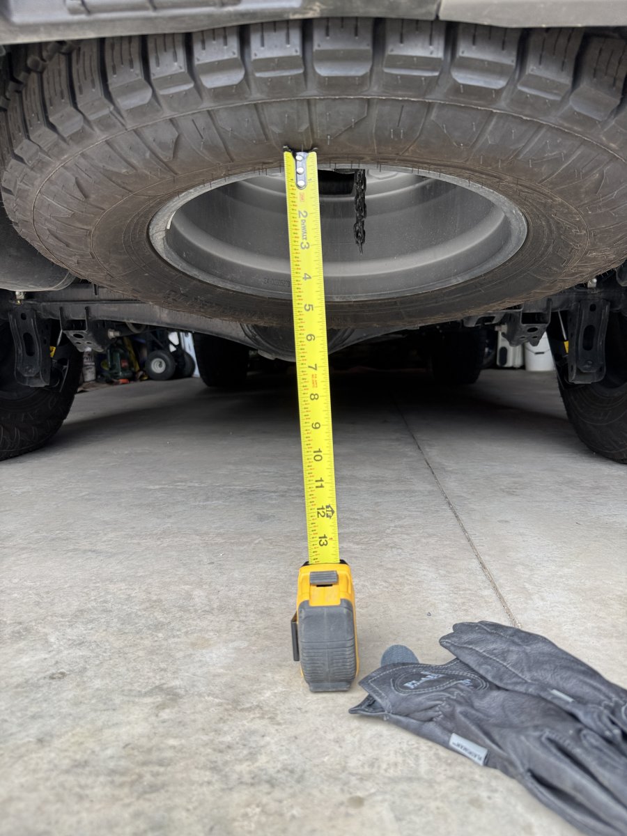

UPDATE, 8-20-25:
I just tried out the new Cooper E rated spare tire this morning. It fits like a charm, just barely 😅. 34psi, mounted on the OT OE wheel.
I measured again with it mounted up in the spare location, and I’ve retained the same current clearance: 12” at front thickest portion (just behind the diff), and over 17” at the rear (just in front of the hitch receiver opening). And the mounted inflated diameter appears to be within .1 or .2 of the websites numbers. Yay!
So I went ahead and ordered the 4 Toyo 285/70R18 mains and wheels. ETA is mid next week. Will see how well those fit. 🤞
I’m attaching a few pics of the new spare.

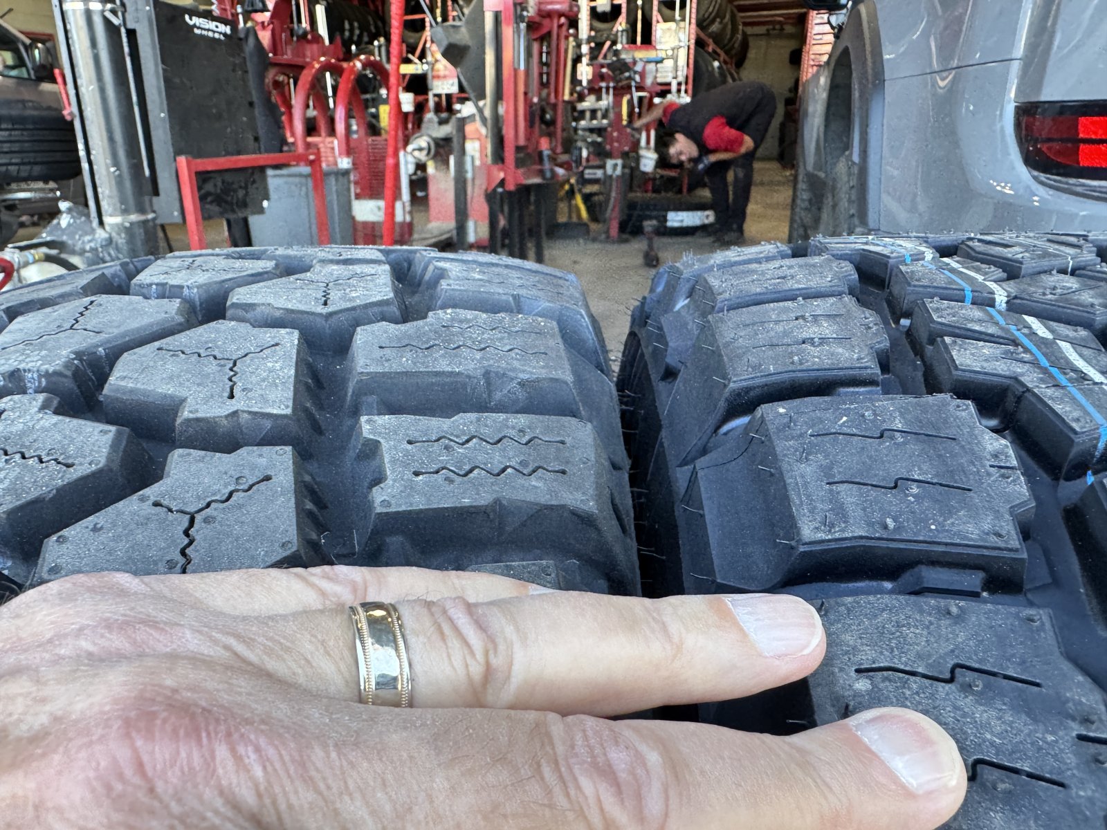

As I described above I’m using a spare (Cooper Discoverer RT 275/70R18, E rated, 33.7”, section width 11.1”) mounted on the Overtrail OE wheel. It fits perfect in the spare location very snugly, it is no thicker than what I used there previously - I have not lost any of my new found lift clearance in that area - and it matches the diameter of the 4 new main tires, the Toyo 285/70-R18 E rated AT3s, which are also 33.6 or 33.7 diameter. (the Toyo being a ‘shy’ 34” tire)

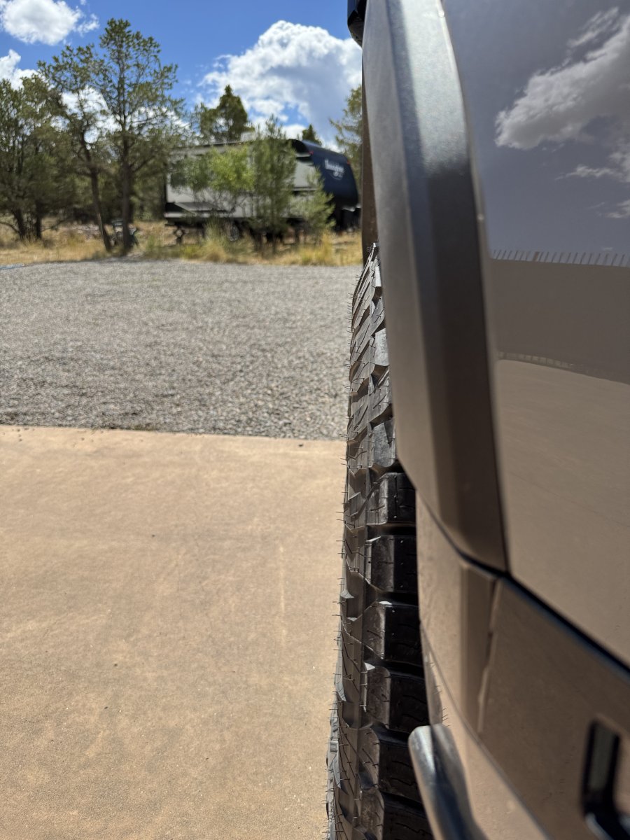

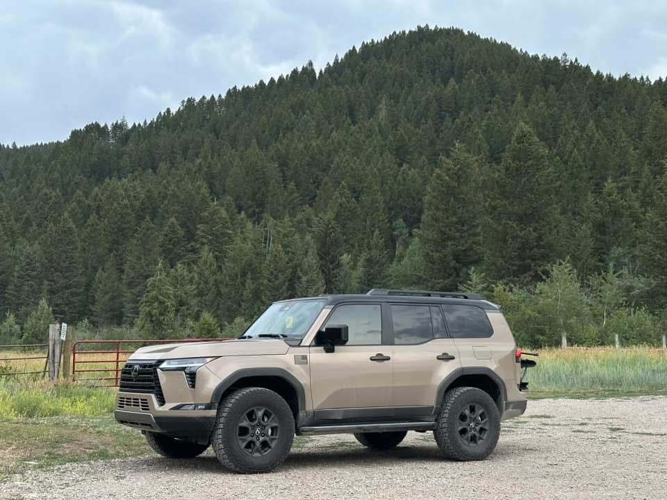

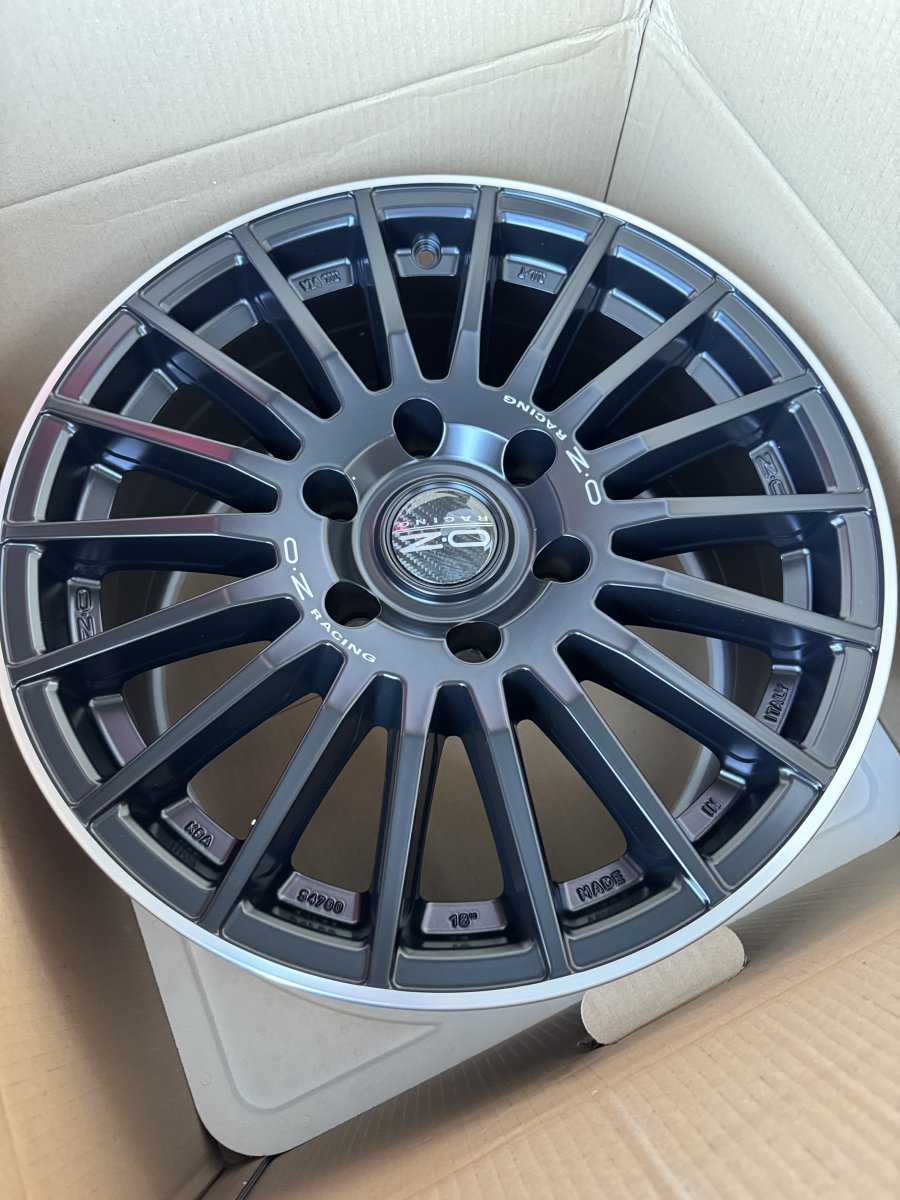

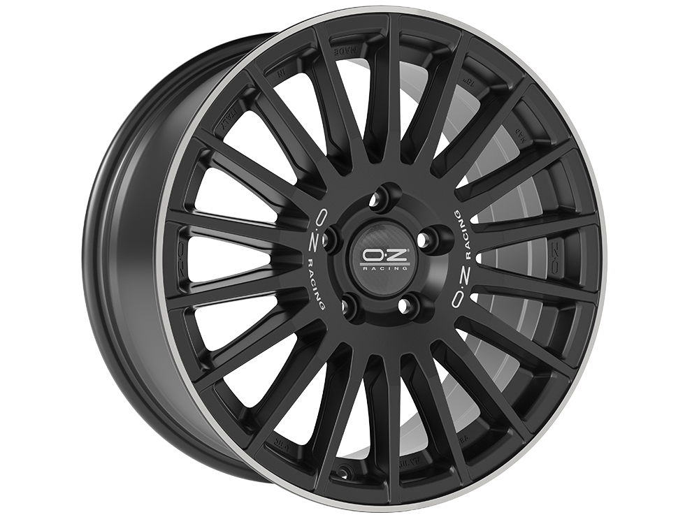

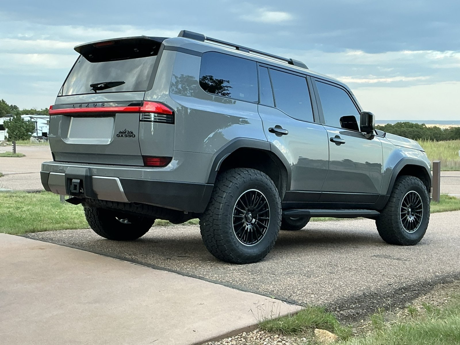

The new tires (AT3s) on the new wheels (OZ Rally Desert 18x8 +25) with the new lift kit just barely fit without rubbing, no trimming of anything necessary. I wanted to stay with an 18” wheel, I wanted a small amount of poke (track increase for additional towing lateral stability) and Slee Offroad (who installed my ARB/OME MT64 lift) recommended an offset of 25.
The new wheels, which I really like, simply will not be desirable for most people as they are relatively heavy…and I don’t believe they come in lighter 17” sizes. The quality seems quite high, and I really like the look. I originally looked at various forged like Rays, I looked at Icons, etc. I stumbled across the OZs and now enjoy the very thin outer ribbon of silver visually separating the rest of the wheel from the black tire wall. It works well with the Incognito color IMO. They look way, way better in person than in pictures. The new Toyos are lighter than most other same size choices..so that helps a bit I guess. The TPMS all transferred without issue.

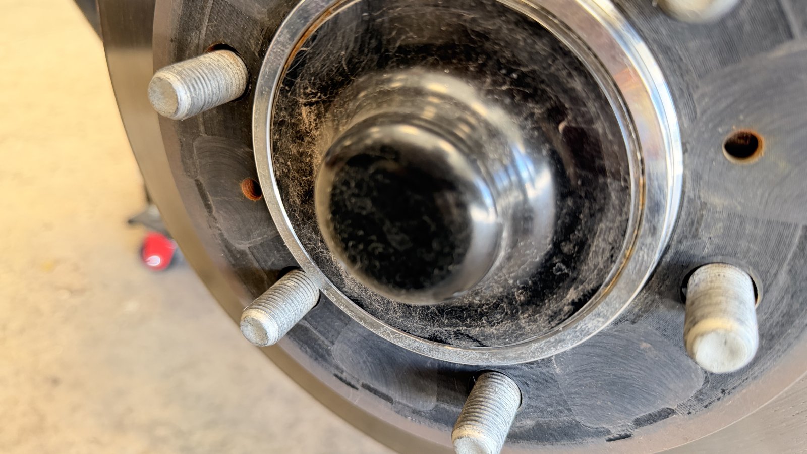

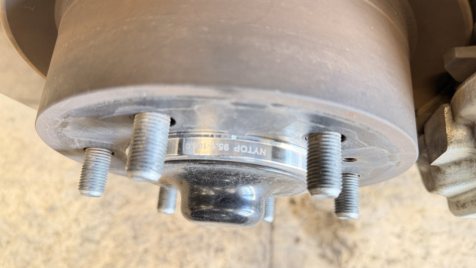

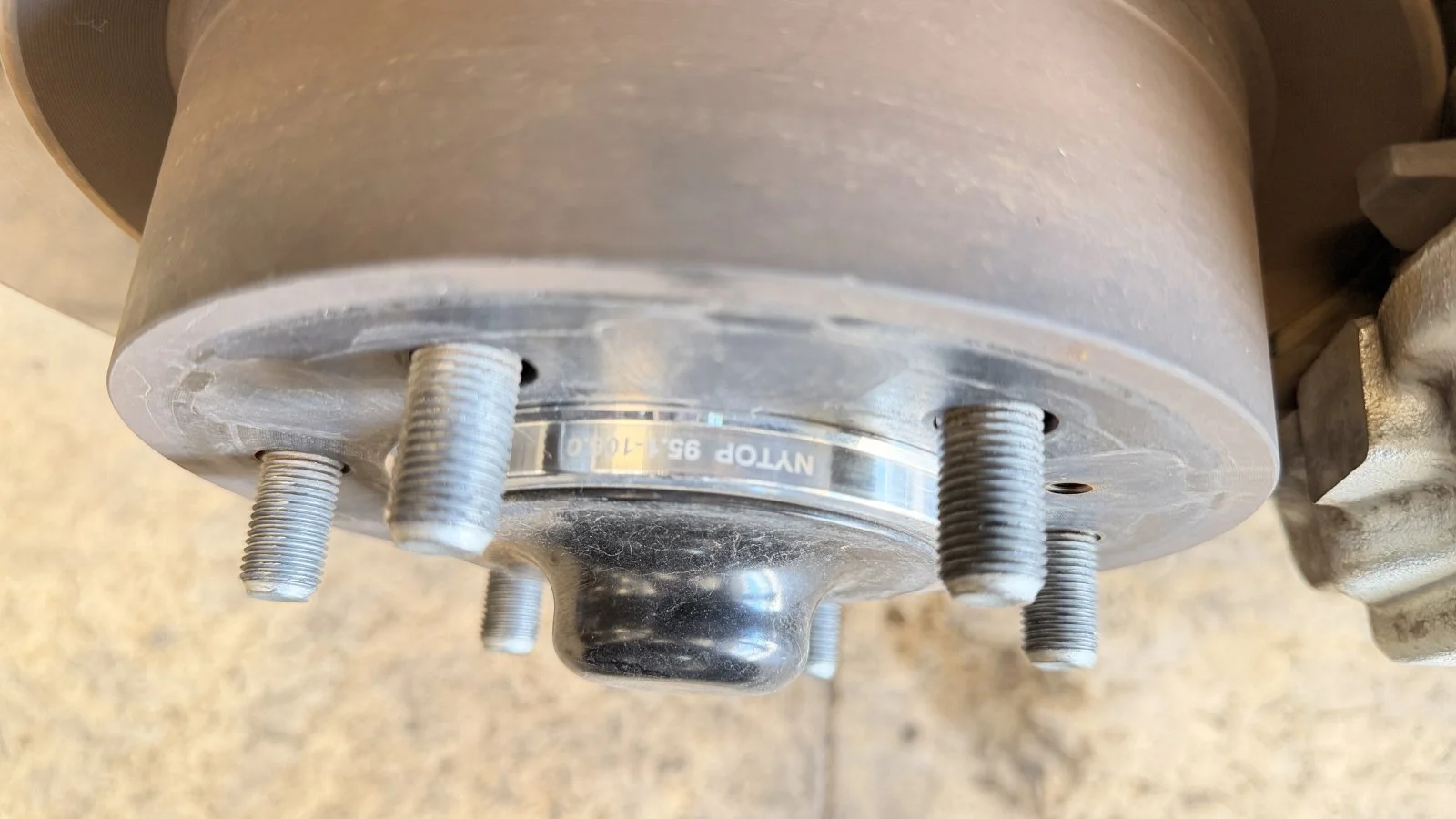

I ordered some metal hub rings from NYTOP and they are really nice; my best measurements with the micrometer showed them perfect.
I just had them installed at Les Schwab today for free (easy to do yourself though). They fit perfect onto the GX 95.1 hub. And we double checked how many full hand turns the new lug nuts engage onto the studs, it’s about 10, so I think I’m good there. I’m still randomly checking the lug nuts for correct tightness.
I’m running the new E rated AT3s at about 31 psi cold for local and regional driving, which with the new suspension, keeps everything really nice, compliant, but still very much under control. I have used 50 psi for towing a couple weeks ago, it worked great.
You should note that those E rated Toyos are not as quiet as my previous, softer Nitto TG G3s 275/70R18. I really liked those and can highly recommend them if you’re not towing relatively heavy or doing anything extreme. They are quiet and handled really well.
I really like the small amount of poke I gained.
This Cooper spare, a ‘tall’ 275/70R18, just barely fits up underneath - no wasted space!

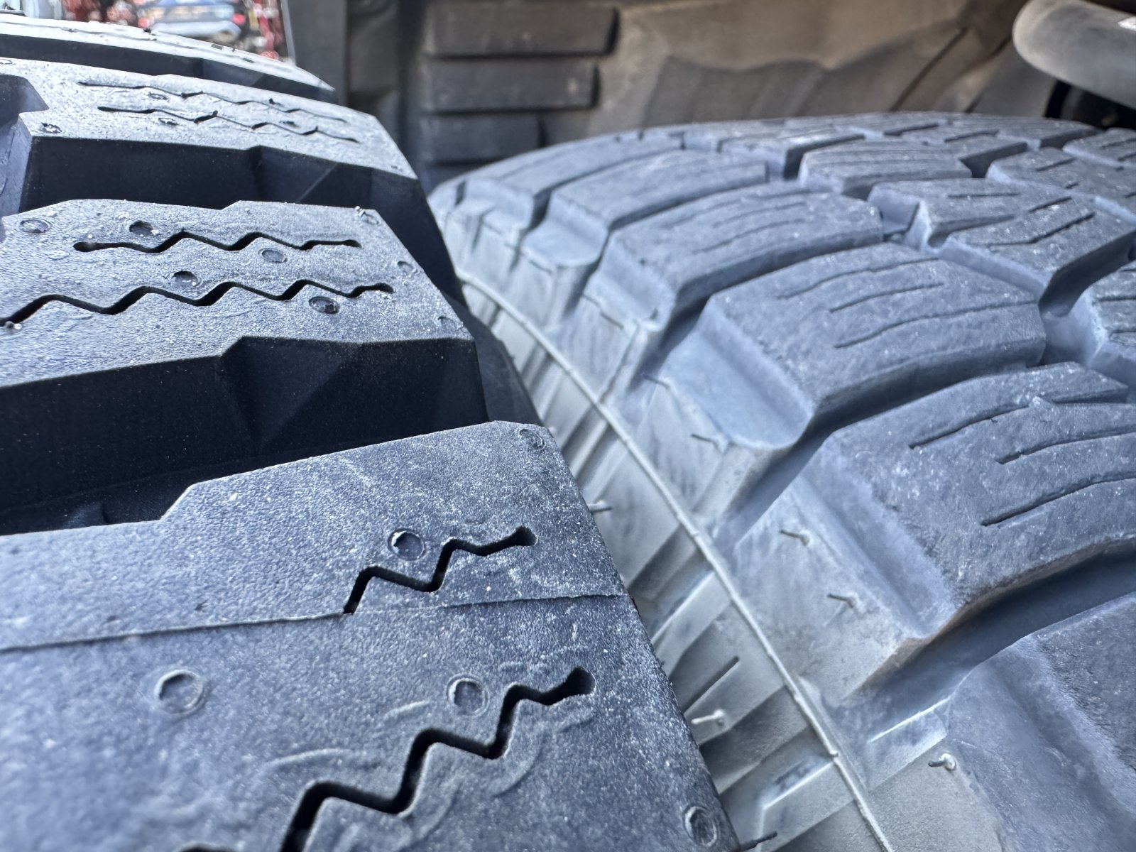

Cooper left, Toyo on right. Same height…but the Cooper spare has a narrower section width, so I didn’t give up any clearance.
The NYTOP hub rings installed today.
