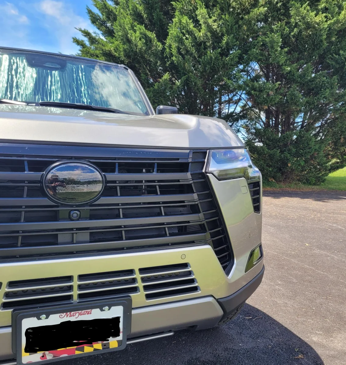

I finally got around to installing the Lamin X film on my front lights. It worked out good enough for me and I'm happy with it. The fogs and turn lights super easy. On the headlights I lined up the long lines on the top and moved into place starting at edges, wetting the surface and using the plastic card they gave to smooth out as I moved downwards to the curves. Trimming of edges is needed, and I found out a flexible plastic ruler works good to trim straight lines. There's a few bubbles and small moisture pockets that go away after a couple weeks. I don't have OCD on minutia details and like this as a cheap way to prevent gravel chips and the sandblasting decay of driving from these headlights, and the film will last for 5-7 years. Hey YellowLab I called Jeff at Lamin X (his contact on their website) and got an easy custom order to get their film covers for the M&R Automotive 30-inch light bar bulbs. I ordered thirty 11/16- inch circles to place over the light bar bulbs (there are 28 bulbs but always get a couple extra). I actually got the Charcoal tint for my Amber bar and works great. In case you want to protect the bulbs on your light bar, this costs about $25. To avoid touching the film adhesive I used a tiny screwdriver to help place the small circle film pieces on to the light bar bulbs, and you can see the light bar below.How did your install go - my fog and turn lights were a no brainer. I tried the drivers front light and with the contours it did not line up at all where the light turns into the quarter panel. There is almost no way I could get it to lay flat given the different angles and edge on the lights. Was not going to play with cutting the film. Was like the 3rd layer of hell...I gave up after 30 mins.
That looks really great! I could not get the headlights to work at all - did not have the patience to do them. Had not thought about covering the light bars - great idea on that.I finally got around to installing the Lamin X film on my front lights. It worked out good enough for me and I'm happy with it. The fogs and turn lights super easy. On the headlights I lined up the long lines on the top and moved into place starting at edges, wetting the surface and using the plastic card they gave to smooth out as I moved downwards to the curves. Trimming of edges is needed, and I found out a flexible plastic ruler works good to trim straight lines. There's a few bubbles and small moisture pockets that go away after a couple weeks. I don't have OCD on minutia details and like this as a cheap way to prevent gravel chips and the sandblasting decay of driving from these headlights, and the film will last for 5-7 years. Hey YellowLab I called Jeff at Lamin X (his contact on their website) and got an easy custom order to get their film covers for the M&R Automotive 30-inch light bar bulbs. I ordered thirty 11/16- inch circles to place over the light bar bulbs (there are 28 bulbs but always get a couple extra). I actually got the Charcoal tint for my Amber bar and works great. In case you want to protect the bulbs on your light bar, this costs about $25. To avoid touching the film adhesive I used a tiny screwdriver to help place the small circle film pieces on to the light bar bulbs, and you can see the light bar below.
