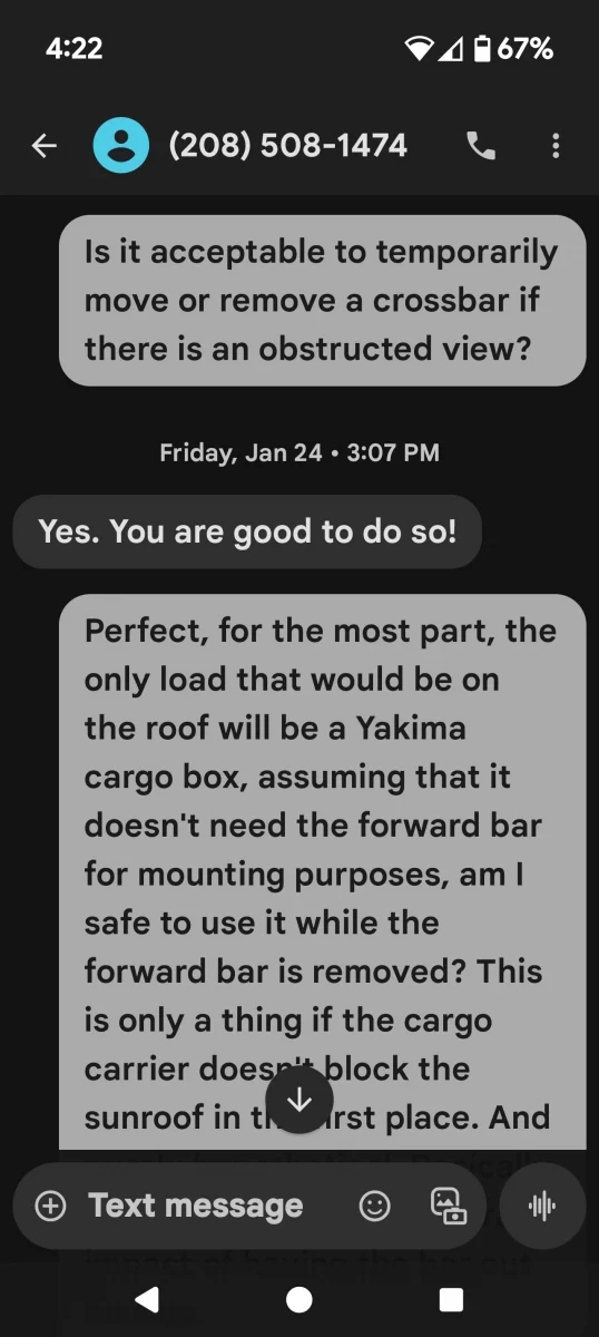

I did, in fact they said I could remove two bars as long as I did not need them for weight support. I just ran a rooftop box from Oregon to Canada and back and had zero issues whatsoever. If you remove just one, you will still have one partially in your view.
