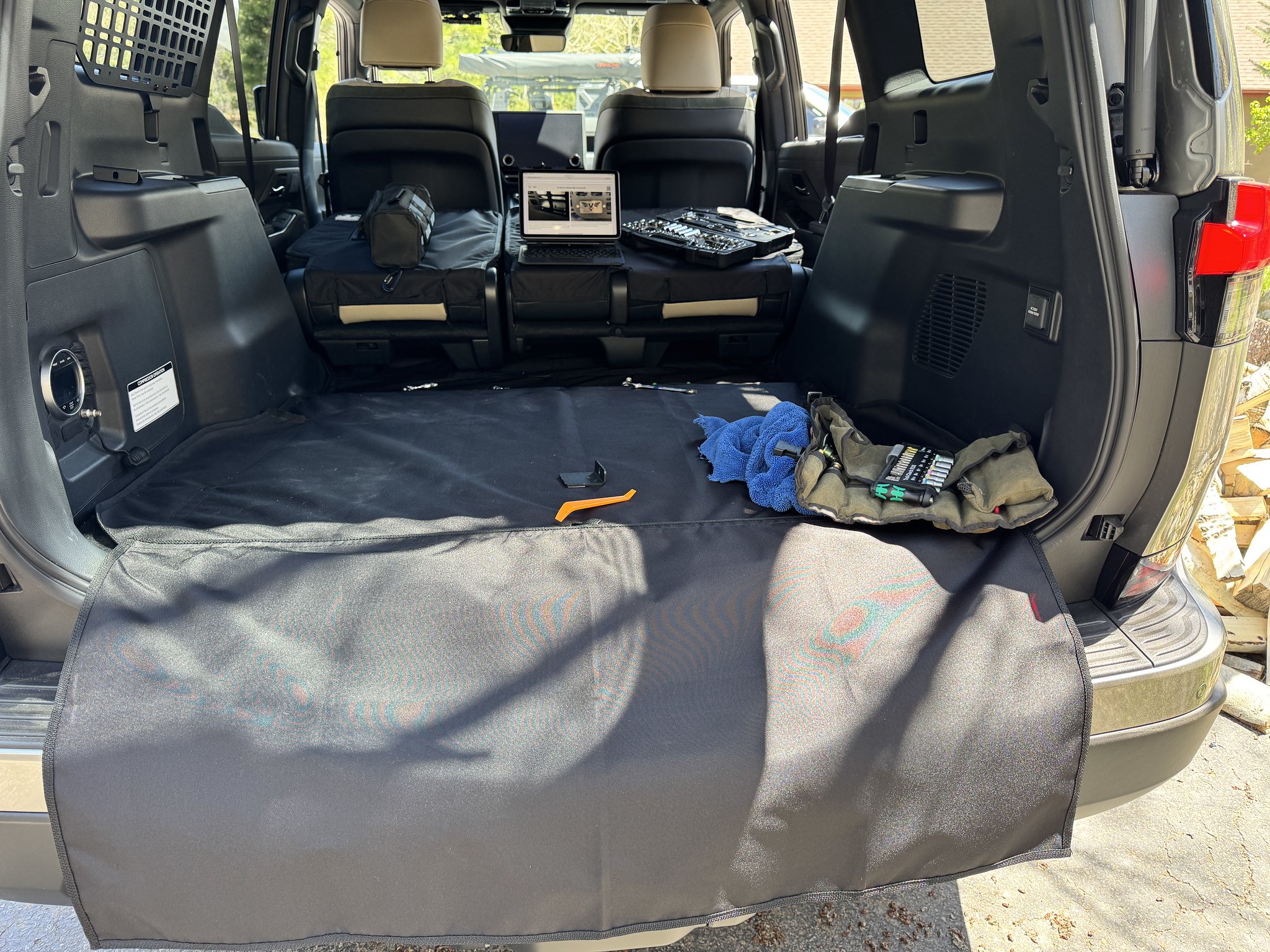

As soon as I got it back, I put the Canvasback rear liners in (including the nifty bumper protection piece this time). Huge fan of their product and company.

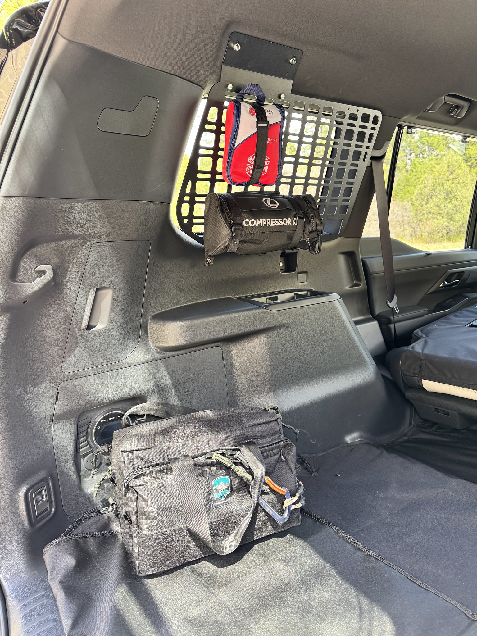

Next tried to install Victory rear window MOLLE panels. They sent some of the wrong brackets and hardware, but I still got them in place for now. I think they'll add some welcome additional gear storage options.

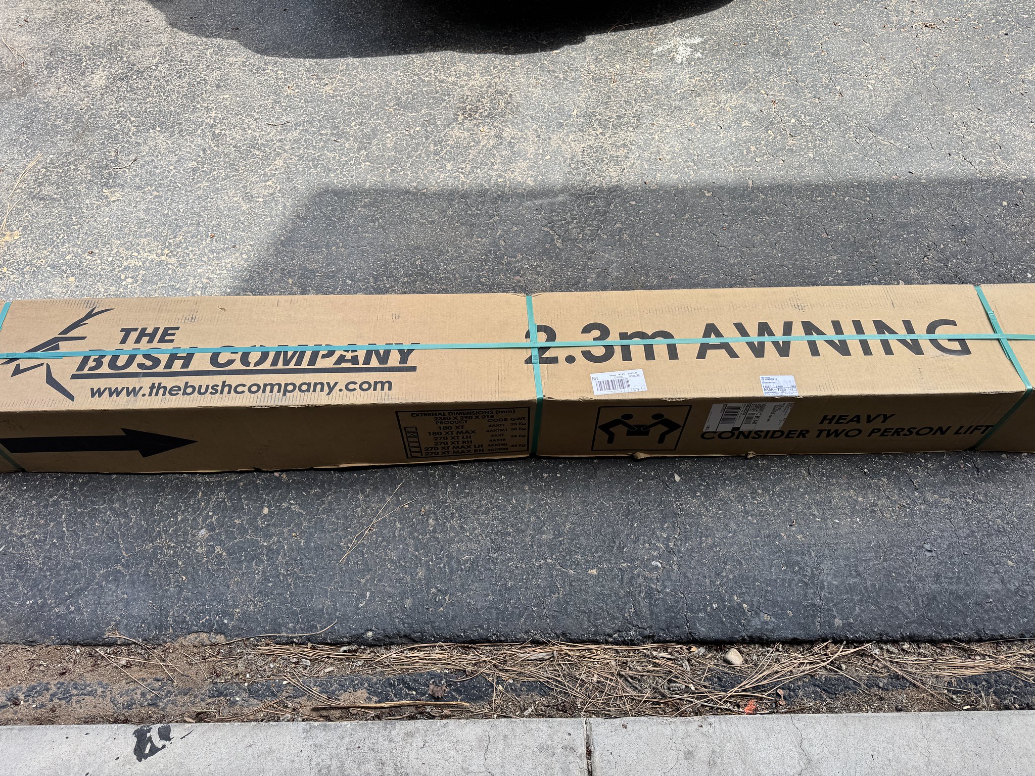

Next is the awning. But I need a few extra hands, and the massive Bush Company brackets don't appear to be easily compatible with the Sherpa rack. If anyone has any guidance here, I'd appreciate it.

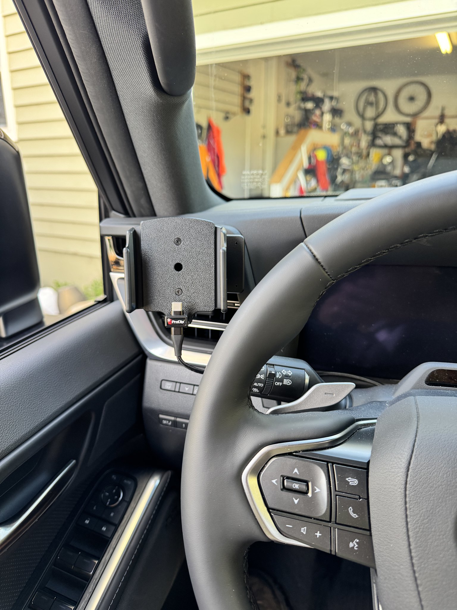

Here's a look at the ProClip charging phone mount. There may be a better option for me down the road, but I wanted to de-clutter the area around the cup hodelrs and lighter and wanted the phone higher up, so this was the best I could find.
I thought having the phone on the left would be weird, but I like it.

Next tried to install Victory rear window MOLLE panels. They sent some of the wrong brackets and hardware, but I still got them in place for now. I think they will add some welcome additional gear storage options.
FYI on the panel install, I'd suggest not following their instructions, and loosely attaching at least the upper bracket to the panel before attaching the bracket to the vehicle. Trying to get the lock nuts onto the bolts behind the panel and tightening them forever with the brackets already installed was ridiculous. For the second panel I also loosely attached the bracket that uses the 3M tape before mounting. The bottom bracket isn't too much of a pain in the ass so I loosely mounted that one to the vehicle first as the instructions prescribe.

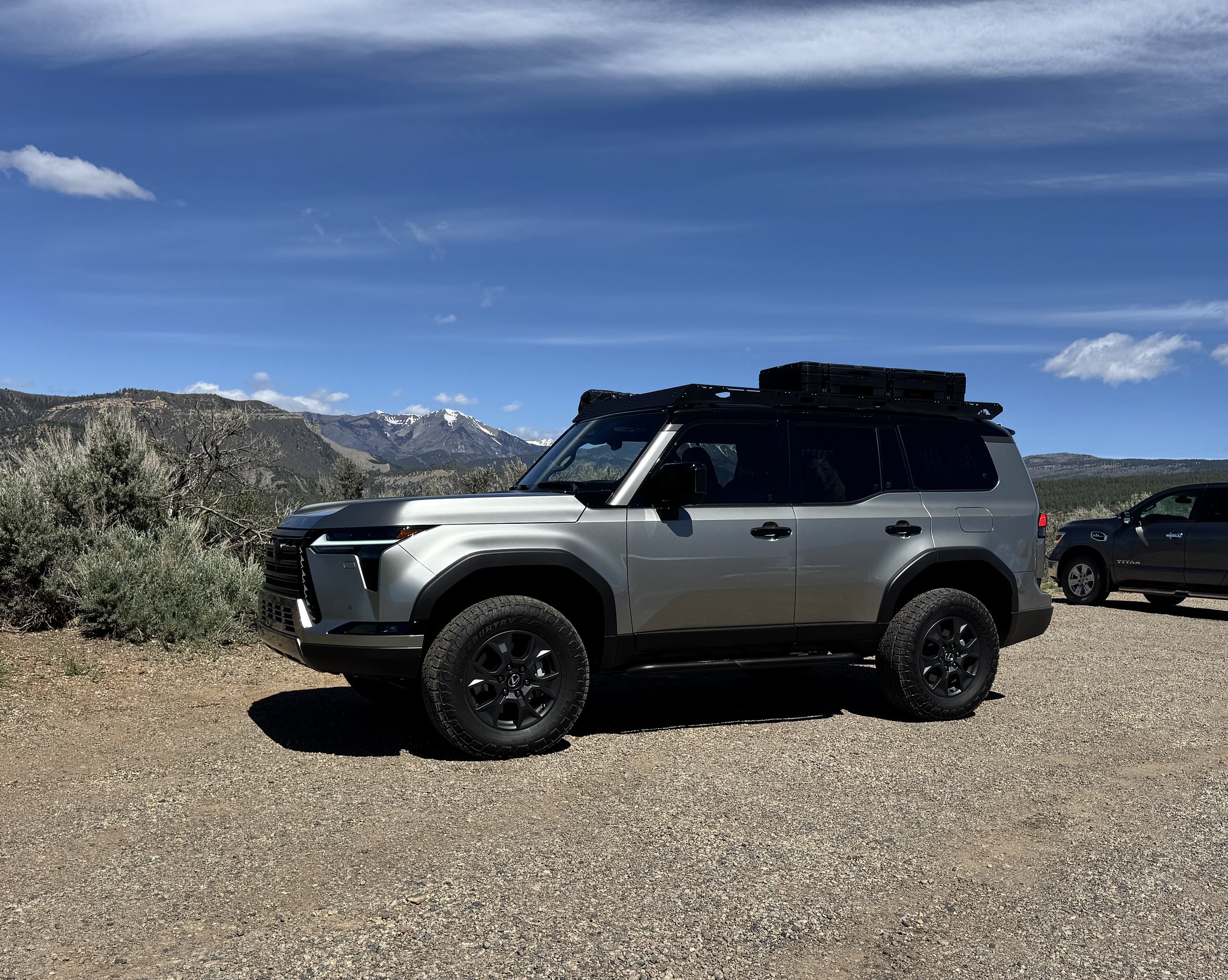

Updated pic with the Peak levling kit installed and the new cargo box and awning mounted.
Measurements from center of hubs to bottom edge of wheel arches with the spacer leveling kit:
Front = 22.5 in.
Rear = 23.0
Is that the Peak kit that adds about 1.25” of lift, or did you stick with just leveling the front on your ‘25 model? I’ve been talking with them about options for my 2024 OT. Did you use an installer in Durango?
Just the front - this spacer kit https://www.peaksuspension.com/product/2024-lexusgx550-1-25-lift-kit/
