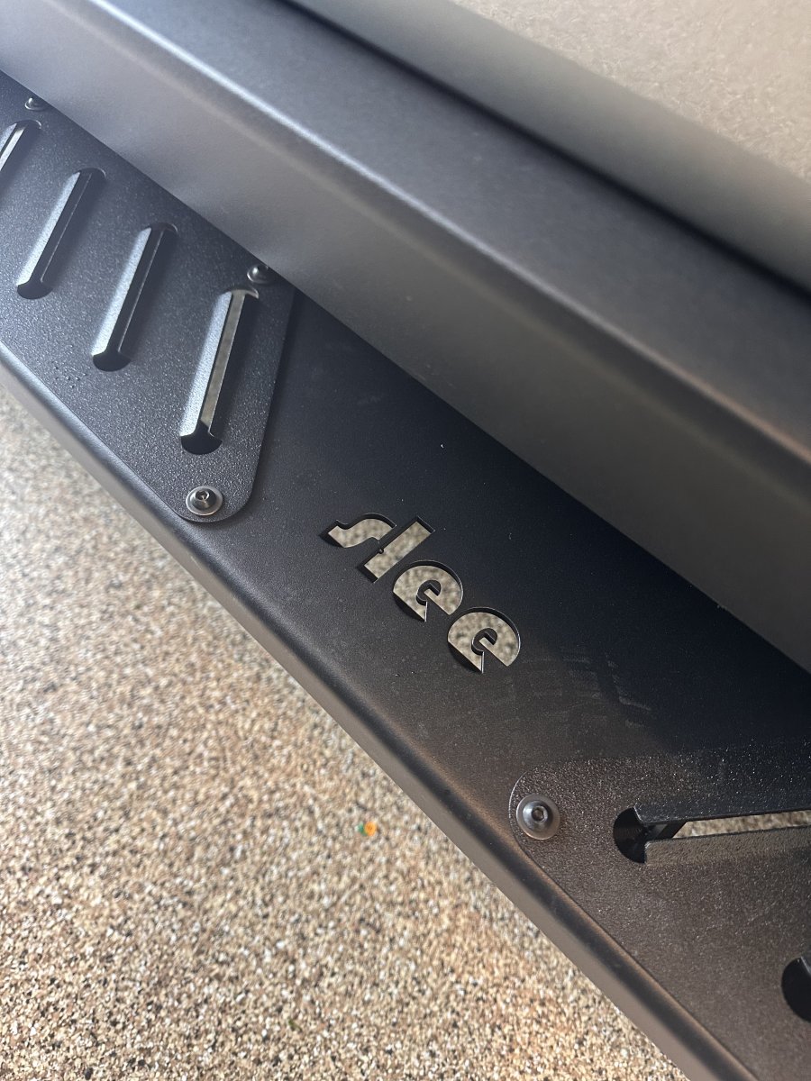

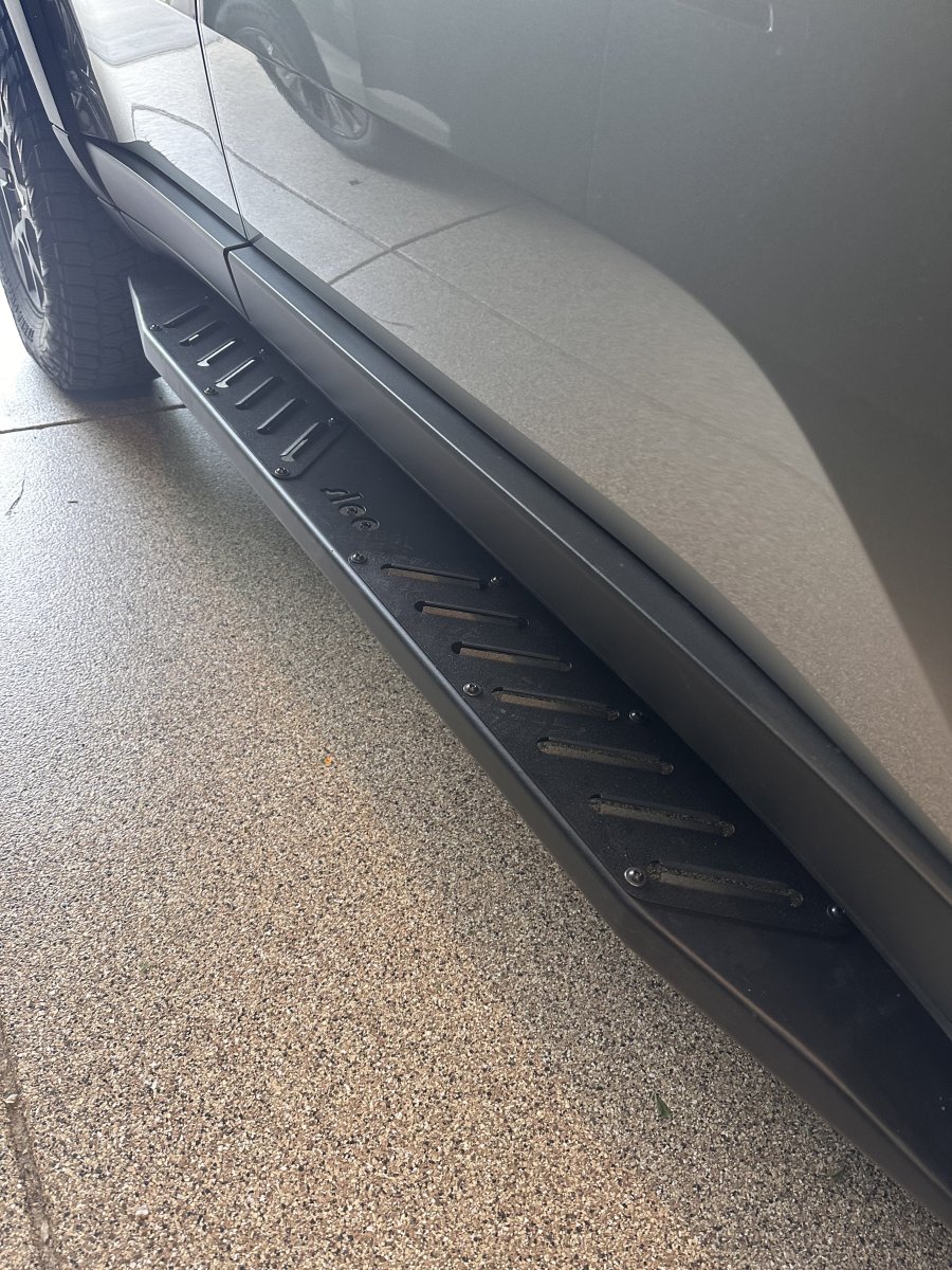

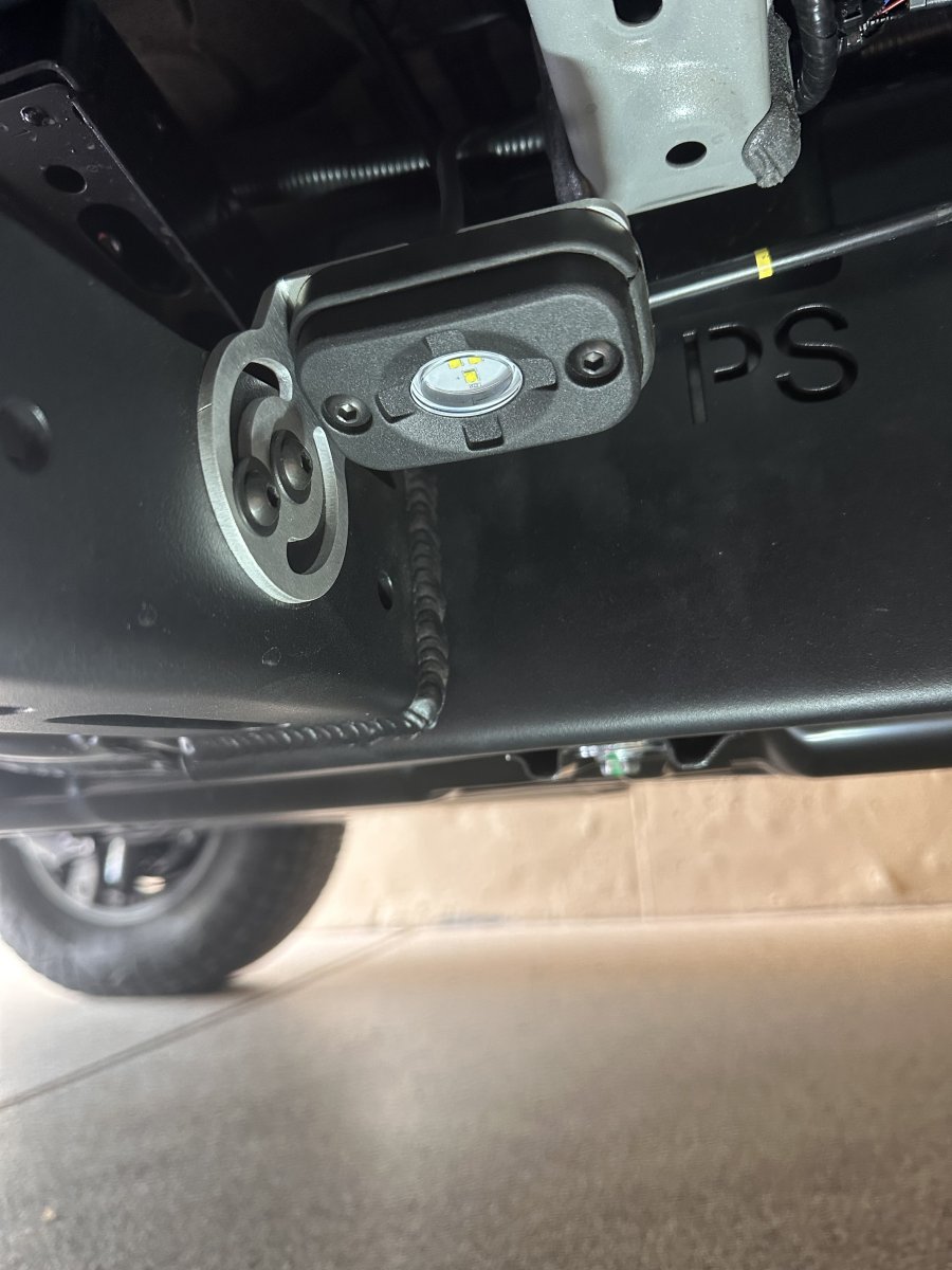

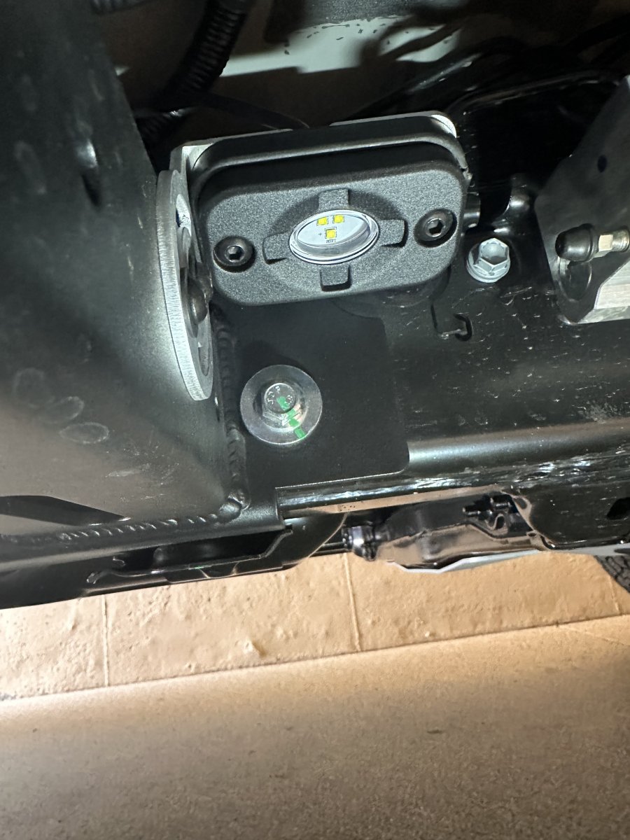

A few pics of the Slee rock sliders with optional lights. Slee did the install as I was a bit too lazy! Really like their stuff and great crew in Golden.
Look really good. Outside of the use as a step how robust are these sliders when crashing down on rocks? Also, did you lose any clearance after install?
The sliders certainly seem like they are up to the task but have not been tested yet! No lost clearance.

Boards and lights were retail price as on their website and install was $500. So a lot can be saved if you install but they did a cleaner install on the lights that I ever would have done and for me no hassle and time spent under the truck was worth it. Highly recommend.

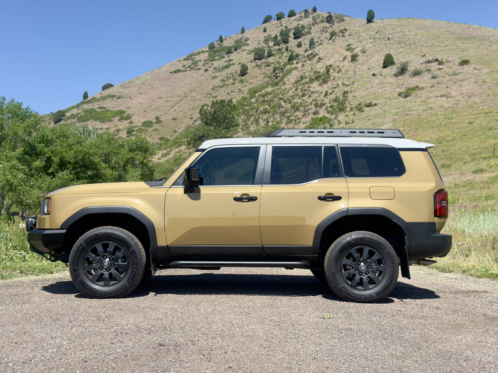

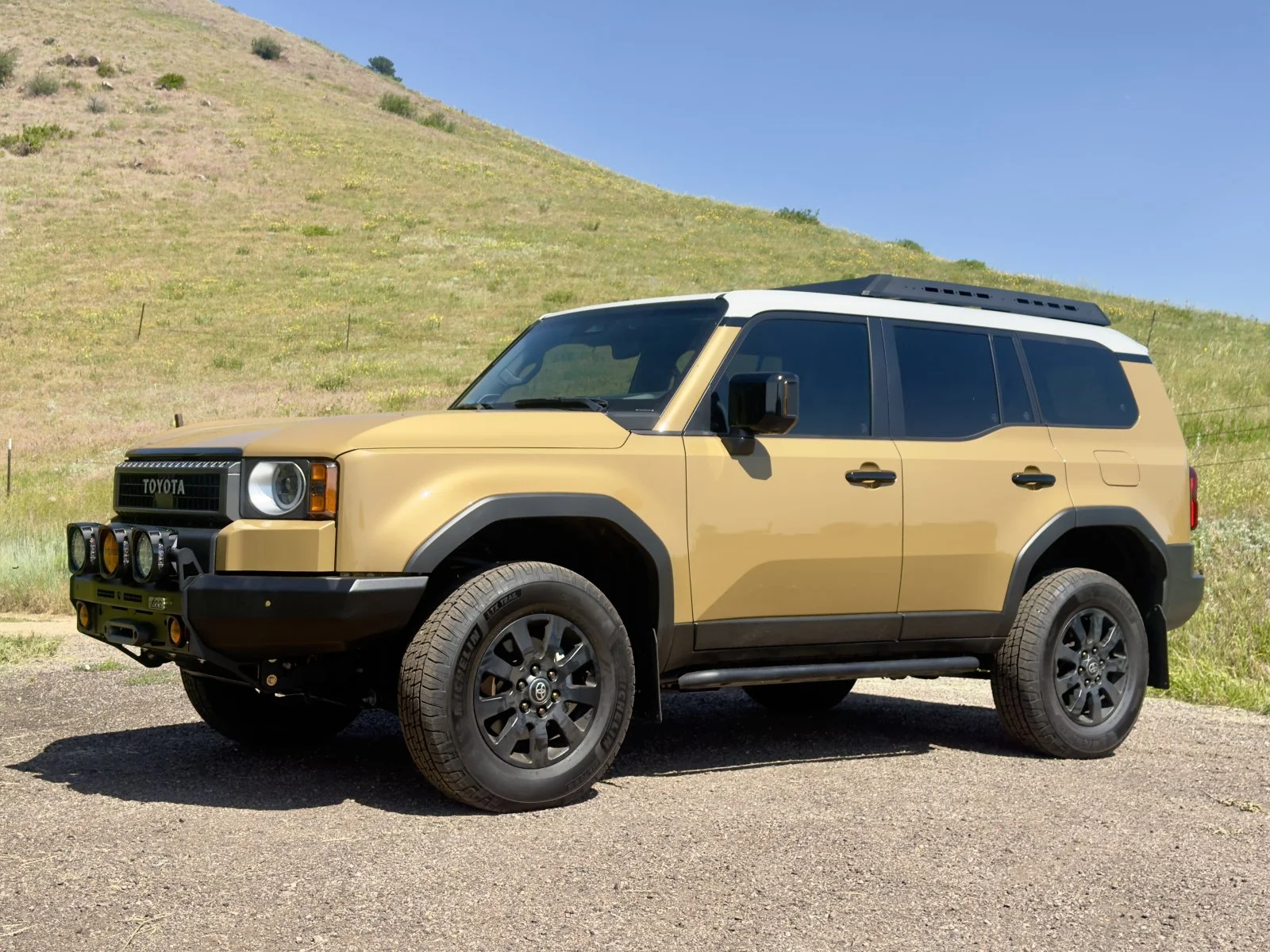

They gave me a couple pics of a client LC they just finished so I’d have an idea. It has a heavier, non-stock front bumper. They dialed in the front to leave a very small amount of rake for heavier loads on the rear. I’m not sure of the exact trim of that LC 250, and, in the pics it still had the OE wheel set. I cannot get to the pics right now 🫤, but the resulting lift looks perfect for what I’m trying to do. Plus, I hope to improve the ride over stock..more on all of that later.
Happy July 4th weekend to all! 🍻
EDIT: Here is the LC that Slee finished a couple weeks ago, still on the OE 18” wheels and tires.

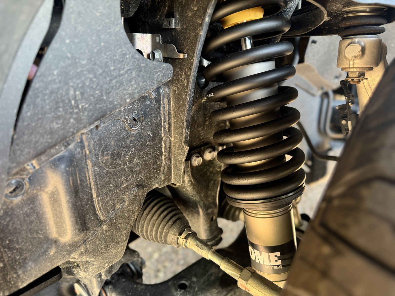

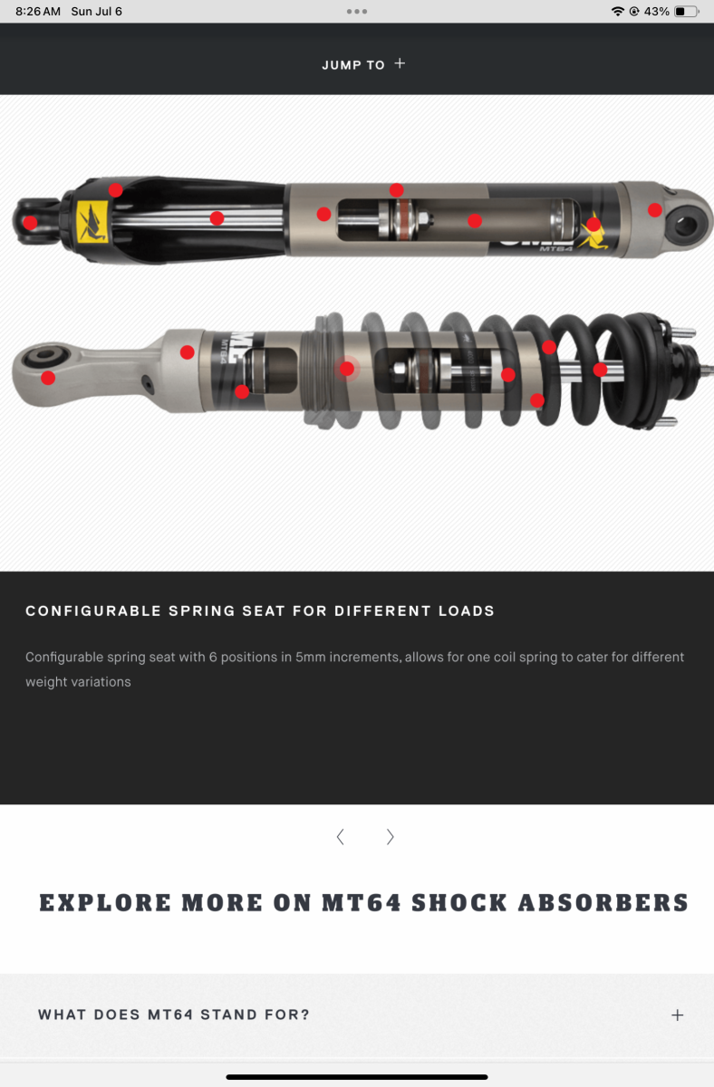

EDIT 2: Bill, I failed to notice the front coil-over picture post-install. You can clearly see they used the 3rd or 4th setting to accommodate the heavier than stock front end. Seems to work well. I don’t know if the owner chose to keep the OE UCAs or upgraded, or which rear springs were used.
I’m also curious to know what the stock weight of this particular LC250 trim is; I never researched the new LC, maybe you have?

Can confirm they are not just a step. They are made from the same HSLA and forming methods as the LX570/200 steps that have endured the Rubicon and many of the more difficult trails in Moab, etc. You do sacrifice a bit of clearance for the added protection and a step as is the case with most sliders that function as a step. For perspective I would not consider the factory offered rock rails as a functional step.
I have tested the similar Slee rock sliders on my 200 Series Land Cruiser and they are legit, taking the full weight of the vehicle. I'm confident Slee has designed and tested them to provide the function and form we're looking for. I will be installing these on my GX550. No worries.
