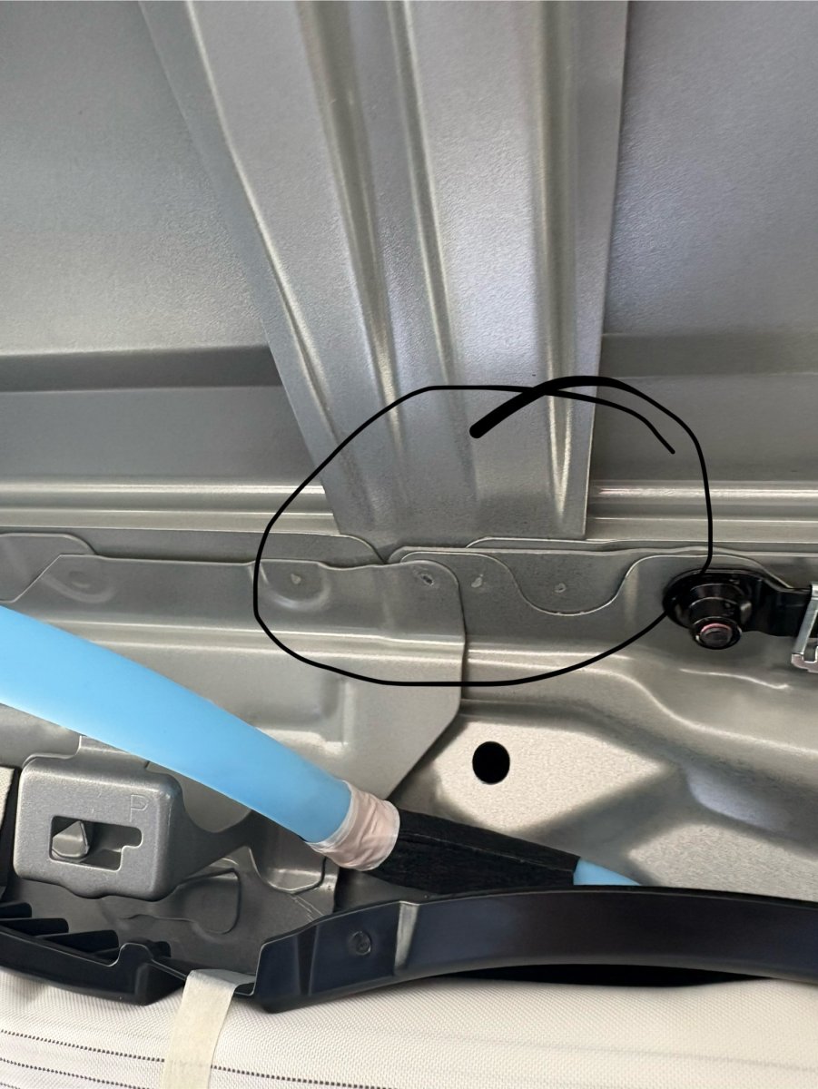

It's most certainly an issue with the metal panels in the C-pillar / roof area. It seems there's inadequate clearance between the panels resulting in the noise. I'm speaking exclusively to the service director now and he's committed to send me pictures and a video of the area in question. He says every time they think they have it fixed, it seems to migrate and/or come back. I believe, based on what I've been told to this point, and after reading forum posts here and on the LC forum, it's the result of a design flaw.

Here’s a picture the Service Director just sent me of the problematic area:
Looks promising! Metallic tap from the play in those overlapping panels. Just to clarify, thats where the roof meets the side panels with the liner off (next to the roof grab handle)?
Yessir, that's correct. I was just told they had it fixed and contingent on a couple more test drives (to confirm), it will be ready to pick up tomorrow. I've asked for a thorough write up of the solution/repair and will post an update once in-hand.

I had the same issue but it was on the passenger side. Dealership too headliner out and found 3 weld spots that needed fixed. Here is link to my post about this. Its heat related too. Gets worse after vehicle sits out in hot sun.
