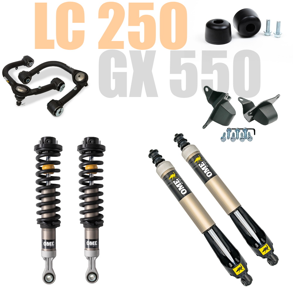

Here is the kit. You can work thru each of the component tabs to get a quick understanding of the kit, and parts pricing. Installation is separate, and is provided via an emailed quote. I will have Slee do the full install. I previously used this same approach with them for my Slee Rock Sliders.
You can see this kit is marketed for both the LC250/GX550 trucks. Slee just finished an install on a pretty new (it appears) LC250 3 weeks ago:

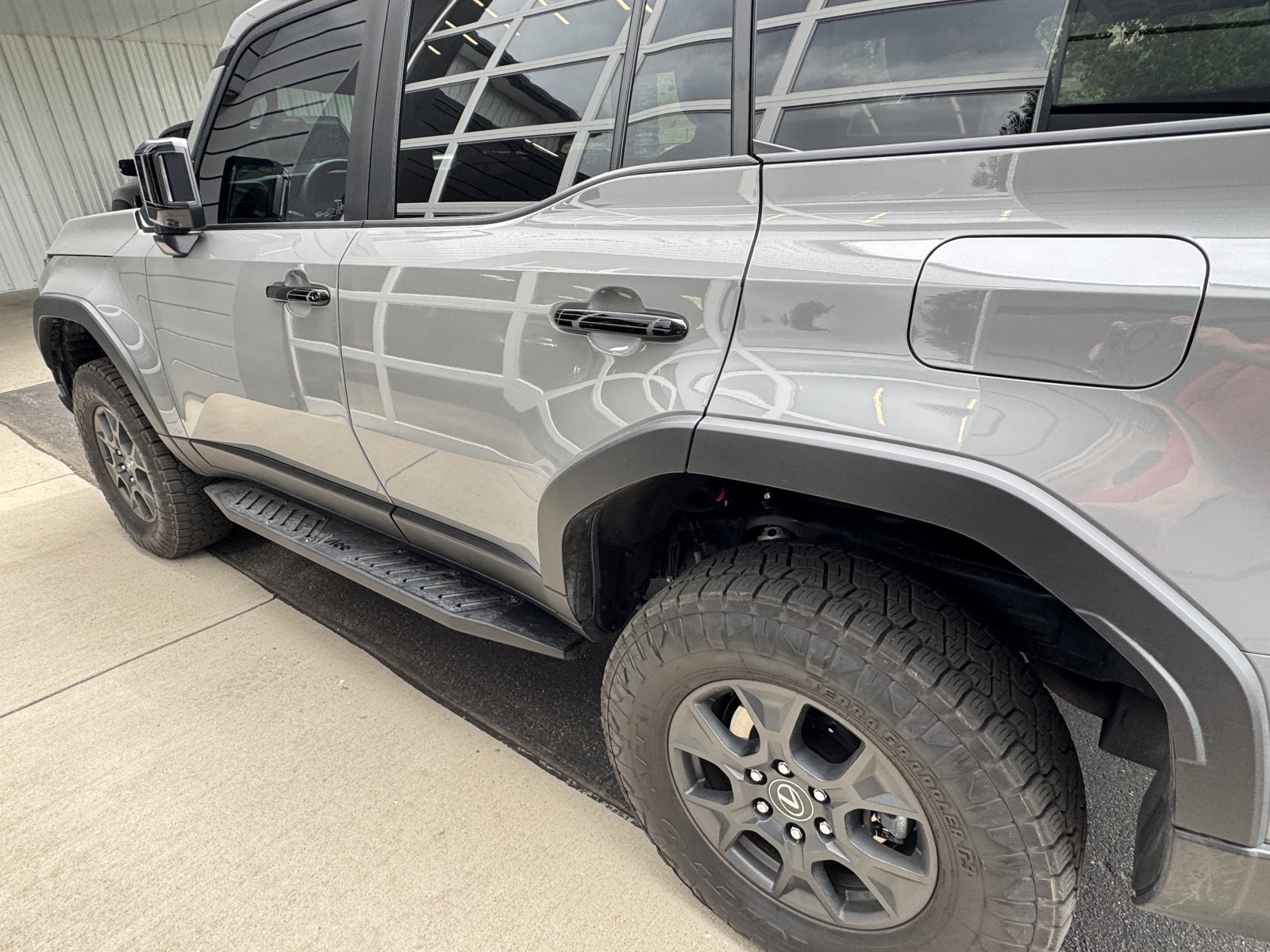

This LC still sits on its OE wheels and tires in these pictures. It has a heavier, non-stock front bumper. Slee dialed in the front to leave a very small amount of rake for heavier loads on the rear. I’m not sure of the exact trim of that LC 250. The resulting lift looks perfect for what I’m trying to do. Plus, I hope to improve the ride over stock.
You can clearly see they used the 3rd or 4th setting to accommodate the heavier than stock front end. Seems to work well. I don’t know if the owner chose to keep the OE UCAs or upgraded, or which rear springs were used.

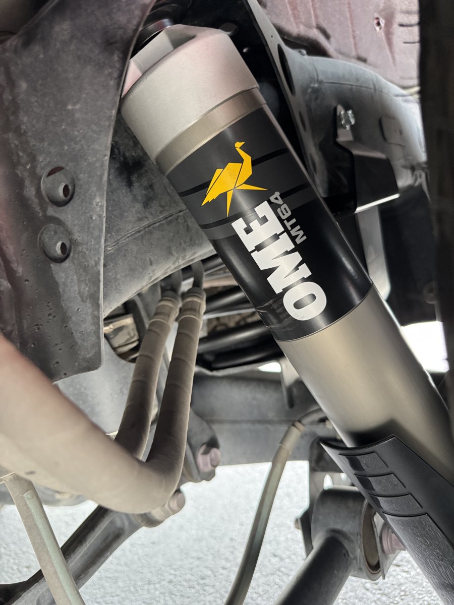

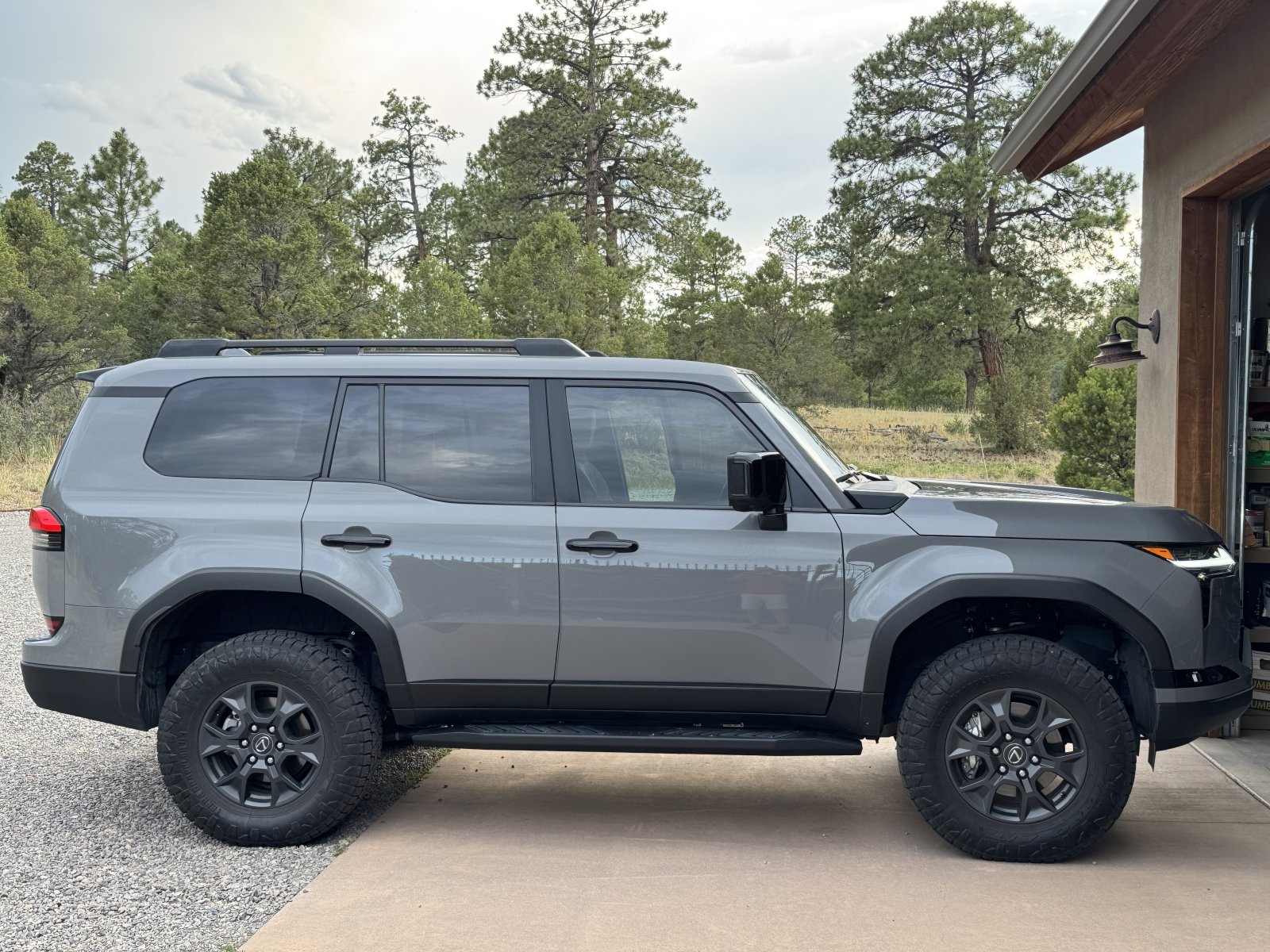

In a word, OUTSTANDING new ride!
I’m working on some good in-depth descriptions for everyone..so keep an eye on this post as I add edits, etc.
EDIT 1:
In one word UNBELIEVABLE!
Please excuse my ‘kid with a new toy’ enthusiasm, but that’s really what this MT64 suspension upgrade is for me!

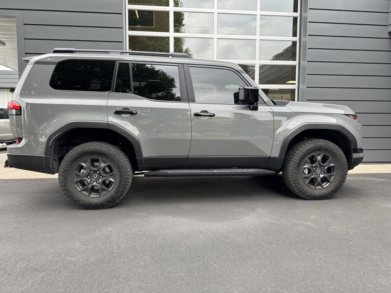

The truck has been transformed. It’s like I drove across Colorado to Slee Offroad with a so-so riding vehicle, and then traded it in for something more fun, safer and smoother. I’m super happy I ponied up the $$ to do this. I didn’t totally trust or understand I’d get this much improvement, but I was wrong. It’s outstanding.
My 2024 Overtrail now steers with essentially perfect response and precision; there is no longer any lag or body movement waiting for the AVS system to respond. Everything on the road is now a true one-handed operation. I was able to drive as fast as I wanted..within common sense bounds of course, but could easily have gone much faster no matter the road surface. Yes, I gave the new suspension a good test. 🤫
It never waivered, the truck never jumped around in severely bad sections of road at speed (as it did previously, regardless of AVS setting), all the dramatics are gone. I was able to dive into high and low speed sweepers with complete aplomb and near abandon, and quickly learned I could go even faster than I had previously. It was a quick learning curve!
I drove over on US 50 and 285, with about 33.5 psi cold on a hand gauge (not the TPMS or Viair gauge) on the same SL Terra Grappler G3 tires I’ve had the past several months, 275/70R18. I returned the same way with the same tires and same psi.
I intentionally began driving through and over all kinds of badly deteriorated road sections. Through many of the high speed sweepers I did everything you’re typically not suppose to do while cornering: I was braking, downshifting and intentionally hitting torn up surfaces - all at the same time. At first I was in disbelief..so I did that over and over again. No nose dive, no sudden shift of vehicle weight, no abrupt change of course. Just total composure and float and holding the line. Much safer.
I did have some time on city streets too, running errands at Stevinson Lexus and a local Costco. I had to dial back my speeds there too; the GX now seems to want to go faster and faster. It’s far more plush now on crappy local streets.
And it seems the vibration issue is virtually gone. I no longer felt it yesterday. I will confirm over the next few days. 🤞
Slee did a great job. Their installer has now done several of these kits; he is basically their LC250 and GX550 guy. They did the realignment, checked the headlight adjustment. We also talked about a few other things, and took a quick test drive including on some rutted dirt in MTS Dirt mode. Everything was normal, but the ride is more pleasant now.
I was fearful that I might miss ‘having’ the AVS; that I might miss fiddling with the mode selector every time I wanted to go faster, or get a softer ride in town, or make a change for a really broken stretch of road. That fear went out the window really fast.
It’s as if the MT64 has its own internal brain. Softer and plush on city streets, instant response driving over junk, and excellent, confident composure at higher speeds. It’s great not having to think about the suspension anymore!
Absolutely amazing! Again, I’m super happy with this upgrade!

Some of you may have wanted some before and after measurements, which I failed to do. 🤔
I can do some post-install measurements later though. But Slee aimed to accommodate my towing needs also. So we ended up with a little bit of designed-in rake to handle occasional bigger rear loads. I hope to get the trailer hooked up in a couple weeks and try it out.
However I can definitely see and feel the lift. It’s a very welcome change.
IMO this is how the Overtrail trims should come. Or at least this should be offered as either a PIO or DIO. It just makes the truck that much nicer.
I’m also contemplating larger tires and new wheels in the future. However, my GX now handles and rides so well..that I’m a bit afraid to change anything!

Just to be clear, did you purchase and install the following components?
  • Front OME MT64 coilover struts
  • OME Upper Control Arms
  • Rear OME MT64 shocks
  • OME Coil Springs - Medium Rear
  • Brakeline Spacer Kit
  • Sway Bar Spacer Kit Rear
  • Front DuroBumps Stop Kit
  • Rear DuroBumps Stop Kit
  • Total price on website $3,681.58

So those are great questions!
Yes, I gave up the AVS..so the different suspension modes are gone when you twist the mode selector. But with my 8 hours in the GX yesterday..it is seemingly a better and more composed ride no matter the speeds, surface conditions, etc. I was somewhat worried I would lose some ‘high speed cornering ability’ without the Sport suspension option. In fact it seems just as fast, but it’s easier and more composed than before. As you load up the MT64 springs and shocks they immediately hunker down and don’t give up.
I really put it to the test going up and down Monarch Pass 😬. I did a lot of down shifting with both the paddle and selector in Manual. Everything was normal there.
I didn’t have any error codes or warnings.
When I twist the knob it behaves as usual. It reacts as usual when I choose Eco, Normal, the 2 Sport modes. You can feel the engine power and transmission and rpm changes just as usual. * I will need to go into the Custom setting and see if it gives a code when I choose different suspension modes *. That might be interesting. 😊
I specifically asked Slee about the EKDSS and they stated there ‘shouldn’t be any impact’. I didn’t get a chance to fully test it but I will. While still in 4H I put the MTS in Dirt mode, it seemed fine.
I will play around with 4L settings, and also the Diffs and watch for any warnings. Same with the cameras. However, my daily normal use of them on pavement was normal yesterday.
I also want to plug in my Carista scanner and check all the ECUs.
I will let all of you know what I find out.
Please keep your questions or suggestions coming. Also, I think we have one or 2 other members who have just installed the same kit, so we should be able to get some good data and additional knowledge. Admittedly this is a bit of a test.

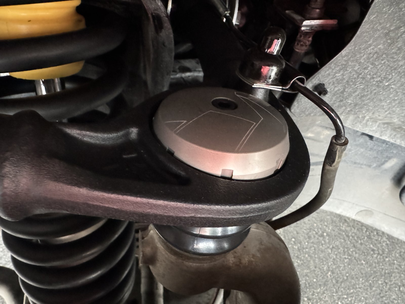

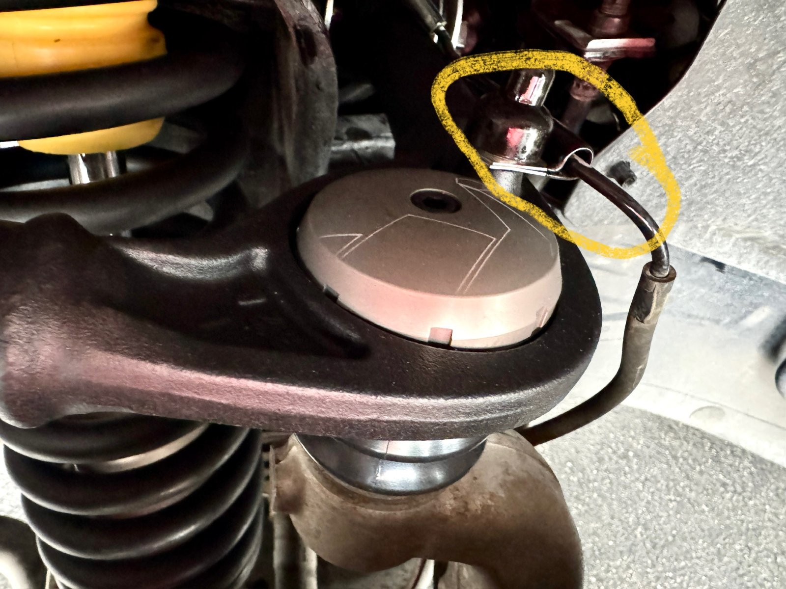

What did the installer do with the wire that was connected to the top of the original strut?
Yes. That’s correct..I failed to clearly spell that out. It’s readily apparent that only the suspension portion of each factory drive mode is gone. Driving home I used Eco mode a fair amount where traffic was light and I was able to cruise at high speeds and didn’t need to pass anyone.
When I did need to..I rotated the selector knob to one of the Sport settings and had the instant power I needed. I flew up Monarch Pass with Sport power this way..accompanied with the occasional (temporary) downshifting of the left paddle. Just as usual.
On moderate hill climbs with traffic I used Normal mode for enough power and transmission responsiveness to easily keep up; when there was no need or use in trying to pass.
In the instrument cluster it all appeared routine as I rotated through the different drive modes.
All other attributes seem to be retained.
I don’t recall if I even used my Custom Mode (previously with Sport power, Sport steering, Comfort suspension…). I’m going to double check that mode for everyone as it is; THEN I’ll make and test a change to the Custom mode and see what happens.
The wires coming out of the bottom (or top) of each OE Tokico shock or strut are unplugged and the MT64 kit has provided retainer clips to keep them safely out of the way; in case you ever need to access them again. You can see example in the pic below.
Again, I have not seen any codes thrown from the AVS system itself. If I do I’ll let everyone know, and let you know what/how to clear them, and whether it becomes a repetitive issue. 😊
