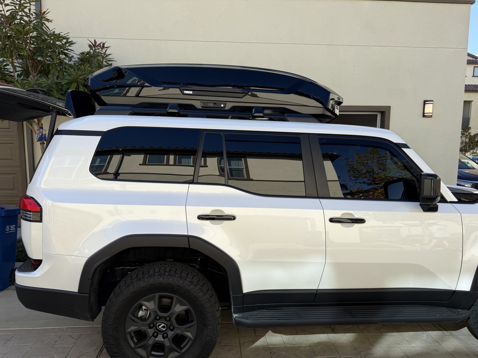

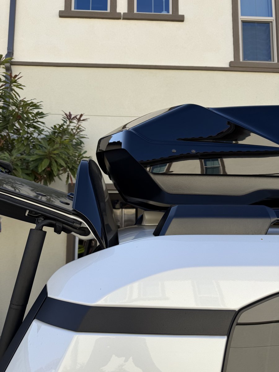

‘25 OT OEM raised cross bars will work for Thule Motion 3 XXL. Plenty of room to slide the box front and back. Also clears the antenna and trunk

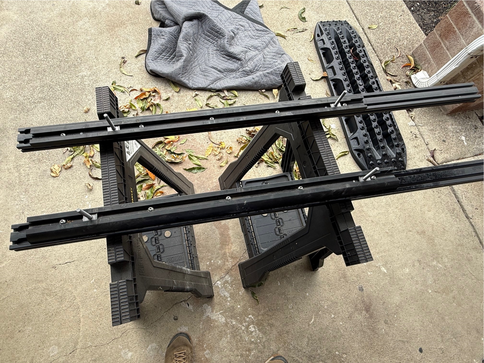

Here's how I got the Thule Boxes to sit flat on top of a Prinsu / Victory type roof rack.
Used this Jeep roof rack hardware mounted to the 8020 to raise it an inch. Fits the box flush to the full rack.
Here's how I got the Thule Boxes to sit flat on top of a Prinsu / Victory type roof rack. View attachment 16722
I'm not sure I follow, can you explain a bit further? Also what you linked doesn't match what you posted. Thanks!
