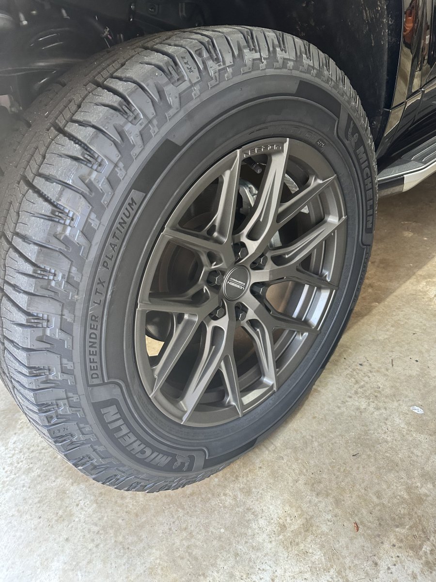

Added Westcott 2.5 / .75 lift and ran stock wheels and tires for several thousand miles before ordering aftermarket wheels and tires. Adding the Westcott lift changed very little in terms of ride quality and drivability. I actually preferred the Westcott feel versus stock.
I added 20x9.5 Vossens and originally with 295/60/20 Yokohama At-4’s. Returned and replaced with 285/60/20 Michelin Defender LTX Platinums. The ride quality was absolutely awful with the Yokohamas (which I was very surprised with considering I put 50k on my Tundra with Yoko’s G015 and absolutely swore by those tires. Extremely quiet, smooth and great in the rain, ok Off road.) Switched to the Michelin’s and they are absolutely quieter and smoother at highway speed than the Yokos. However the “hard ride factor” is my issue.
The load rating of 121/125 for the Michelin’s is higher than the stock tires, but I assumed since the sidewall is decently tall that the higher load rating tire wouldn’t be that harsh on this vehicle. I was wrong. Even deflated to 30 psi these tires has completely ruined the ride quality of this vehicle. Every road crack / hole / slight imperfection is felt.
Yes this is my fault and yes I didn’t do enough research apparently. But comparing this vehicle to my Tundra, and having a similar load rating tire on that similar-weighted vehicle, I thought the ride would still be “soft and smooth”. It is anything but and I’m not sure what to do. Contemplating just selling the wheels and tires and going back to the stupid looking stock wheels and tires.
Is there a tire with a softer sidewall in this same or similar size of 285/60/20? I’ve not been able to find one.
Other option is to sell these wheels and tires and go to a taller sidewall, smaller diameter wheel.
Appreciate any experience / opinions.
