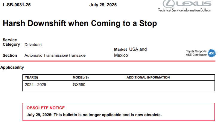

Thats an outdated TSB. I have access to the Toyota TIS and the version of that one on there says:

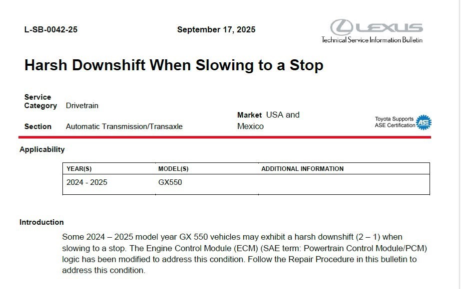

Attached below is the correct current one.

TSB says its a ECM update/reset
Well this is my concern as it is not clear. A reset can be achieved with a battery disconnect but for the update, they actually need to have a software update to reprogram the ECM/TCM... Does anyone have more info on this?
