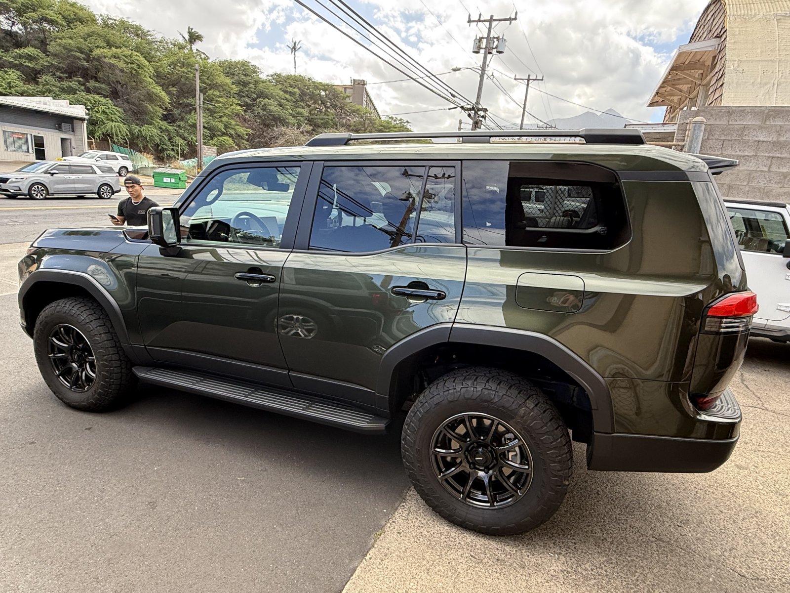

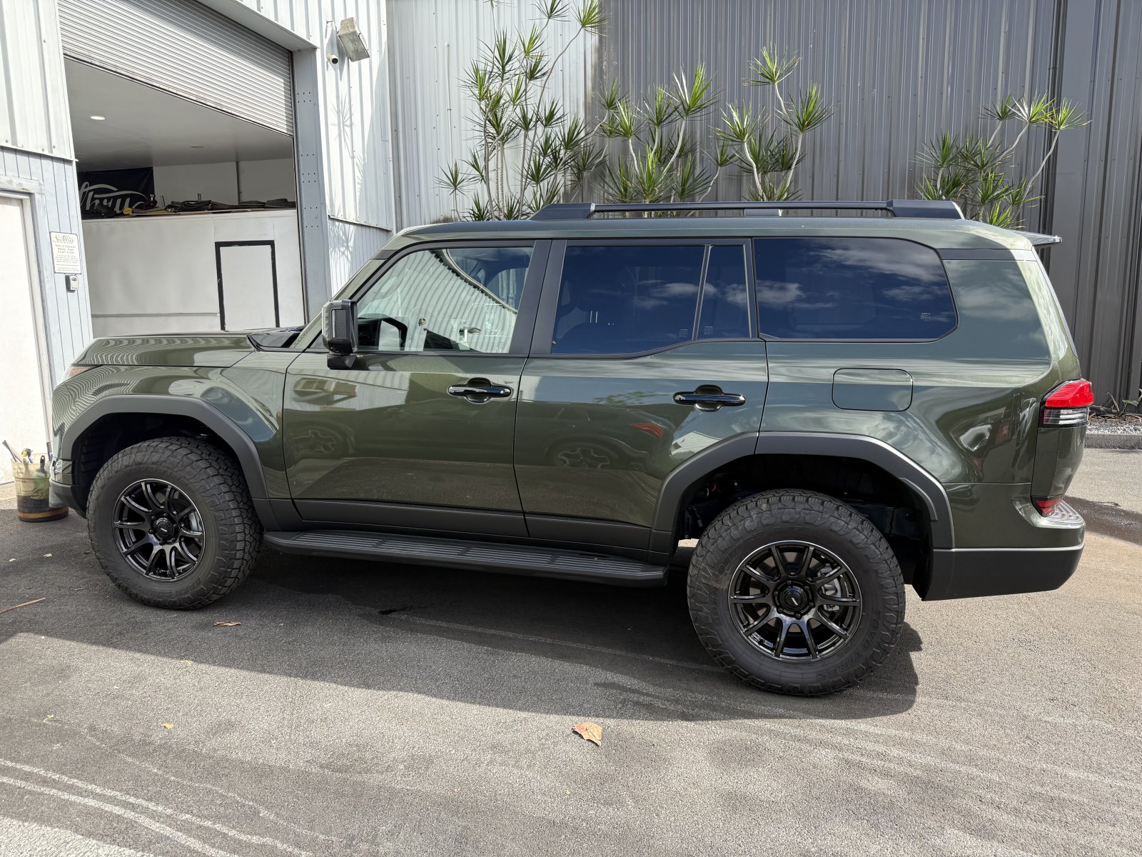

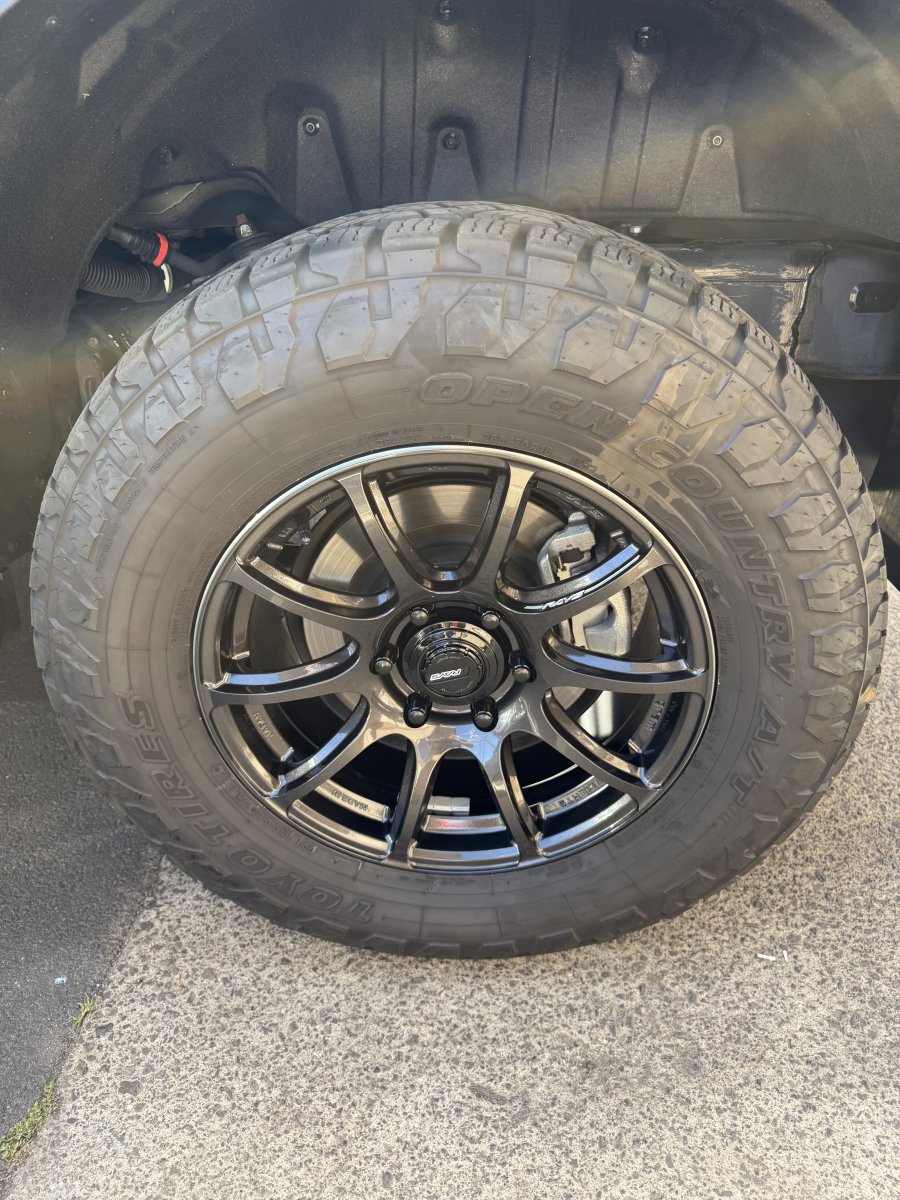

Cherreh! First pic 1320 second pic See-Thru?View attachment 18281View attachment 18282View attachment 18283After an 8 month wait I finally have my Rays Gram Lights Trans X on.

You got it, good eye!Cherreh! First pic 1320 second pic See-Thru?
None, I don’t want anything extending beyond the body work.Looks really nice. How’s the poke on these?

You don’t need thinner studs for Rays/Volks, extended yes or highly recommended but M14 studs fit fine.Ok cool. I dropped my deposit on an OT 6 months ago. I was gonna order a set of Volks ZE40X with Matt but was waiting to see if the new castings were gonna happen. Wanna avoid running thinner extended studs.
It’s been a while since the I’ve looked at the post but I thought the consensus was you can't get ET lugs on M14 studs with Volks to engage more than 5 turns as some owners were reporting. Recall that thread on the ZE40X?You don’t need thinner studs for Rays/Volks, extended yes or highly recommended but M14 studs fit fine.
Correct you can’t run ET lug nuts on Rays/Volks with M14 studs but you can get extended M14 studs and run them, no need to get extended M12 studs.It’s been a while since the I’ve looked at the post but I thought the consensus was you can't get ET lugs on M14 studs with Volks to engage more than 5 turns as some owners were reporting. Recall that thread on the ZE40X?
