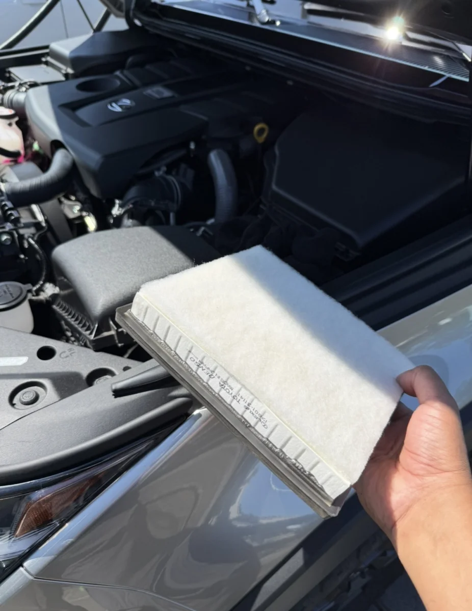

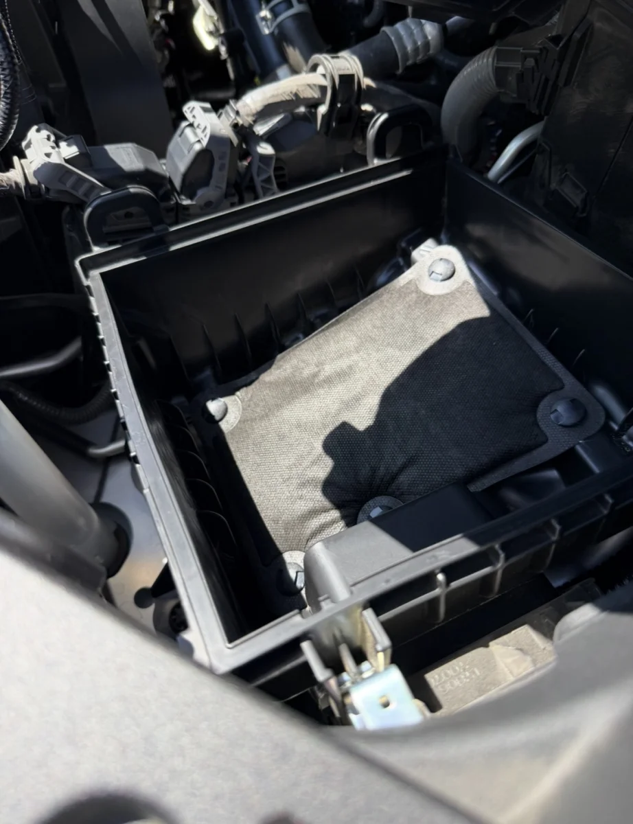

There are two air boxes on the GX - one going to each side of the engine. Each airbox unclips very easily and the filters come out without much effort. Unique to these filters are a black carbon pouch at its base (which appears white in this picture and doesn’t require removal), and a 1/4 inch foam prefilter that catches larger debris. It’s a high quality set up!!
A quick vacuum of the box and blow out of the filter, and the life of your filters can be extended at least to that next service interval. “Clean air = less repair.”
