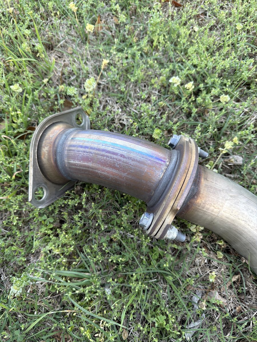

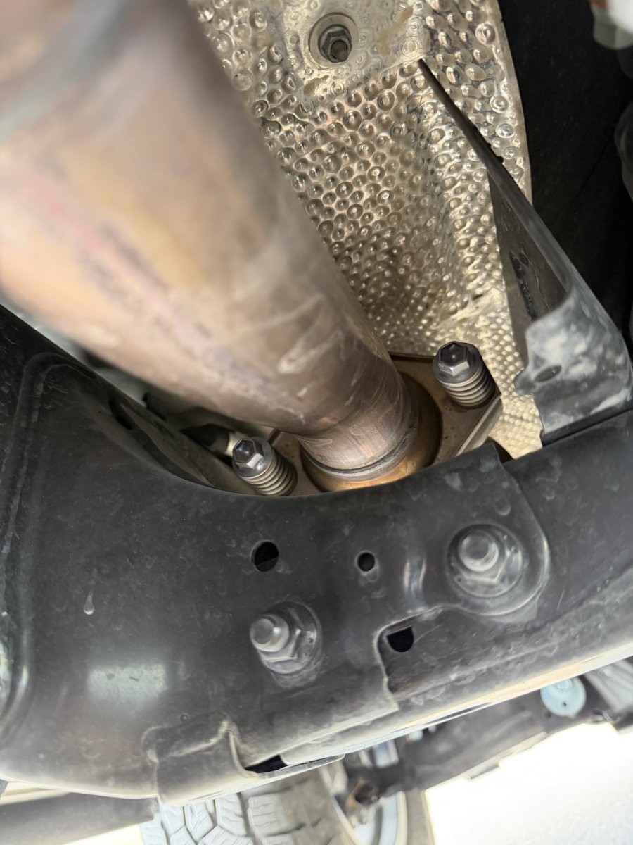

The process was fairly simple, it's just 6 bolts (14mm socket) that holds everything together. Other than that it's just the exhaust hangers which was the hardest part. I used soapy water in a spray bottle and just sprayed the hangers and used force.
Here are the bolts,

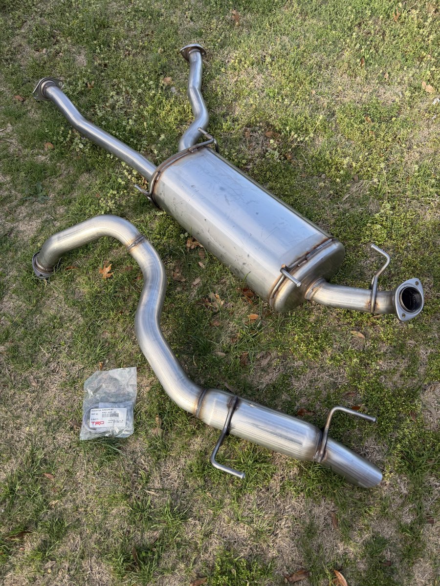

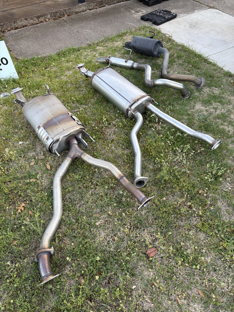

A photo of the TRD kit and a side by side.
