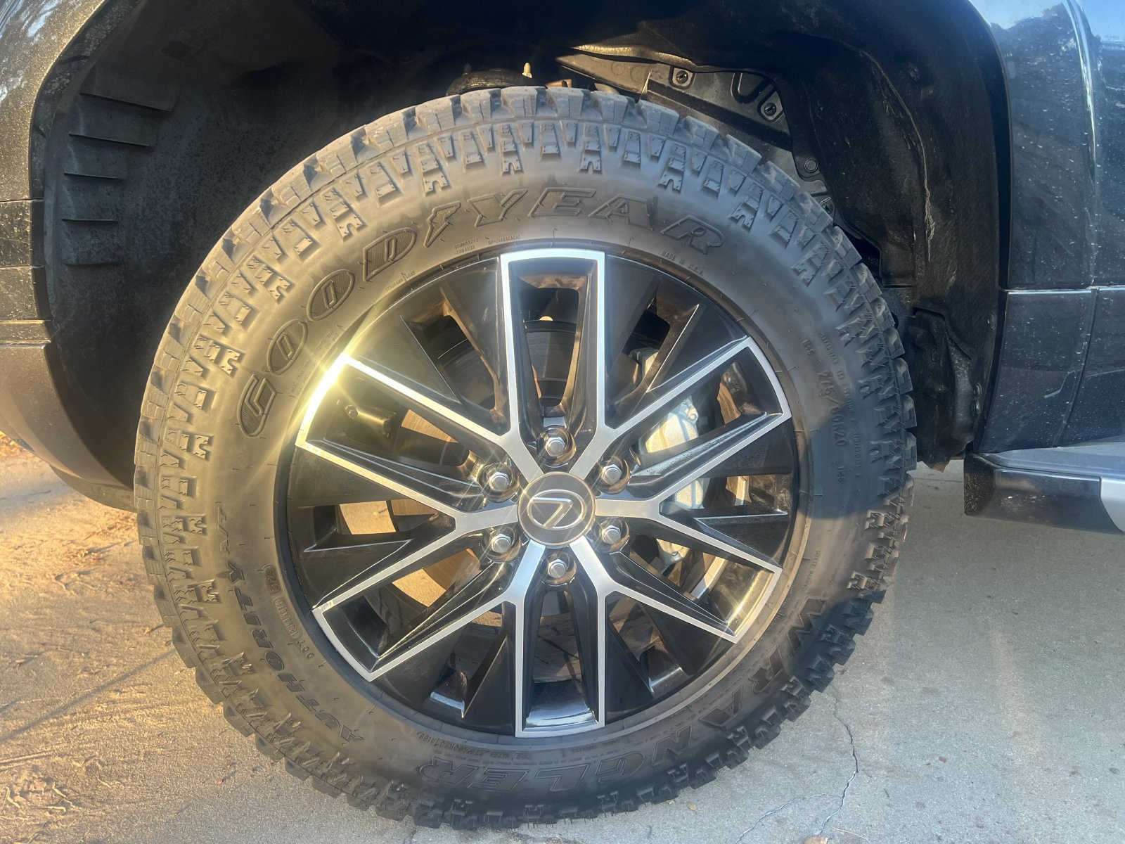

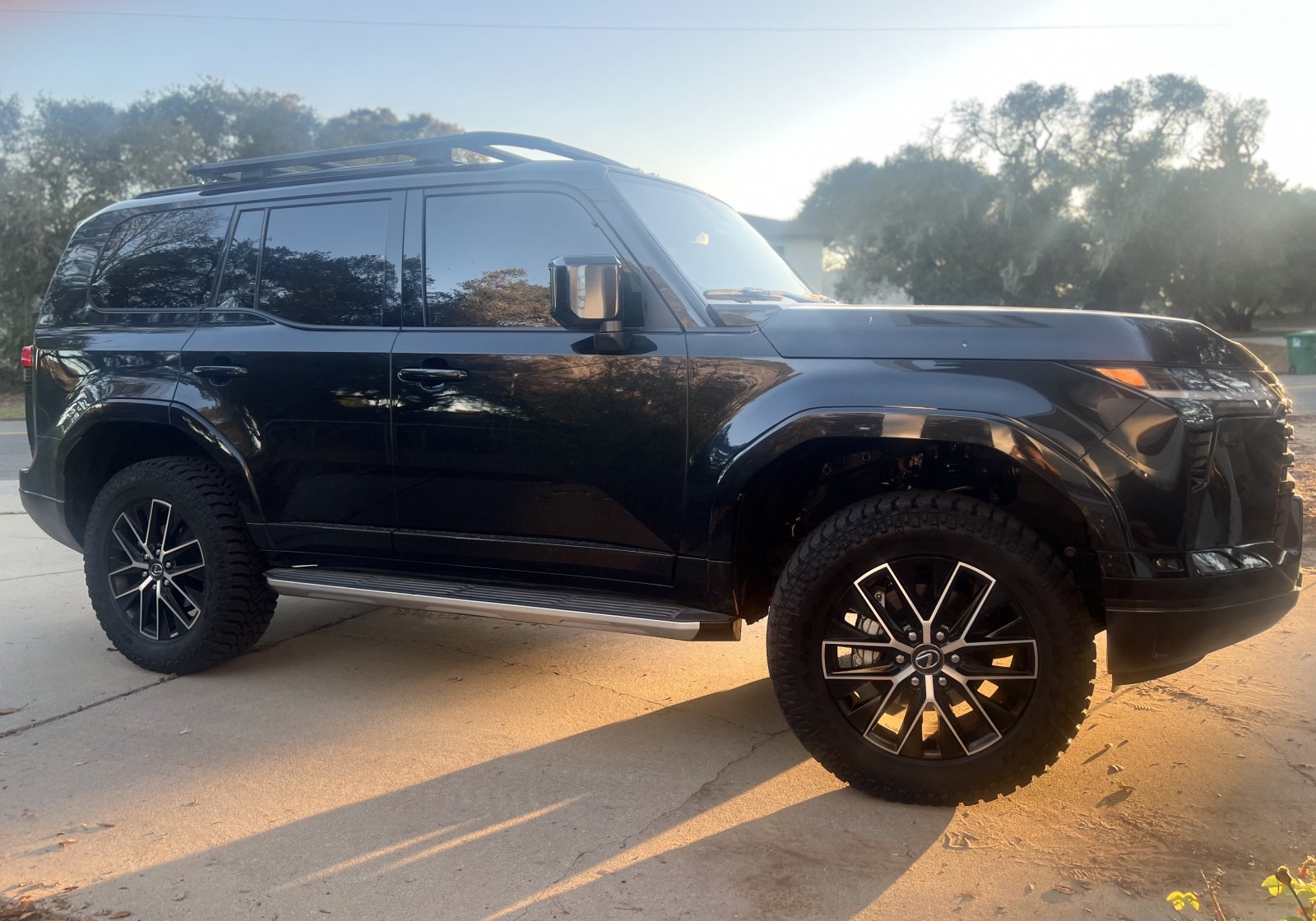

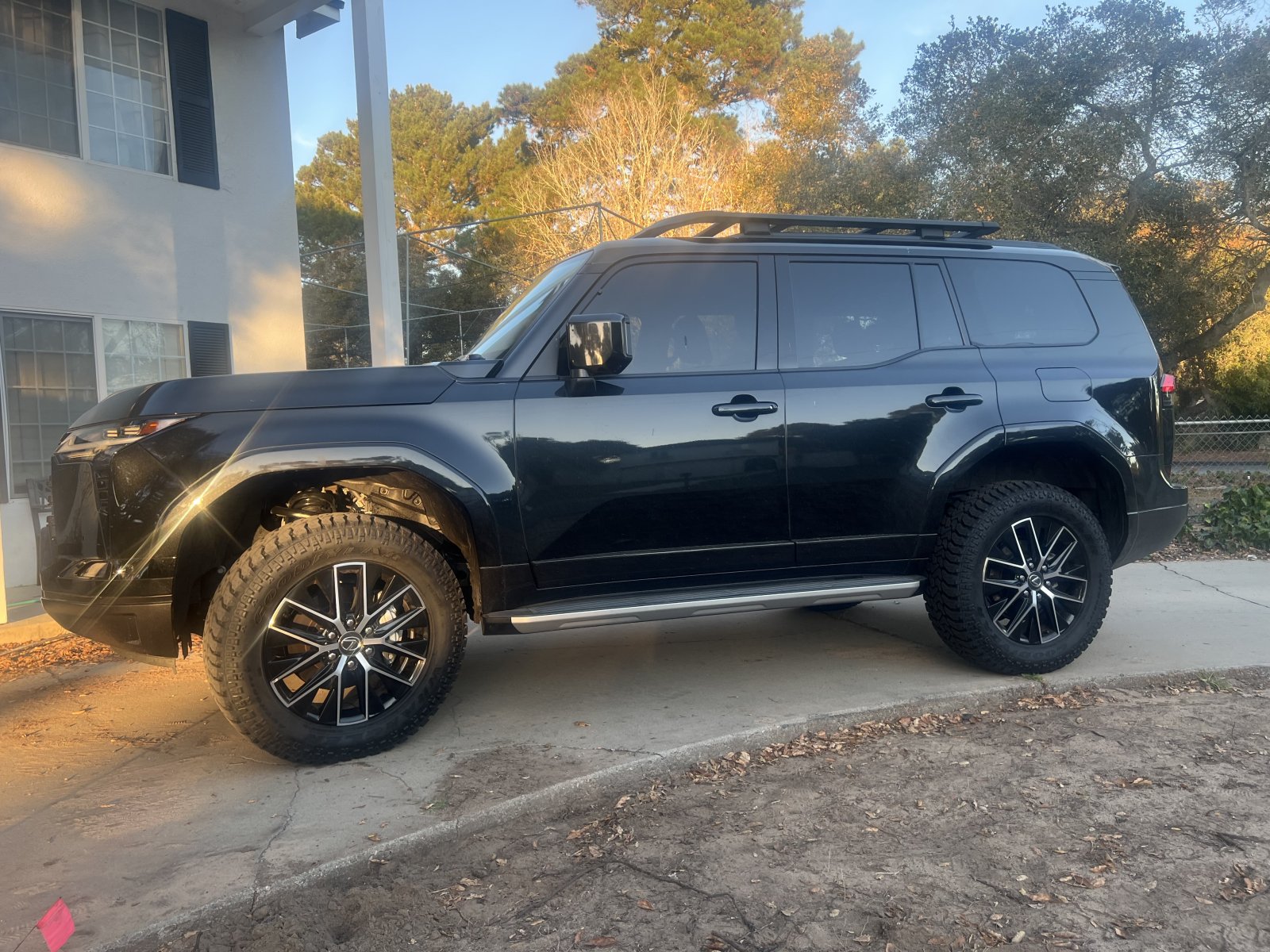

Got my Westcott designs preload collars a couple of months ago and finally put them on today. They don’t have an install video through Westcott (or anyone else) but I used the land cruiser one Wescott has as back up.
I did mine with a floor jack and jack stands in my driveway.
If anyone is doing the same and has any questions I’m happy to help. It is almost the same as Landcruiser except the sway bar prevents you from sliding the coil over off at the bottom mount. I battled with this for a while but got it done.
I decided to stick with the Premium+ stock 20” wheels but will end up painting all black.
Went with Goodyear Wrangler ATs 275/60r 20 (33” height 10.8 width 20” wheel) I think they look great and they are quiet at any speed. (Didn’t have to remove anything and zero rubbing)
How could you possibly hear the tires with the roof rack on there!?! But, it looks great. I wish I had the balls and skill to do that myself......
Hahaha…Make sure the sunroof is closed and covered. Yeah I’ll be ditching the rack that’s for sure, the thing screams at highway speed! Thanks buddy! it took longer than expected, but was worth it. The ride is same as stock which I love!
Looks great!! I could never take on a project like that. I agree with the roof rack comments. I took mine off the first week. No noise and better milage.

Not OP but I just tackled this yesterday on my Overtrail+. Having some experience wrenching with my previous 4Runner I went into this somewhat confident. The Overtrail has some wiring for the front suspension that takes extra time. Took a good 4 hours to do this with on the ground with jacks and jackstands. I followed the Westcott videos but for the rear shocks I removed the bottom bolt instead of the top like the video says. Rears are very easy to do. I did have to jack the driver side kdss rear sway bar end back up to get it back into position. When I disconnected it from the passenger side the sway bar just drooped down. Just wanted to mention some things that aren't mentioned for the Overtrail models for any future DIYers.

Does the collar lift level the front with the back? I have a 2025 OT and it came with a lift but the front is not level with the rear which I would like to do.
