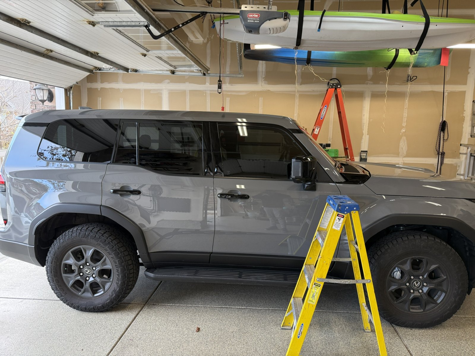

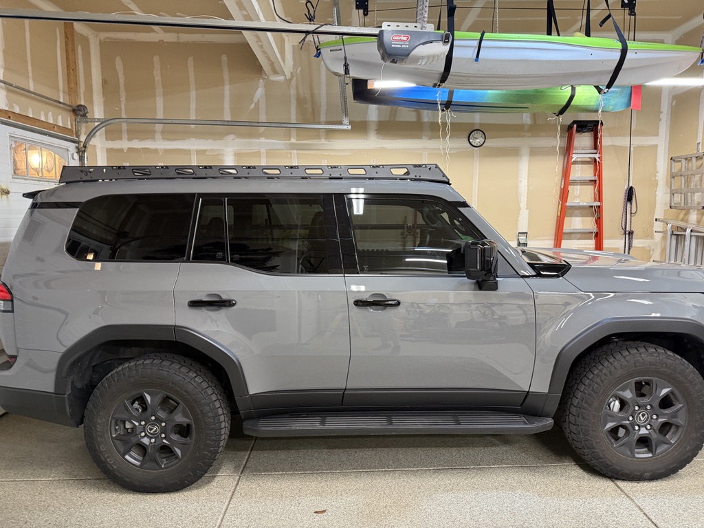

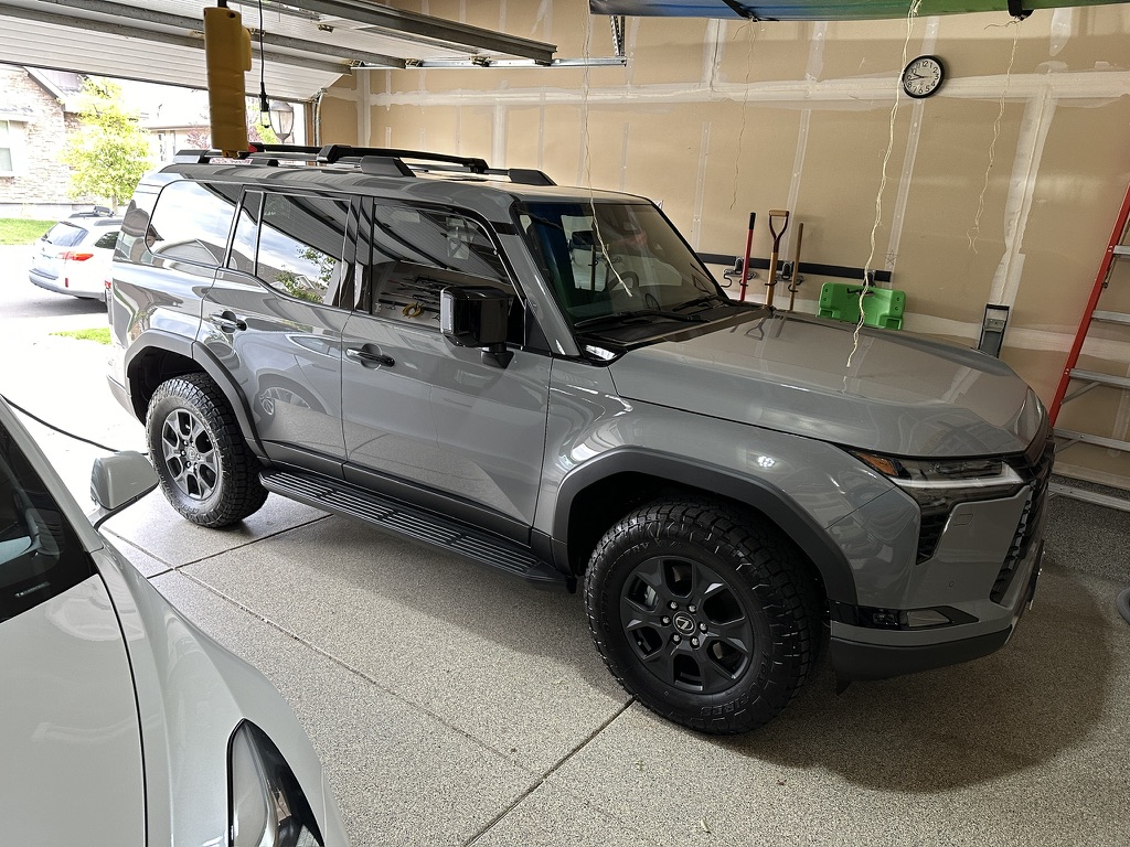

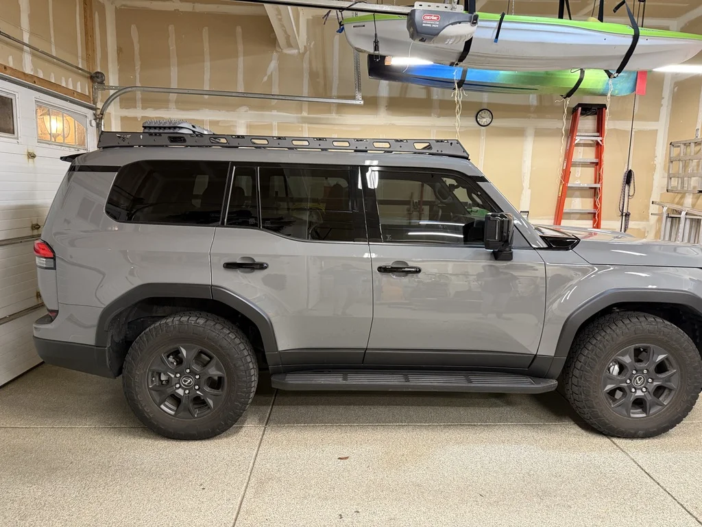

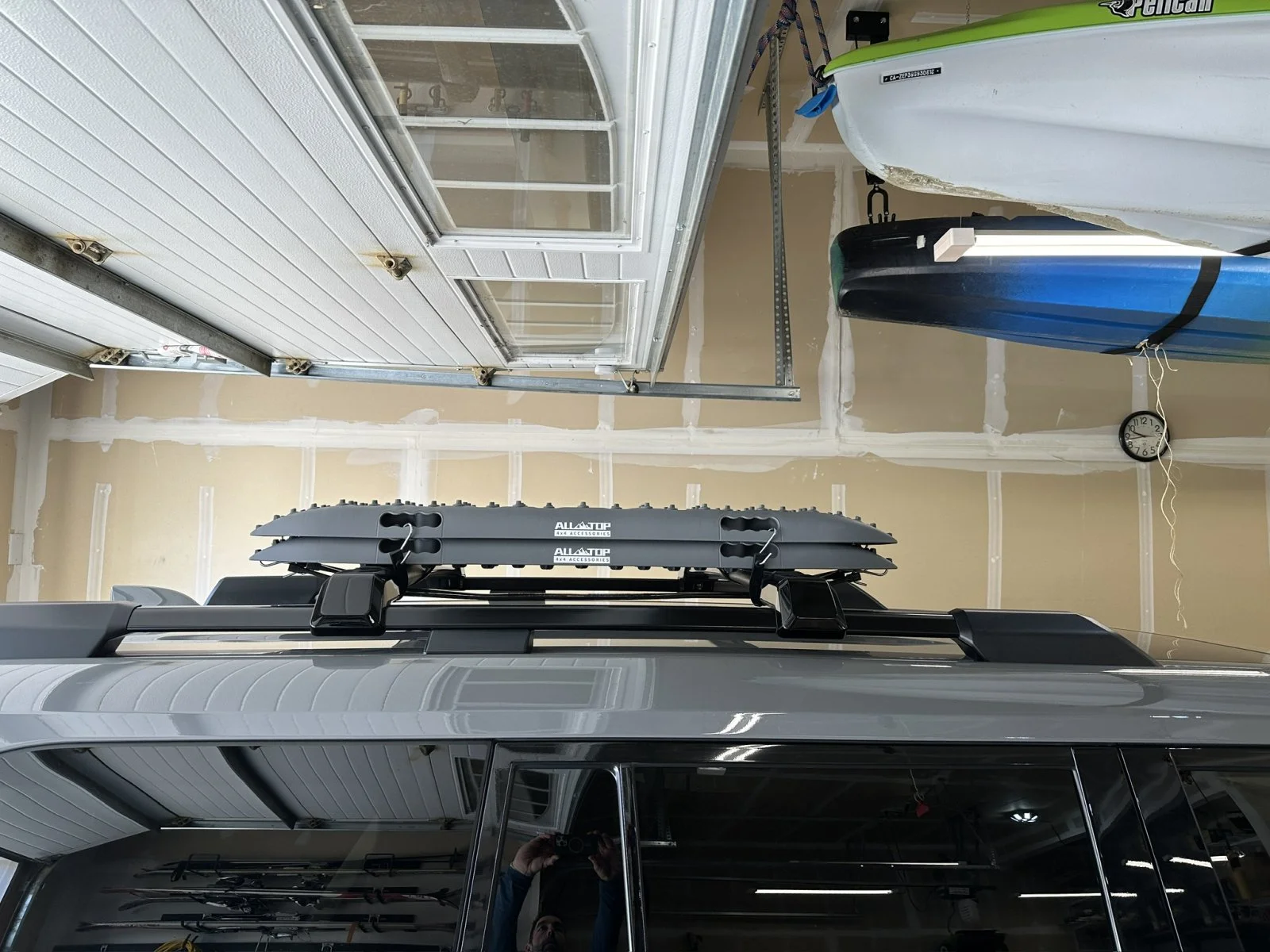

Well, here is the Victory on an Incognito OT+. I like the how the gray accent pieces tie in. It took about 6hrs to remove/assemble/install. All the holes lined up well, nothing particularly frustrating other than cleaning off the anti-sieze. I was a little worried the side rails were bent, but they trued up with full assembly. There were some scratches in the powercoat.
Kuat Grip 6 ski rack will go on towards the front. I may fabricate a different mount for the traction board.
Orig

Ta-da
that full length rack looks amazing!
I'm not sure I have any use for it... but it makes me want to get one LOL

Orig View attachment 5223
NakedView attachment 5224
Ta-da
A very solid purchase! I bought the same for my Incognito OT. Installation time is correct and I only needed help lifting off the old rack and lifting on the new rack. Instruction are only available by video so be prepared to stop, rewind, rewatch a few times and scratch your head a bit as to if the braces go inboard or outboard of the rack (inboard). Also, if you don’t want to buy the $50 matte black hardware kit, I went with the below to hide the stainless screw caps:

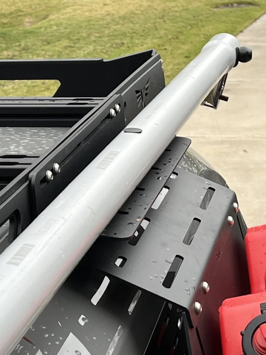

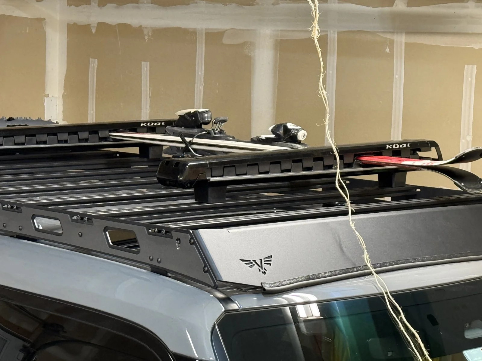

Here is the Grip 6 direct mounted. Their T channel nuts were tool big so used Victory ones with some 2.5” 1/4-20 allen screws. Next I’m going to try to modify kayak J mounts to use the Kuat clamps.

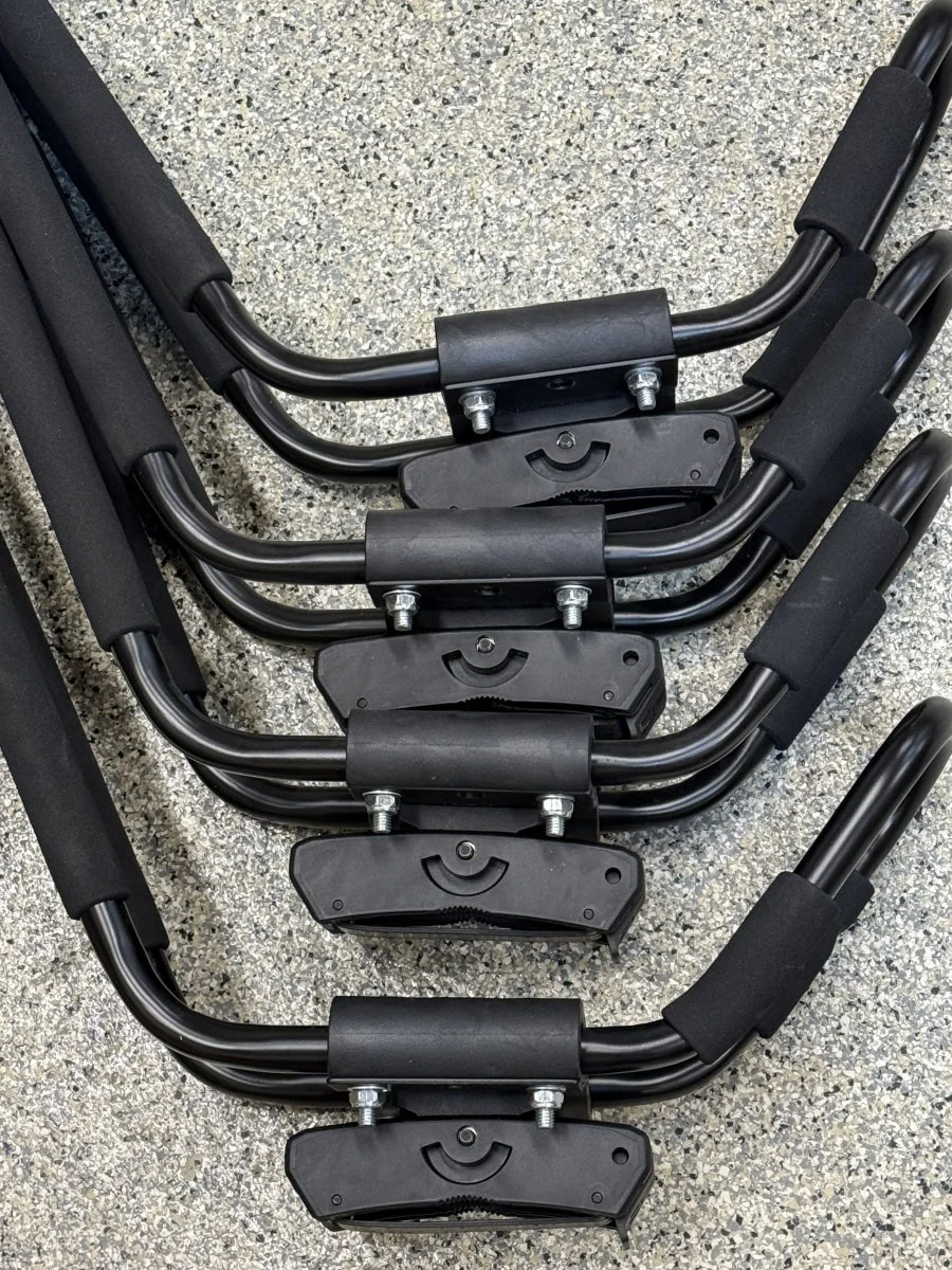

I was able to mount the Kuat clamps to some kayak J hooks I had. I wanted to make sure it was easy to remove since I can’t park in the garage with them. I haven’t tried it yet though .. in the spring.
