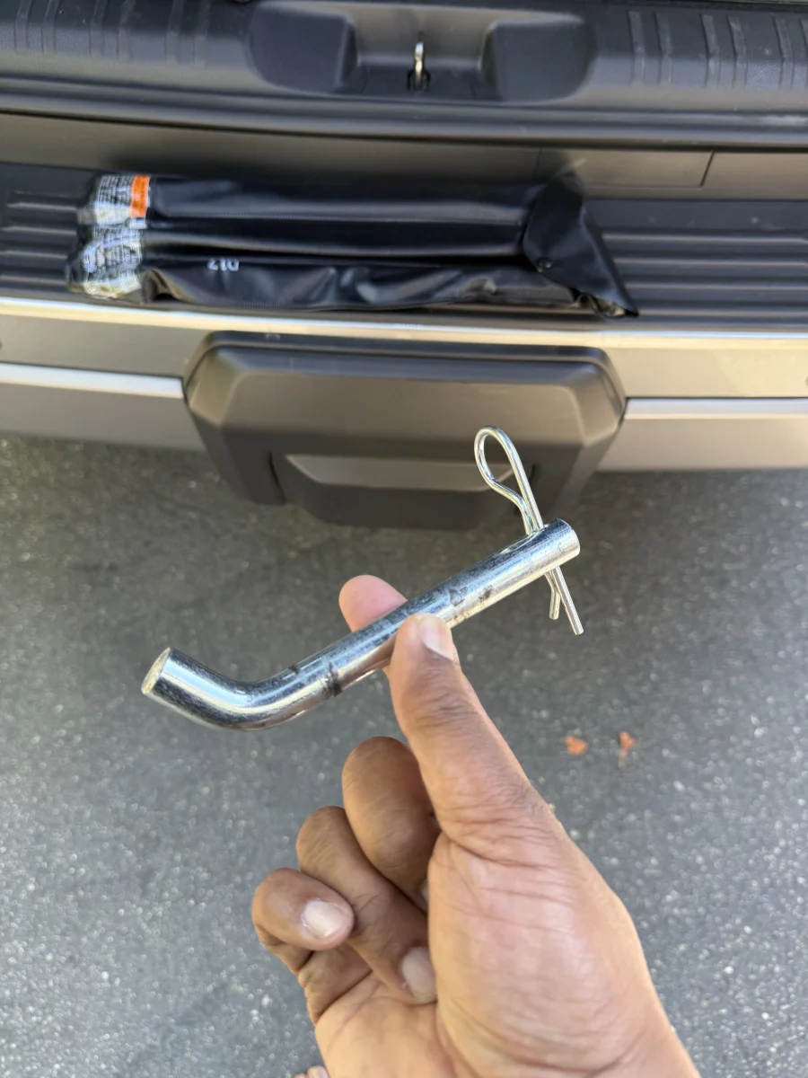

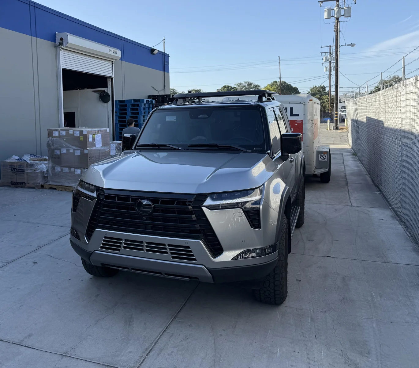

My GX did well on its first towing experience. The flimsy plastic trim came off easily. But I learned a couple of GX 550 towing caveats- the hard way.
1. The towing hitch requires a 4 inch span hitch pin (STANDARD size does NOT work). Thankfully I was able to borrow one from Uhaul.

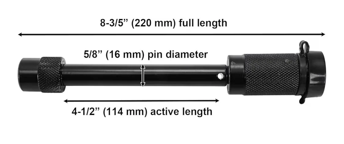

Just ordered these two locking hitch pins - will update once fitment is confirmed.
This one is $15 and 4.5 inch workable length.
The other one I ordered is
also $15 with a 4 inch working length:
*** awaiting arrival of both for confirmation of fit & accessibility of key to locking end.
UPDATE - both fit - the fist one just barely fits into the outer diaper molding (once reapplied) - my preference is the longer one. The 4.5 seems way to long - but it comes with a bag up pin, in case the lock fails, and rubber O-rings that prevent clanking of the pin. Also unlike the 4 inch one which I’m returning, the lock doesn’t require the key to lock it (only to unlock).

Great write up and thanks for posting. I have yet to tow and have never had the cover off but that will change soon. Where I fish you need to lock the trailer and receiver. The part you listed with the Amazon link shows that it will lock from the side. My question is there enough room to lock it from the side? Thanks
The silver 4 inch working space hitch pin pictured above navigated the space perfectly well once the plastic surround is removed. (Which is a necessity no matter what hitch pin is employed.)
So i suspect the locking version from Amazon will hopefully work as well. If not there is 30 days to send it back and I will post on the forum if it is replaced.
And I’m sure others on the forum will post what has been successful for them. 🙂👍🏽
So, I was about to order the part and then I found the following video which seems to indicate a long hitch pin may not fit? ... check about 4:20 into the video.... Did you measure it?
The outer plastic cover comes off and then the 4 inch hitch pin can slide in., and then the outer plastic can be set back in place.
I’ve ordered the two black locking hitch pins I listed above and will update regarding the fit within the coming days.
I use a B&W locking pin. Fits fine, but of course everything is a little tight down there (that's what she said) due to the design of that area of the truck. Thanks for the reminder about tow/haul. I completely forgot about that button and had been turning off the parking support brake or whatever it is called via the button on the left and muting the proximity sensors via the touchscreen.

The Factor 55 Locking Hitch Pin - Long works well.
