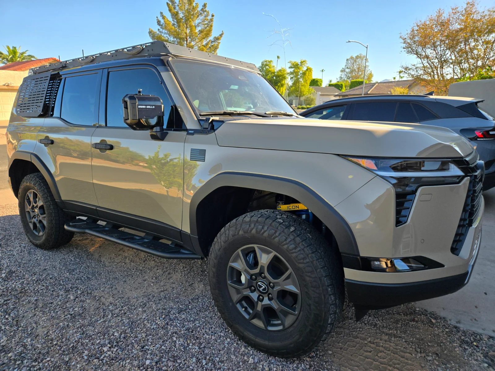

I have a 2026 OT+ with a Westcott roof rack, ladder, and side molle panels. I am in AZ a want my build to support local business as much as possible. Tougher to do than one would think...
Any way, I just purchased a 270 degree awning that I am looking forward to using. However, I do not want it drive around with it all of the time. Nor, do I want to disassemble the roof rack every time I want to take the awning off or put it on. So, I would like to find quick release awning brackets to make this easier.
Simple project, right? Right...
Problem is that my Westcott rack does not have any side channels to use the mounts I am currently considering. Westcott is not interested in making awning brackets for their roof racks. I have seen the Prinsu awning mounts and they might work (nice looking and built well). The Prinsu brackets are about $180 a piece and I would probably need three, ouch (kind of used to that pain of being a Lexus owner).
I am sure someone out there has a Westcott roof rack and is smarter than I am, at least this is what I am hoping. Would appreciate any helpful guidance and positive reinforcement that there is a solution.

Bluegill had some in his build post and a link to the ones he used. These look pretty easy to use, especially reversed like he did. I keep seeing something called Land Raxx advertised on FB. Still waiting for my rack so haven't ordered either one yet.
I finally got around to finishing the mounting points for my Ironman 4x4 shade canopy.
I'm not the kind of guy who needs to drive around town looking like I'm ready for the zombie apocalypse to start any minute, with all sorts of shit strapped to my truck, so there was no way I'm leaving the shade canopy on my truck full-time.
So I bought a pair of these quick-release mounting brackets:
Awning Quick Release Mounting Brackets
They advertise them as mounting the male hook piece on your rack and the female piece on the back of the shade canopy but I didn't want those dorky hooks living full time on my rack. The hooks would also stick up a few inches over the top of my rack which wouldn't let me get in my own garage not to mention parking garages around town. So I simply reversed the male & female parts and mounted the hooks on the canopy and the female part on the side of my roof rack.
The two pieces of the brackets are secured with some large swivel hitch pin clips that go through pre-drilled holes in the male & female parts that line up when mounted, but the Iron-man supplied clips touched the white paint on the truck when inserted so I bought some stainless steel straight-pins and separate cotter pins. The rack is very secure and it doesn't rattle. Surprisingly, I couldn't hear any wind noise even on the highway. I'll have to get some pictures of the shade canopy opened up (or "deployed" as the zombie apocalypse overlanders like to say) on my next camping trip. It's still too damn hot here to open it up just for a picture.
Another problem was where to store this long shade canopy when it's not on the truck? I'd typically just lean it up in a corner of my garage but all the corners are already taken up with useless shit. While looking at it on the truck I thought what would be the easiest way to get it on & off and store it and I realized that the perfect solution was to hang it on the ceiling. So a few big hooks went in and now it's easy to just lower it onto the truck and then lift it back up onto the hooks and the canopy is out of everyone's way. Luckily it clears the garage by about a quarter inch. The zippers actually brush the garage door when it's opening and closing.
View attachment 3045View attachment 3046View attachment 3047View attachment 3048View attachment 3049View attachment 3050View attachment 3051View attachment 3052View attachment 3053View attachment 3054View attachment 3055View attachment 3056View attachment 3057View attachment 3058View attachment 3059
Land Raxx not compatible with Westcott. No side channels. I'm got a set of the Prinsu brackets. I discussed with Westcott designs and they said they would "probably" work. I'm hoping I can get them on the rack, then I'm home free.
