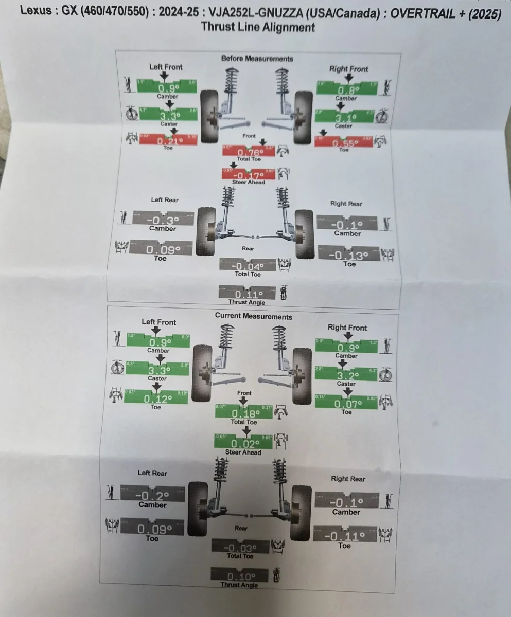

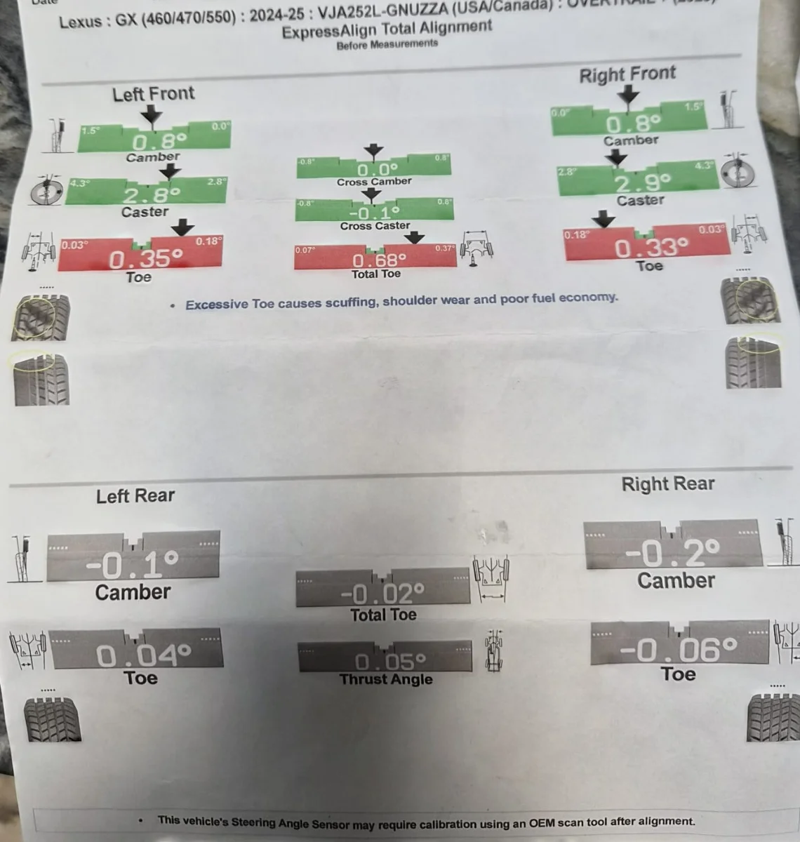

I got my new wheels and tyres at america's tire. They definitely did the balancing, but only did the alignment assessment but only had uptil 2025 gx550 OT+ on their system and said they wouldnt do alignment. I cud see a toe in (pic below).
So i took it to another alignment center 'mavis' and they said the same at first (they had only till 2025 model) I told them its the same body style and they agreed to do it but couldnt charge me for it. Nice of them, so i left a big tip for the boys. I did get a copy of the report (pic below). But still the same issue. Even after truning off all assists and sensors possible on the screen.
I would imagine that the camber would be off when lifted, somehow they are showing all clear.:unsure:
