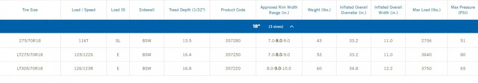

1. Wondering what the tread depth is for that specific size, version of that tire?
2. Wondering if that size width will safely fit on our OEM Overtrail 18” wheels - or would you get a different wheel?
Thanks.
Thanks.

I bought some. Waiting for my TE37's to come from Japan. Went with 18x8 +30 offset Pressed Double Black TE37SB. The wheels should arrive when the Westcott lift kit comes (end of the month). Will report back with pics and how the tires are.
