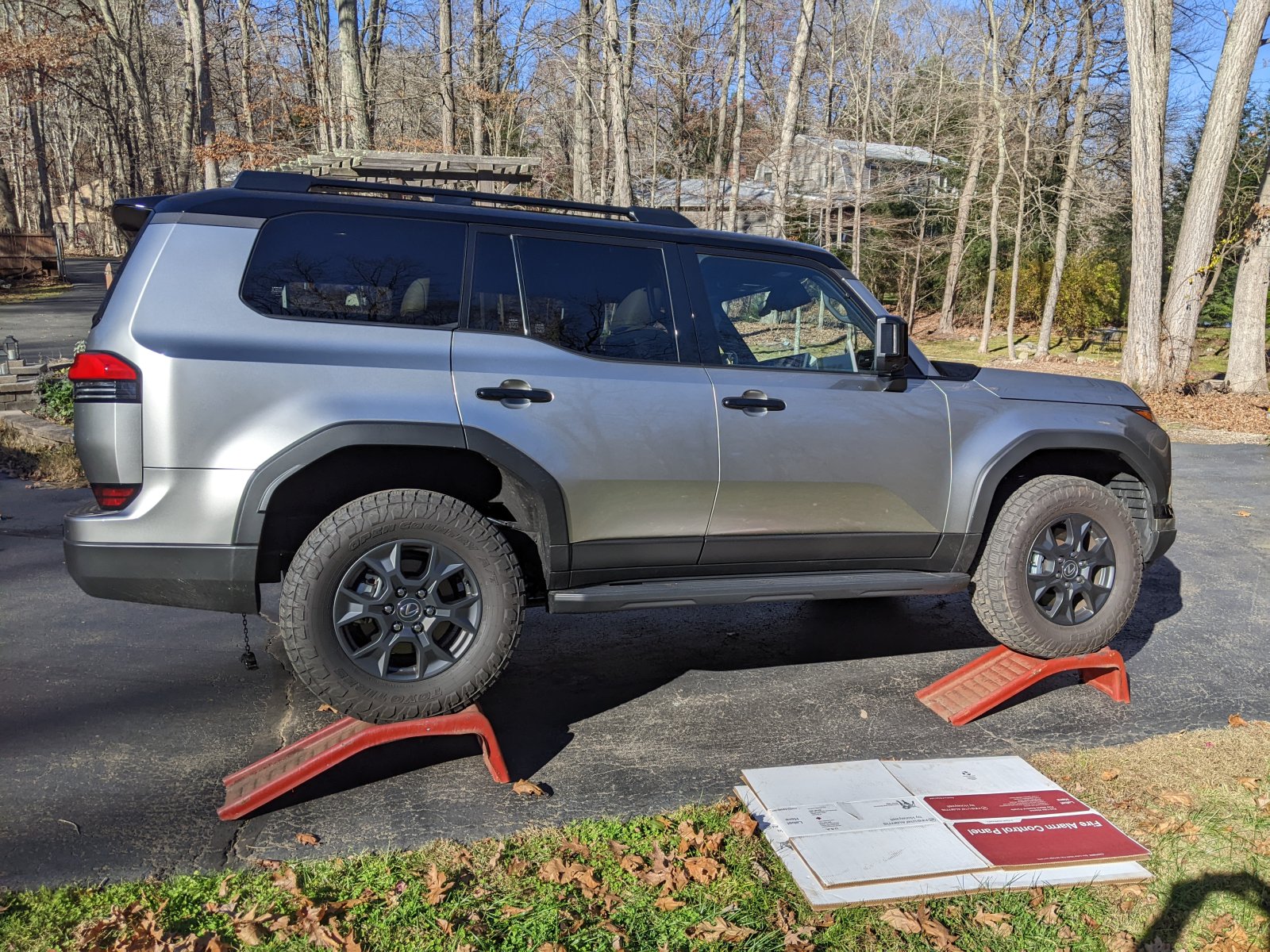

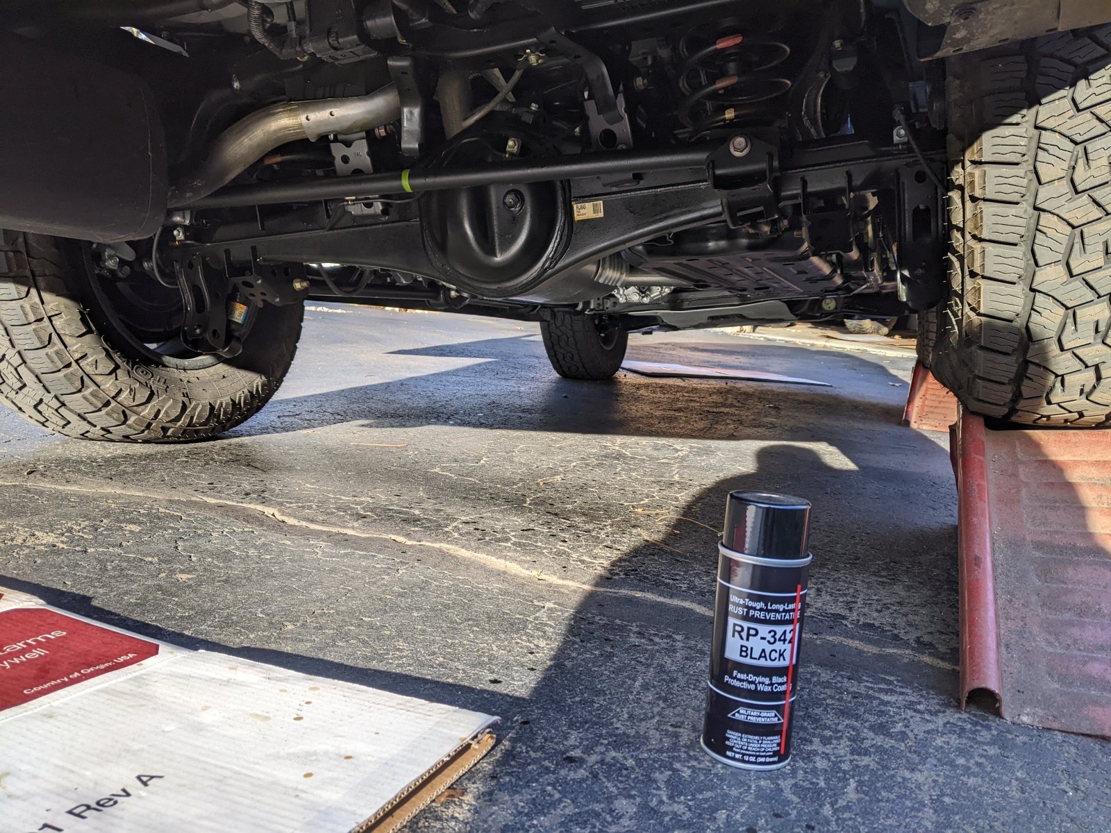

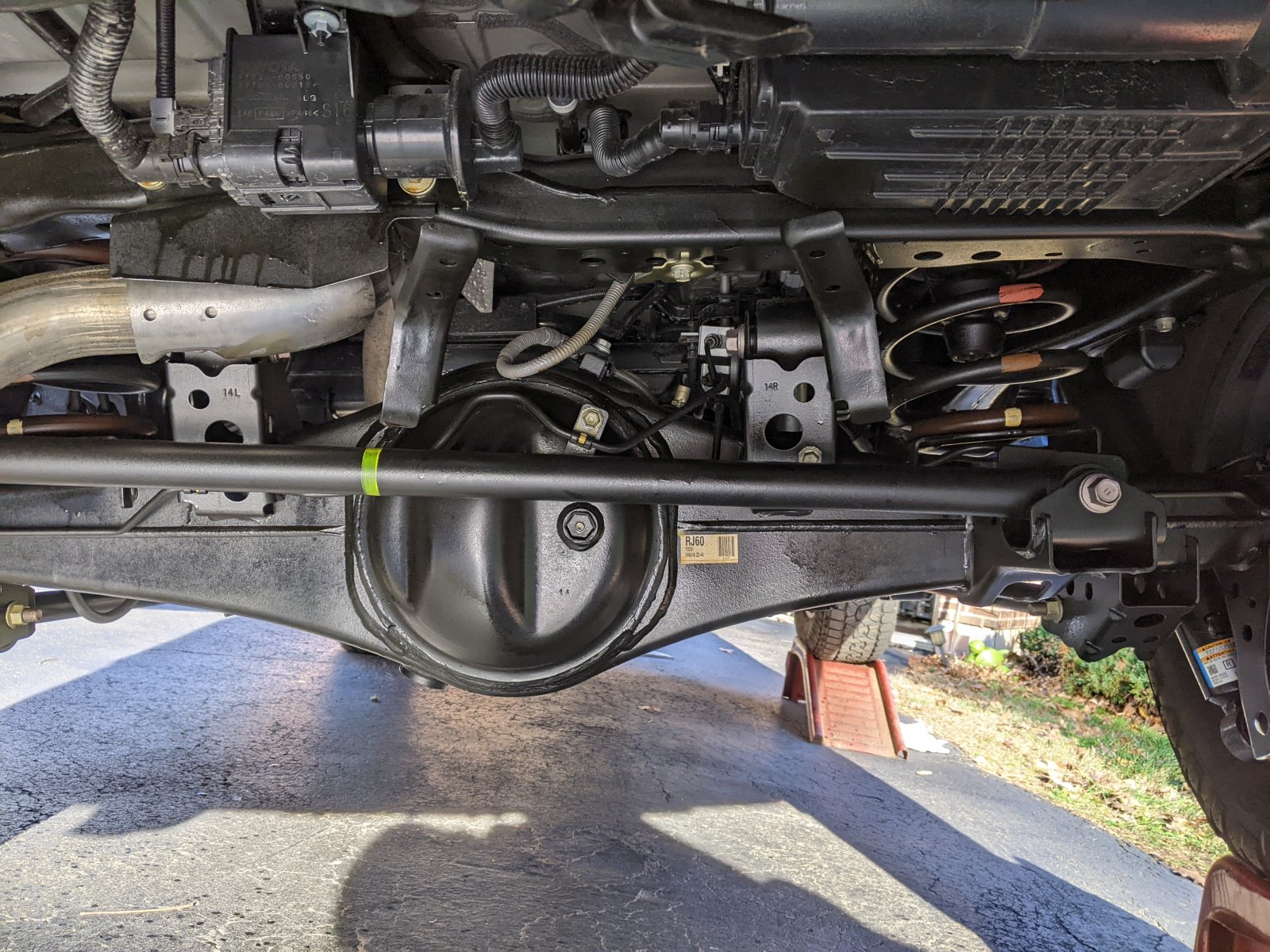

Not a fan of the heavy gunk as it creates a mess when you need to touch anything on the underside. I used a Cosmoline spray in clear and it's looks nice, protects for a few years and can be self applied with rattle cans. Cosmoline Direct is the company I ordered from. Safe on the wire connectors as well. They offer a black, but on a clean new surface the translucent is nice. Photo show black which I used on my older 80 series. There are a few other threads on the forum with this and others feedback as well.

I had lanolin based fluid film applied to my truck and trailer frame at the beach in Texas, but it did not last long. I have self-applied Cosmoline black, as in the post above. Unfortunately, on the GX I got a drop in the corner of my right eye, and now have permanent floaters. At least now I have a good excuse for missing all those pheasants this fall.
Sorry to hear, it is toxic stuff. I had a make on and glasses, but still need to be very aware. That said accidents happen. I'm sure a pheasant or two are indebted to you.
