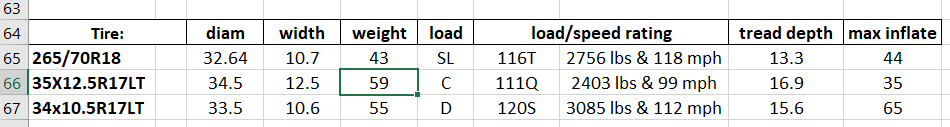

As a scientist, I too like to run the numbers and over-analyze everything.
My stock 2024 GX550 Overtrail tires were the standard 265/70/R18 Toyo Open Country AT3s with the SL load rating which are advertised as 43 lbs each on Toyo's website. The internet rumors are that Lexus had "special" AT3s made which seem to be weaker than normal AT3s so they may indeed be lighter in weight too. I can't confirm this and I've seen no data on weight. I should have weighed one when I had them sitting in my garage for almost a year.
My 35s are Toyo Open Country AT3s with a C load rating that come in at 59 lbs each. So 16 lbs heavier (and maybe a bit more if the special AT3s are indeed lighter).
Here is a portion of my tire comparison table for the AT3s:
Then we also have to consider the wheel weight. The stock Overtrail 18" wheel is 32.6 lbs based on internet feedback.
My Method 1703 17X8.5 +35mm offseet 6X5.5 bolt pattern are listed by Method at 27.84 lbs.
So I've saved 4.76 lbs per wheel. Net gain is about 11-12 lbs per corner.
The diameter difference is 1.9 inches which, as you noted, also figures into the equation. I calculated a 7.2% odometer difference after the larger tires which is about equal to your 10% torque reduction estimate.
All this aside, I can tell you from experience that going up to 35s did not make much of a noticeable difference at all.

Thanks bluegill
Per min 18 of C&D gx ot video the stock wheels and tires weigh 66lb compared to your setup at 86lb. The lightest 17 inch setup with reasonable cost is method 705s same offset as 703s . At 25lb they are 3 pounds lighter than 703. And Goodyear territory MT 35x315 17 at 52lb. The MTs now come in RT spec which are more street oriented due to thread design that mimics the ko2s resulting in much quieter road manners but the same weight savings

If that’s true then they really trimmed down the AT3 for the GX550 stock application. When you go to replace your stock tires, you’ll be adding on 4 lbs per corner. The estimate I saw for the stock wheel was 32.6 lbs (someone on this forum weighed one). Perhaps they were wrong. No matter either way, the truck has to carry it, I don’t. And the truck doesn’t seem to mind.

Same tires, on factories, and same results. No noticeable differences.

I've noticed that the retail SL Toyo AT3's are T rated (118 mph) whereas the Lexus OEM ones are H rated (130 mph). I haven;t seen a retail Toyo AT3 with an H rating on the Toyo website, but my OEM tires say it right on the side.
