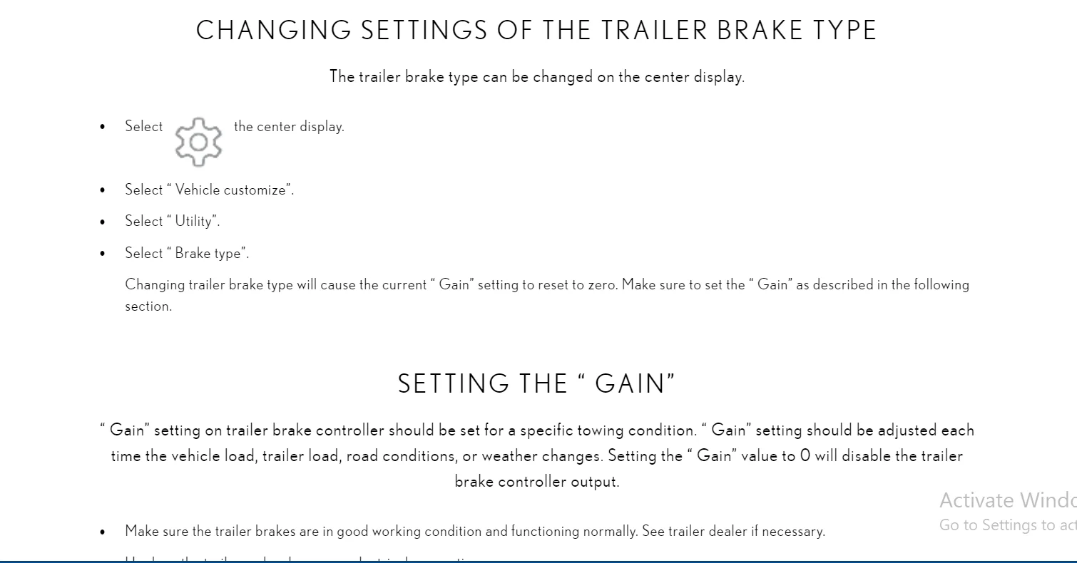

FWIW, we ran into this the first time we tried to pull our airstream. It seems that if it's under 4999# it doesn't want to use the controller. Set it to the next one 5000# and it'll work.
