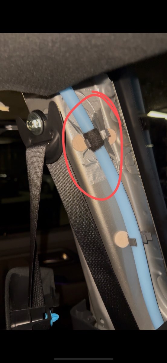

Back to the topic: The noise is coming from the upper water pipe bracket behind the passenger side C-Pillar. It may be broken, or possibly a quality control issue. The bracket is difficult to remove, so I placed a foam pad between it to prevent movement. When it moves, it creates a terrible metal-to-metal contact noise.
Now, the noise is pretty much gone, but I can still hear one or two clicking sounds when driving on poorly maintained roads since the foam pad is not a permanent solution.

Can you explain or circle where you put the foam?, Did you put it behind the tube, around the tube, or behind the brackets?

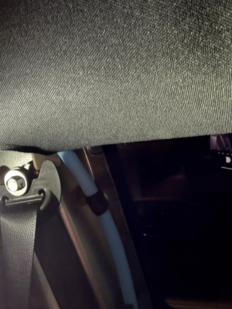

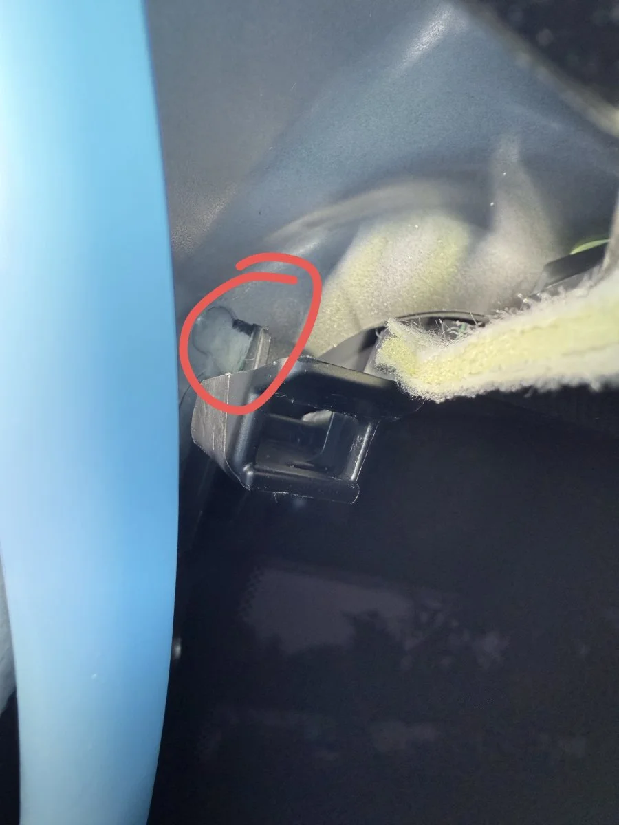

I put it behind the bracket to hold it from moving, and also dark tape.
