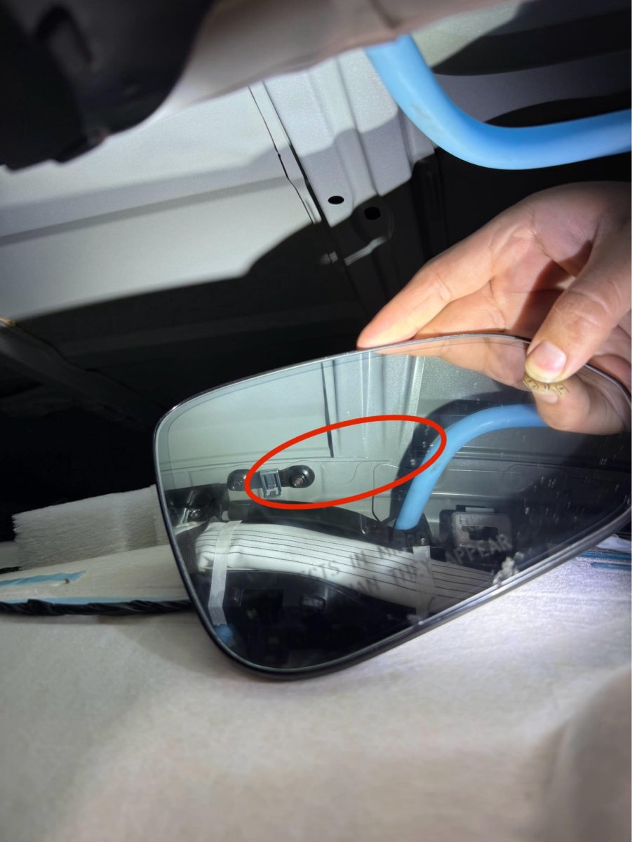

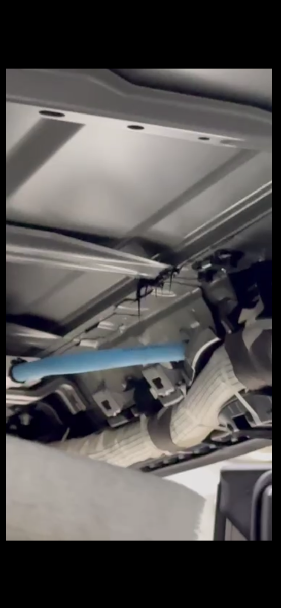

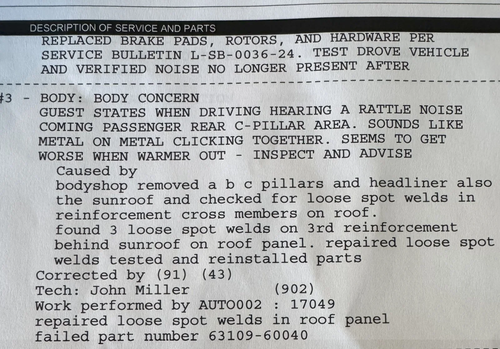

I just got my 24 GX PP back from being fixed a couple weeks ago for this same ticking noise. My dealership has fixed two GX's now including mine. I would think there would be a bulletin by now on this issue. The issue is spot welds that have come loose from the factory in the c-pillar where several pieces of metal come together. My dealership found 3 loose weld spots in my GX. They had to take head liner out to fix. I have heard some dealerships using using silicone instead by my dealership fixed the welds. Here are some pics taken by another that had a similar issue and fixed with some sort of silicone. Also included description of my work order. They fixed the issue. My GX is completely quiet now and I love it. That tick drove me crazy. Show your dealership this information. I also made a recording of the noise and shared with my dealership. lol
Forgot to mention this issue is heat related. My ticket only occurred when it was extremely cold or very warm. I would leave for work and not hear a thing, then drive home for lunch after it sat out in the sun and it would tick all the way home. I told dealership to keep it in the sun until they drive it. Luckily they heard it fine.
A sincerely huge “thank you” for this. Sounds exactly like what I’m experiencing. I will share this with my new service advisor. And, to your second comment, same here - FL doesn’t get cold per say, but on cooler days I wouldn’t notice it, but on scorching hot days (like today) it was very noticeable. Again, thank you. Will report back what is found…

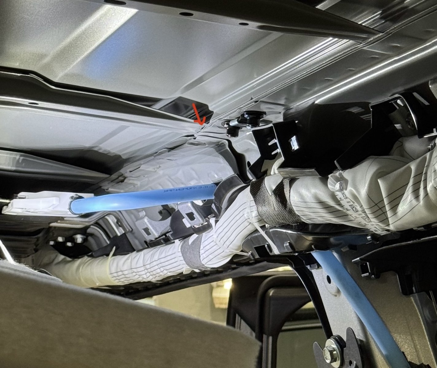

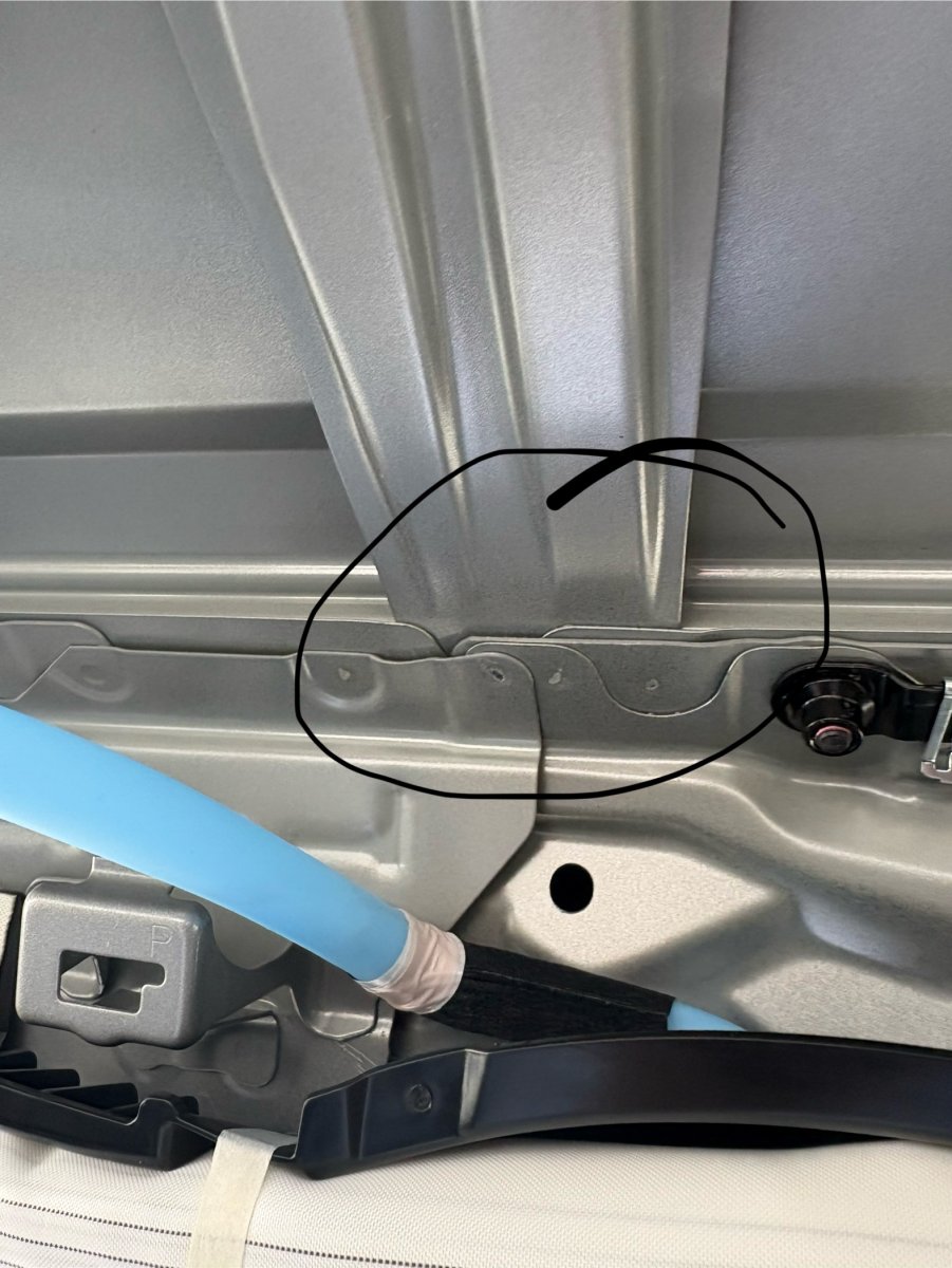

Its a bit concerning this is an issue at all. I don't know if this issue is only certain trims or only 2024s but is kind of a big issue with welds not holding. I made sure they heard it so they know. I also printed out these pictures and even took a recording. Tried to unload my recording here but its too large. I definitely enjoy my GX more now. :)
Here is another pic of the area I found on another thread.

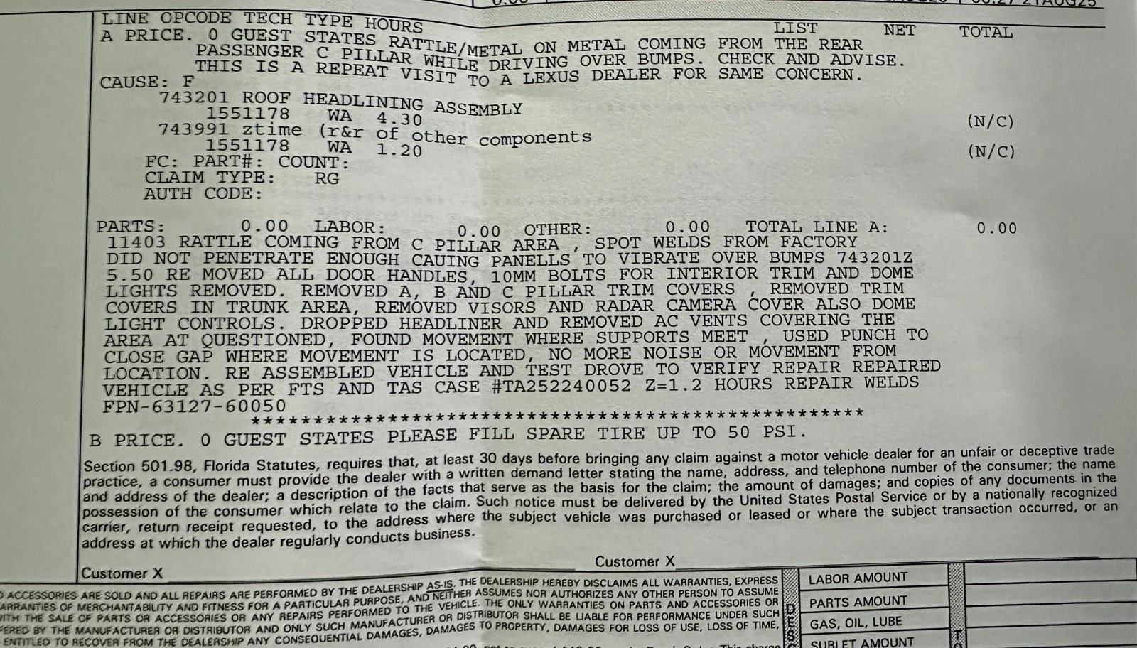

Update - I passed the intel from @NWorker to the Service Mgr when dropping off and within 2 hours I got a call saying the tech was able to identify the issue to be the same thing. Service Mgr said they had to contact Lexus (Corporate?) who provided guidance on what was needed to fix but it appears the fix is identical to what @NWorker provided. I asked them to proactively check the drivers side C Pillar to ensure no issues while they have the headliner dropped, which they seem happy to do.

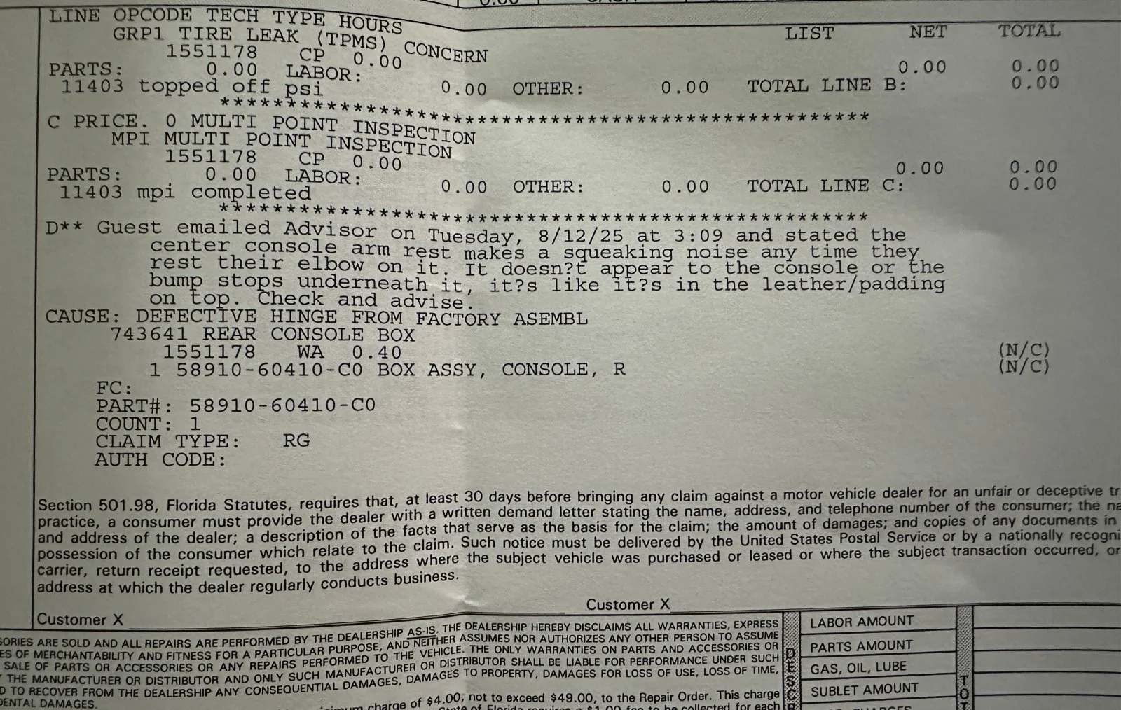

Fina update - picked it up today and the C Pillar noise was fixed. It was exactly what @NWorker mentioned. They also replaced the center console armrest and it no longer creaks! All covered under manufacturers warranty. Attaching the service notes for any others who might need.
