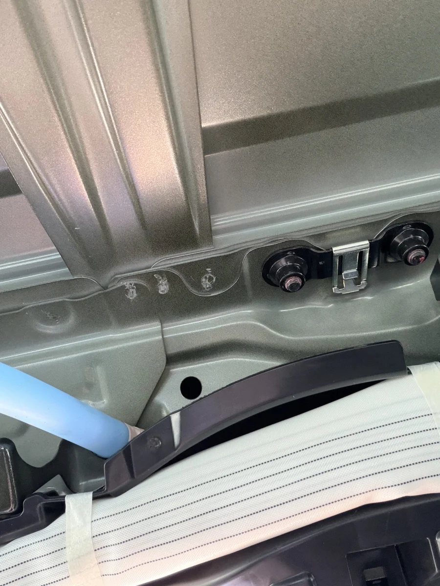

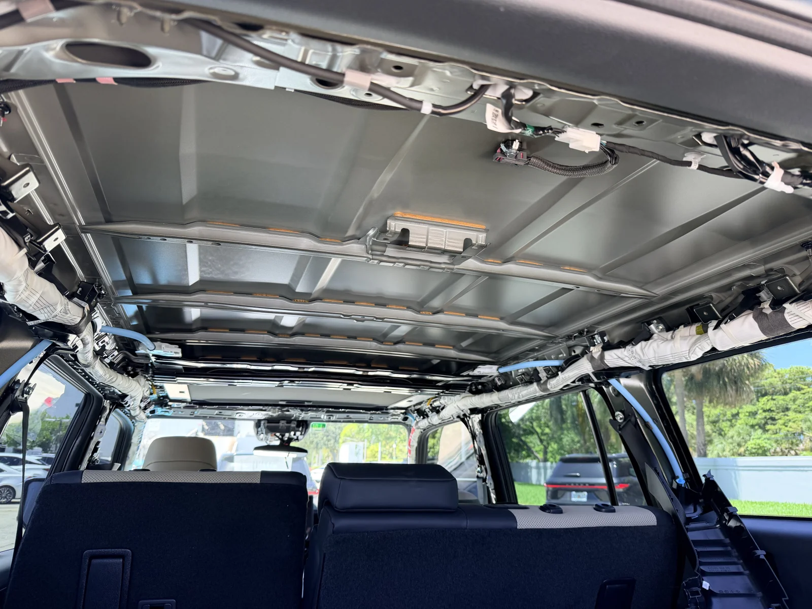

I just got my 24 GX PP back from being fixed a couple weeks ago for this same ticking noise. My dealership has fixed two GX's now including mine. I would think there would be a bulletin by now on this issue. The issue is spot welds that have come loose from the factory in the c-pillar where several pieces of metal come together. My dealership found 3 loose weld spots in my GX. They had to take head liner out to fix. I have heard some dealerships using using silicone instead by my dealership fixed the welds. Here are some pics taken by another that had a similar issue and fixed with some sort of silicone. Also included description of my work order. They fixed the issue. My GX is completely quiet now and I love it. That tick drove me crazy. Show your dealership this information. I also made a recording of the noise and shared with my dealership. lol

They finally found the culprit of the ticking noise. I had to get the service manager involved, and he was able to dive deeper with a technician and finally replicate the noise from the B-pillar. Annoying part about this was that I called Lexus to open a case and they told me to kick rocks; they can't do anything about it. I had to push the service manager to get something going. They, at the dealership, internally opened something with corporate/Japan (their explanation was that someone from Japan would advise on how to fix it). Finally got the call earlier this week and they found the spot welds in the b pillar was not at spec. So, this whole week, it has been at the body shop getting the spot welds re-welded. I will post technician notes and service notes when I get the car back.
