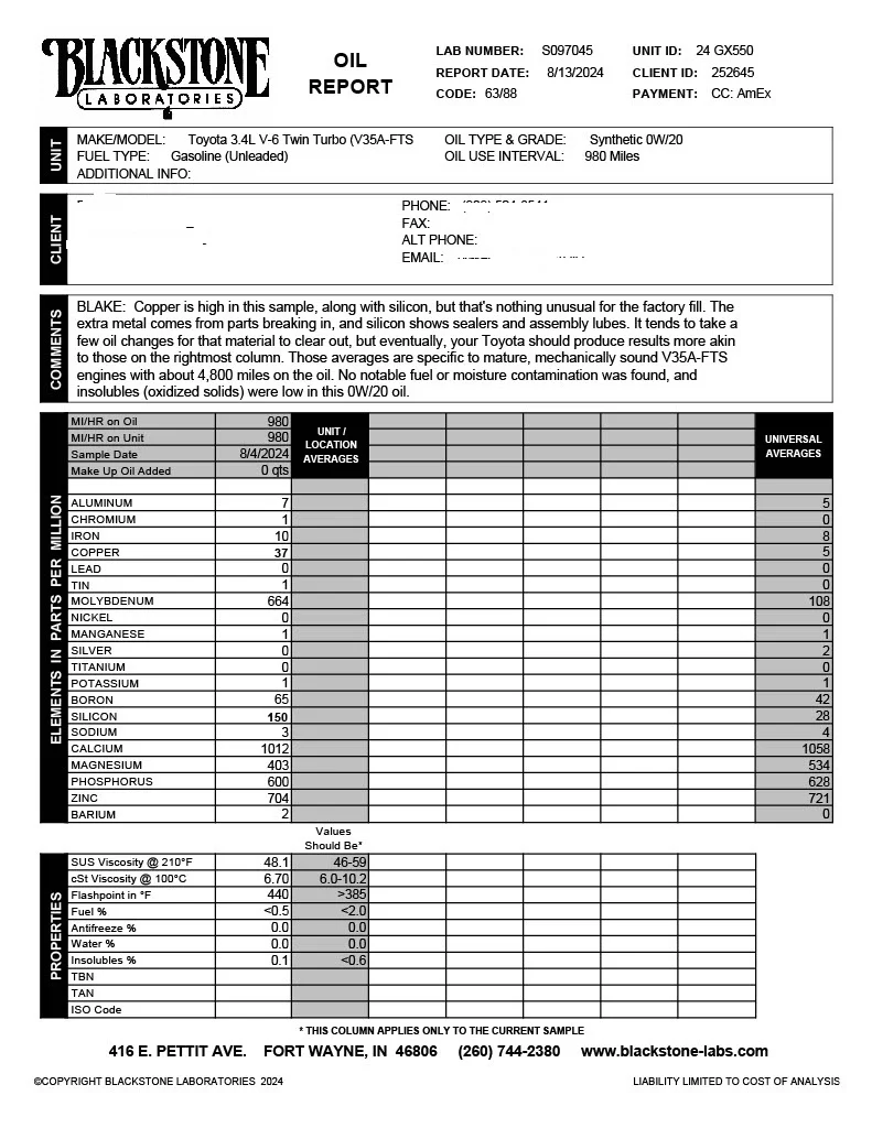

Blackstone sent my analysis after my first oil change at 960 miles. Copper ppm is high as expected due to the initial break in but otherwise looking ok.

Any concern with that moly #?
It’s been a minute since engineering school but moly steel is some of the highest grade hard shit you can get.
The kind that say a main bearing is made of?
Moly is often used as a lubricant between metal-to-metal surfaces and TGMO has a high molybdenum content.
Edited to add from Google:
Molybdenum disulfide (MoS2): Also known as Moly, this solid lubricant can withstand high temperatures and pressures. It works with zinc (ZDPP) to improve lubrication. When added to oil, Moly coats metal parts, reducing friction from metal-on-metal contact to Moly-on-Moly contact.

My numbers look very similar. Sent mine at 900 miles to Blackstone and yes, Moly came back HIGH. Maybe they include an additive in the initial oil fill during manufacturing? An interesting thing is that the engine calls for 7.7 quarts of oil and after filling with that amount, it was still at minimum level on dipstick. I poured the remaining oil to a total of 8 quarts, and it finally marked the middle of the dipstick...and yes, the engine was turned on after the oil change to allow oil to drain into the filter. By the way, the oil filter from Lexus service department is also smaller. Has anyone else encountered any of these findings?

Interesting that the molybdenum levels were high in your sample. While I assume that they are using the same oil from Lexus/Toyota, they may have used another oil which could explain the difference as moly is used in oils to reduce friction and increase fuel economy. You can get the same weight oil and effectively see higher moly content when purchasing the different versions with the same oil weight. I did not notice the extra oil capacity when changing the oil. What is the p/n of the oil filter that the dealer sold you?
