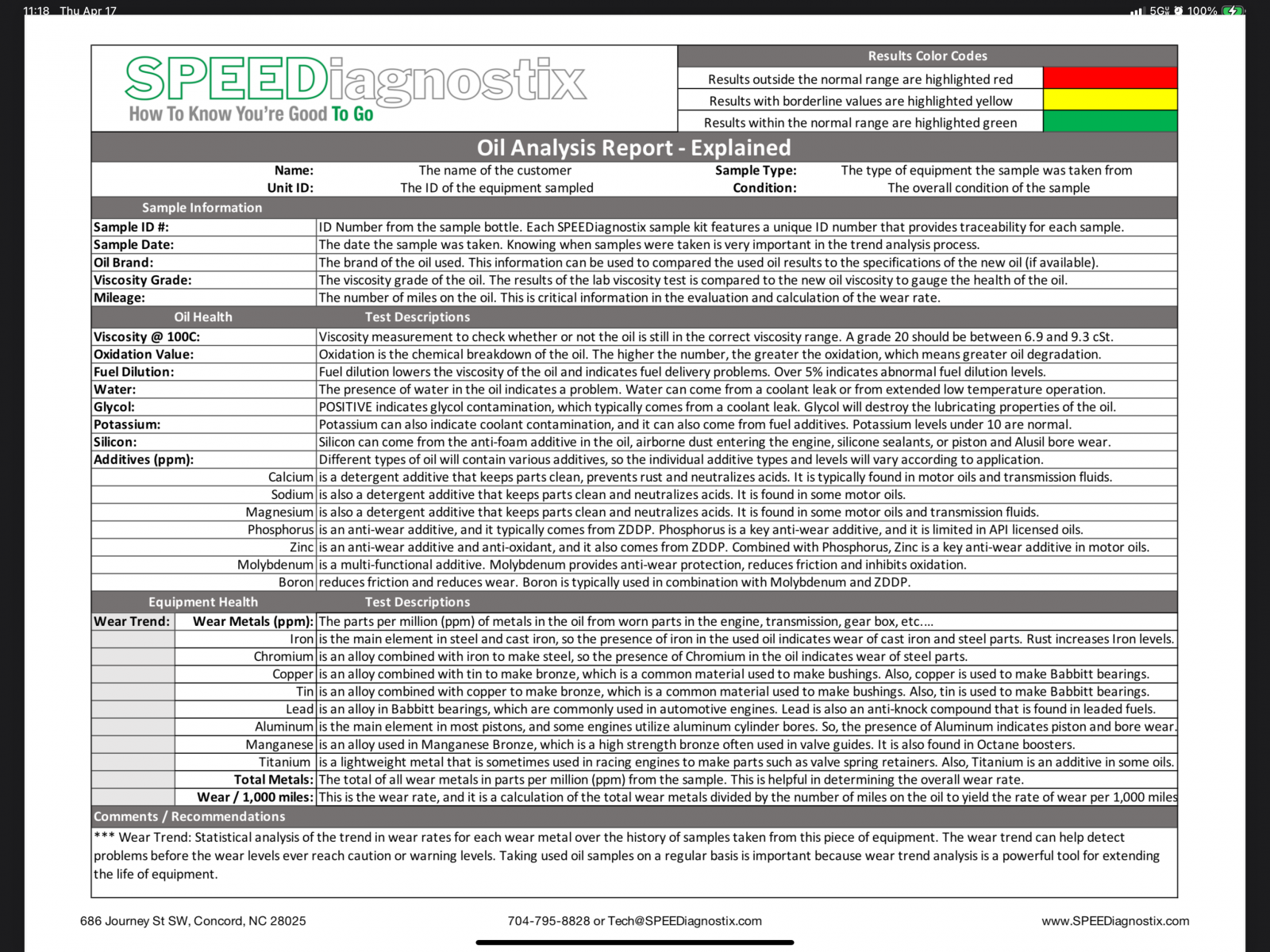

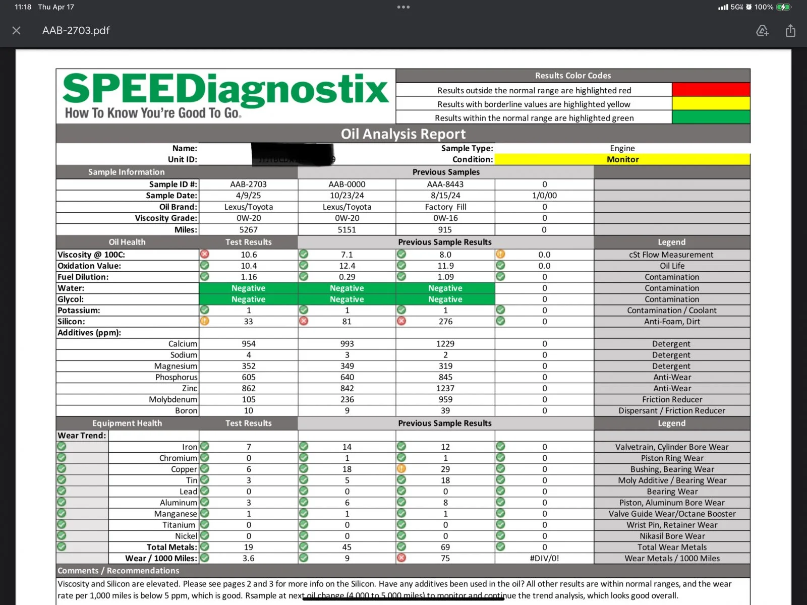

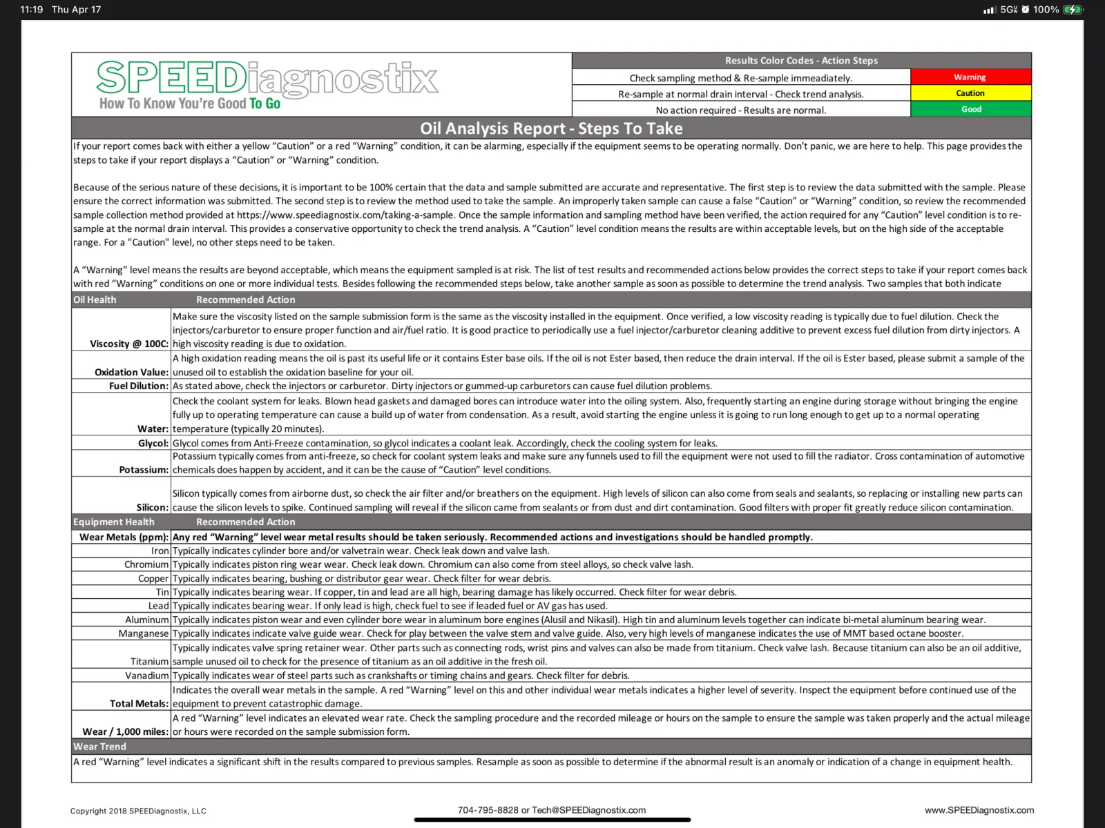

I did same. See attached. Tested at about 915, 6k, 17k. Did a change at about 11k but did not test. I will be changing every 5k miles but probably only test here and there after the next one. OT+

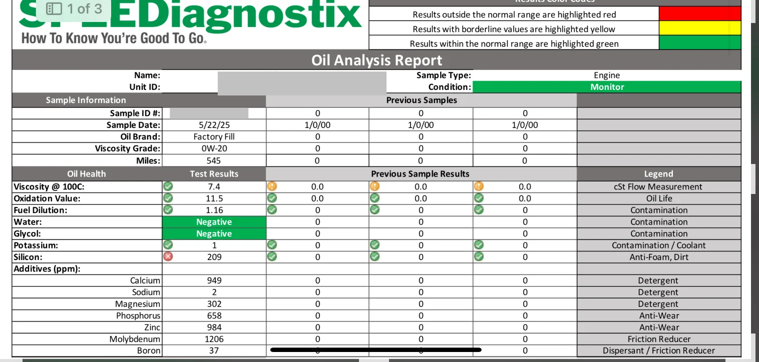

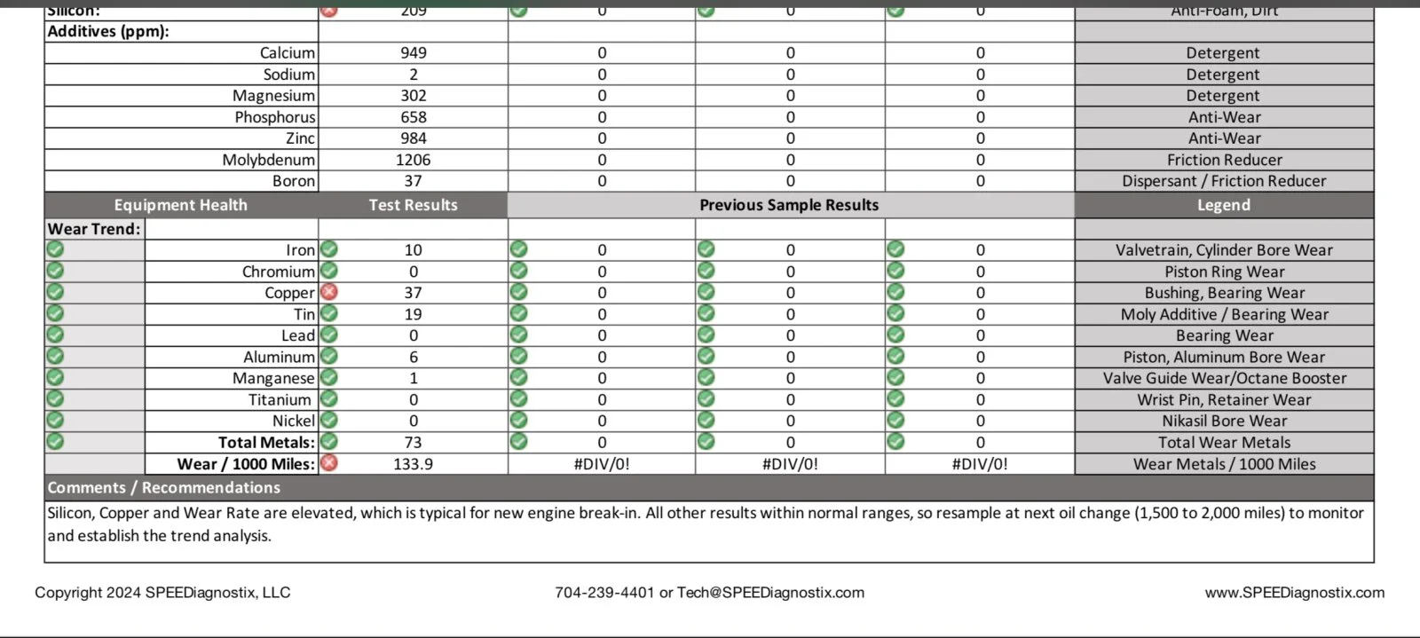

I just got my SpeeDiagnostix UOA back on my new 2025 GX550 after a 545 mile first oil change. I’m noticing the same thing in my analysis that I’m seeing elsewhere, including the sample above. The oils don’t look to be the same. What is the factory fill oil that Toyota is using? Because it’s not what they’re selling at the dealerships. Look at the moly levels in the factory fill and in the sample taken from new unused Toyota 0W-20 in the example, above.
