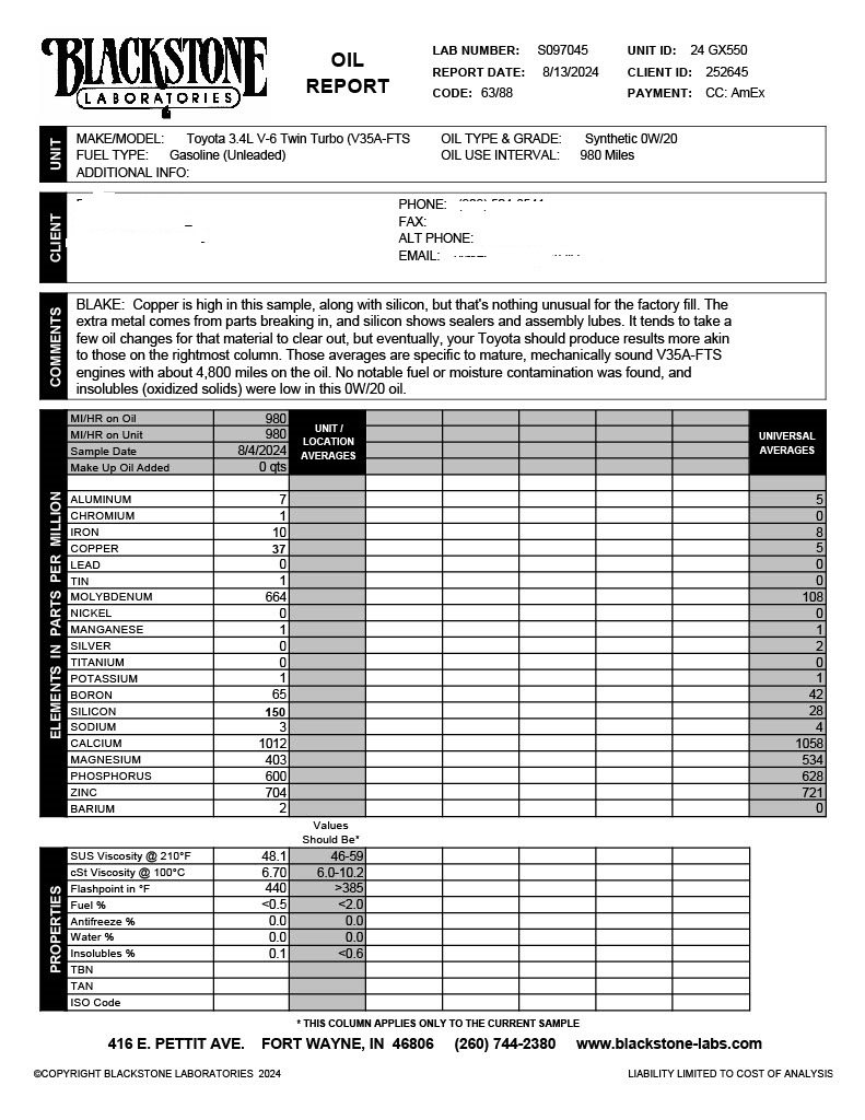

Blackstone sent my analysis. Copper was a higher ppm as expected due to the initial break in but otherwise nothing concerning.

This was pretty interesting information here. When do you intend to do your next oil change and do you intend to do at least one more analysis, Blake?

So my hope is, that'll be what we can determine if more owners perform an oil analysis. The larger the sample, the more we could determine what is 'normal' and the more we could all benefit. These oil analysis tests are relatively inexpensive.
There will be material in the used motor oil - this is expected in the break-in. The reason why so many people opt for an oil change around the 1k mark is because that is the time in which those materials will be present in the largest quantities in the used oil. Subsequent oil analyses at 5k, then 10k should see these impurities drop off substantially as the break-in wear between the engine components should have already occurred.
In the event owners who perform oil analyses see materials present in the used oil significantly above the norm, either early in the break-in or later over more extended use, I think, should give you some documented evidence of a problem. If one had to make a warranty claim, this might be useful information for the dealer to present to Lexus to ease the submittal of the claim.
But at the end of the day, I'm just curious about this subject and I can think of worse ways to spend $30. Lol.

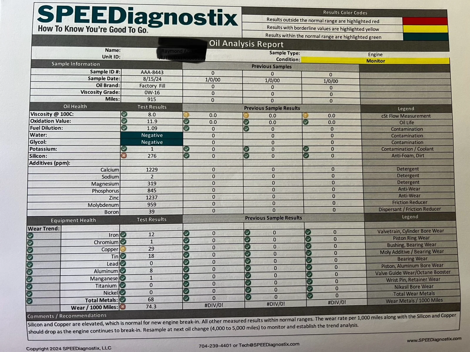

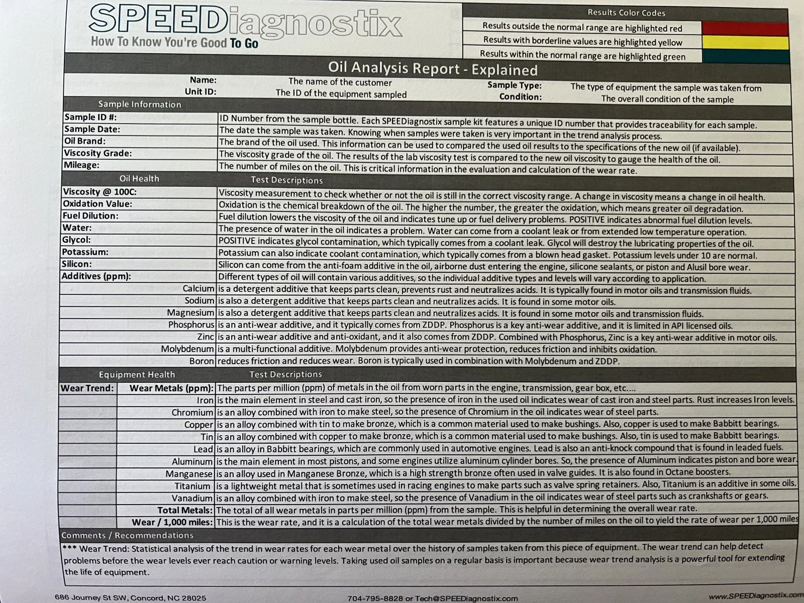

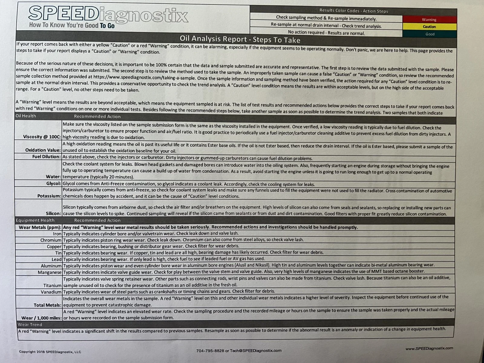

^ for your comparison. I’m gonna do my next analysis at 4000 miles and then at 9000. Probably will do every 10k after that for a while (every 2-3 changes) just out of curiosity.
