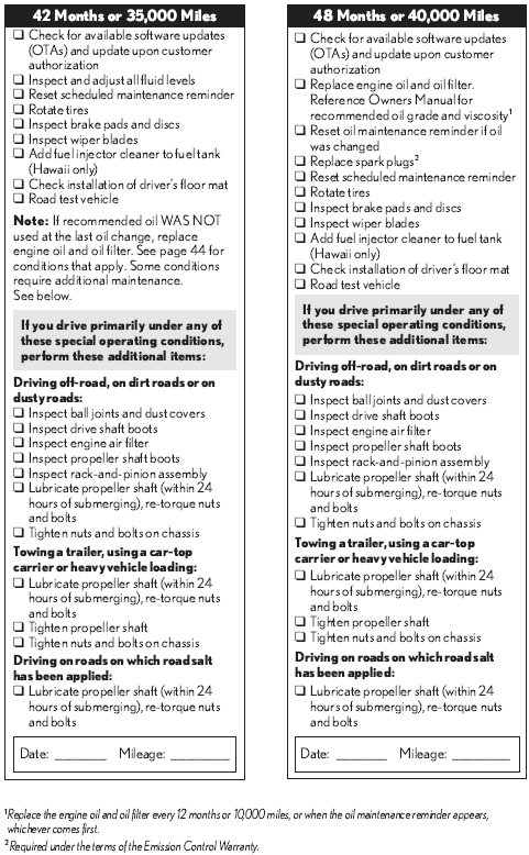

I found it on page 48 in the 2025 GX 550 Warranty and Services Guide. I'm all for a good laugh, but why is that funny? Page 50 indicates that the spark plugs are required to be replaced at 80,000 miles and page 52 indicates that they're required to be replaced at 120,000 miles.
you are contradicting yourself, your chart says 40k replace spark plugs but now you are saying per the manual at 80k
The manual indicates that the spark plugs are to be replaced at 40k, 80k and 120k. In other words, they're to be replaced every 40k miles.
